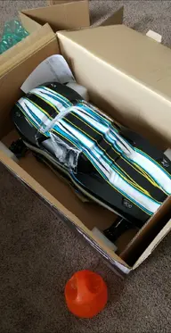

    I did this today Losi mtxl, figured I'd get a new toy. This thing is insanely large compared to my savage.

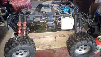

    KIMG0021.JPG My son and I finally got to run one of the Savages today. We had to richen the settings for the cool weather. I'm just tickled pink that it runs after sitting for a decade. Almost ran through a tank before the steering horn slipped. Now to dig through my parts to find a replacement.
    • Like Like x 1
  12. parks450
    parks450 Well-Known Member
    HPISF Supporter
    Joined:
    Nov 14, 2017
    Messages:
    190
    Likes Received:
    47
    What's going on with that fuel line? Lol. Let me know if you need a servo arm and what tooth it is I should have a few.

    He has more than likely ran the fuel line that way to help take care of the half tank lean issue that pleags the savage line of trucks.
    • Like Like x 1
  14. parks450
    HPISF Supporter
    Joined:
    Nov 14, 2017
    Messages:
    190
    Likes Received:
    47
    I wasn't aware running the line like that took care of it. I'm aware of the half tank issue, didn't realise that was a cure.
  15. polarman
    polarman Active Member
    Joined:
    Nov 21, 2017
    Messages:
    50
    Likes Received:
    10
    I did a mod in the tank itself to take care of the 1/2 lean issue way back in the day. The extreme length of the fuel line is for when you flip the truck over and you have to run a long way to put it back on it's wheels. Having a long fuel line helps to keep fuel going to the engine so it doesn't stall when it's upside down. Basically, it gives you a minute or more to get to the truck before it stalls, rather than a few seconds.

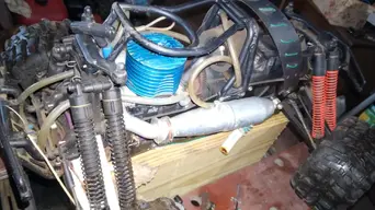

    And I have this among my parts. I saw on for sale on the web for $110.00!! I'm glad I stocked up on spare parts back in the day! KIMG0023.JPG

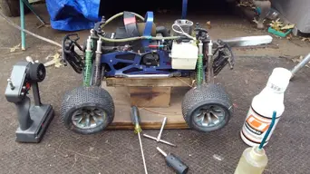

    KIMG0027.JPG KIMG0028.JPG KIMG0028.JPG KIMG0027.JPG My boy made me see if mine would run today. And it did! I wasn't sure that old XTM 24.7 had any life left. I have some tuning to do, but it runs! KIMG0027.JPG

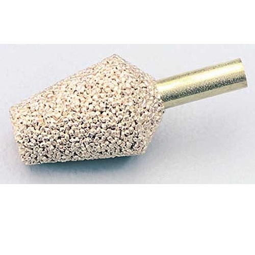

    Do you use a short clunk on it?

    Short clunk?
  30. 87stowe
    87stowe Member
    Joined:
    Feb 12, 2017
    Messages:
    22
    Likes Received:
    8
    [clunk]he is talking about those small sintered pickup filters[​IMG]
