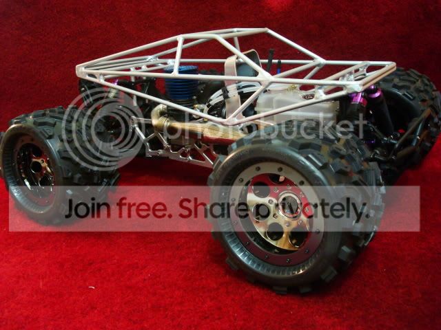

I check all the bolts every run. The RSC is scratched and some of the chassis but all surface.
I KNOW!!! my rear RSC uprights are no longer purple on the front side from so many stone chips etc... And the sides towards the rear of my tvps have developed a worse case of spots than a teenager!
I think in a few months once i have bashed the hell out of the truck, i will get all the metals anodized the same colour including the tvps. Will just freshen the look of the truck so it looks new again.

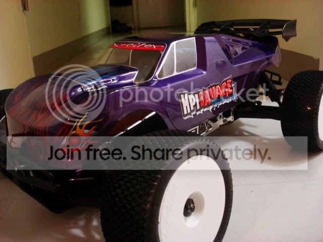

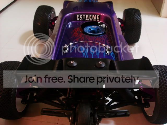

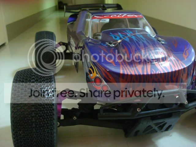

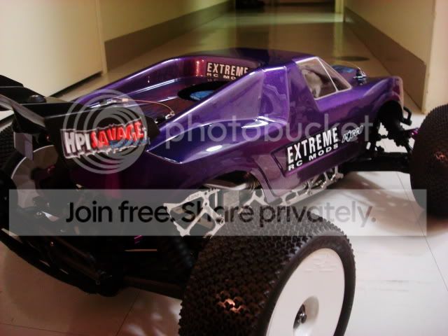

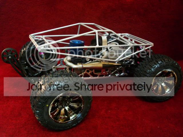

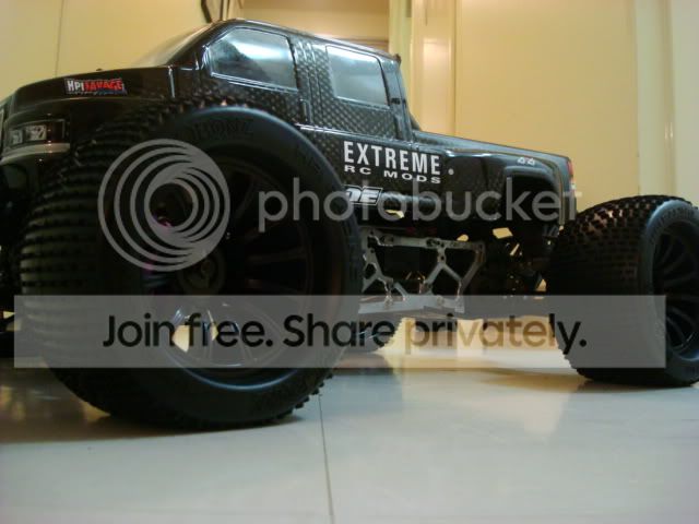

Here is my race setup. I installed the sway bar, GH Steering Bell Crank, Proline Calibers, Down Force Wing, and stickers and purple paint scheme to make me go faster. :lmao4: For the racers, I did track runs today and I did 48-54 sec lap times. Yes I suck, at least I did not come in last against truggies. LOL
You never cease to amaze me!!! Your truck is like a transformer, from model truck to racer haha....
I was considering getting some LPR rims for my truck but it would just look so wierd considering the length of mine. Plus i don't race so there is no point. Maybe when i have some spare cash, but Centre diff and steering is my priority...
Which brings me onto my next question regarding yoru GH steering assembly....
How is it?
How is fitment?
Does it allow full throw of the RSC without modding unlike the stock steering assembly? (i had probs getting mine to turn right completly so i shaved some parts off the steering system and the plastic bar connecting the steering posts ripped in half!)

The GH steering is great, no modifications. Purchase and install it, trust me it is easy and the turning is smoother and faster. I recommend getting sway bars to keep you from flipping to much. I did not take any pictures so sorry. Your turning radius is dictated by the amount of trimming you do on the knuckles. If you do not trim the aluminum nuckles (rsc) the stock plastics have better turning radius. You do not want to trim to much without using CVD's, because your dog bones will fall out. 1. it is hard to locate on a track or field 2. They are pricey.

I got my diffs set up where it doesn't unload to shred the tires. You have to set your end point on the brake so where you can still push the truck manually when fully applied. If not you will end up on your body or destroying your tire threads.

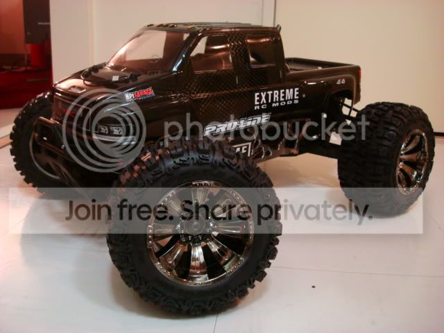

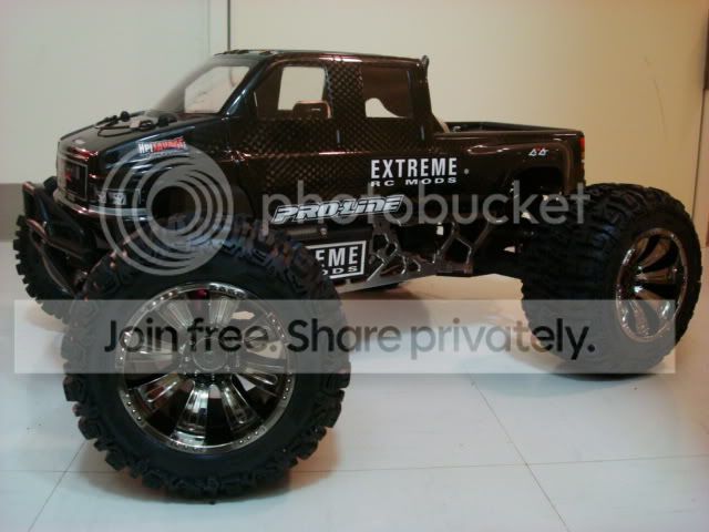

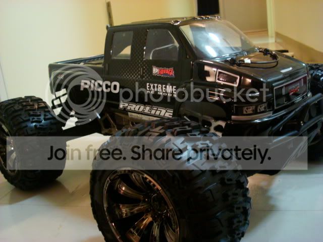

Here is the TopKick
The Topkick Body with the ext FLM chassis is a tight fit. If you are looking to purchasing this body and have a shorter length than that of the ext FLM chassis, you will have to cut the body's front and rear bumpers. This paint scheme depending the angle can make the truck look all black.
