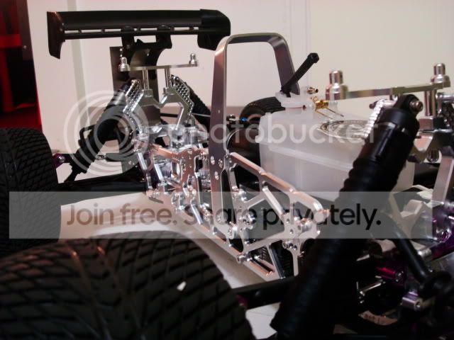

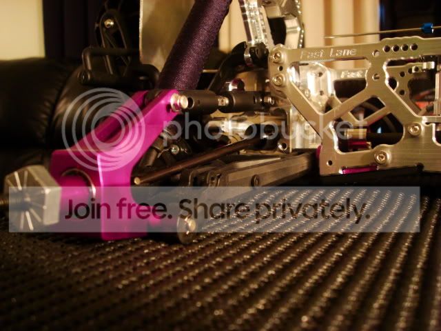

Upgrading and Matching screws
I used the owners manual to reference the size and length. IE M ___ x ___ MM. I know who may ask me about the weight difference.:bigsmilie: So no i did not do the weighting of stock to upgraded. The weight I posted earlier were with the new screws.

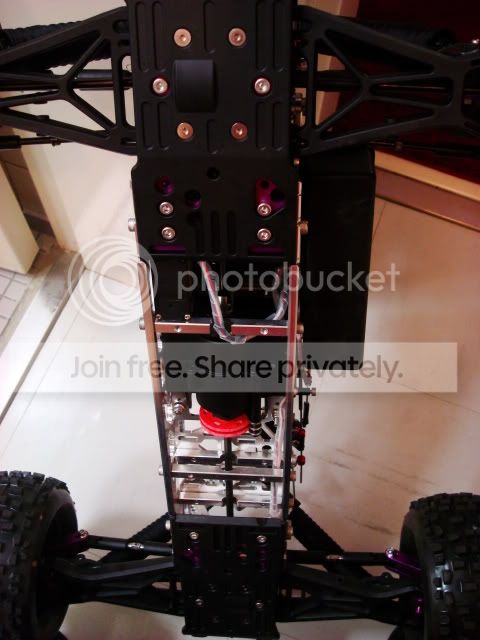

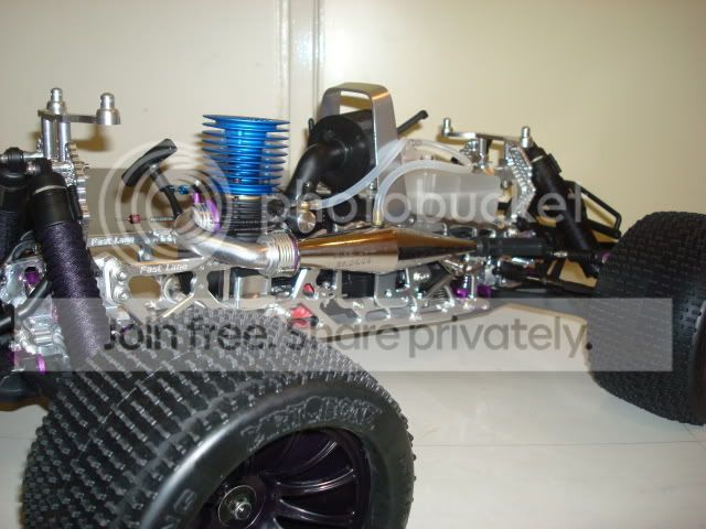

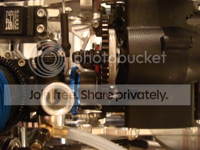

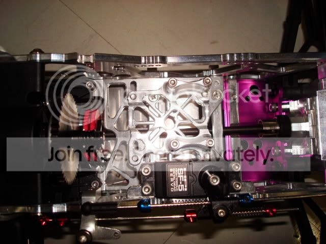

Picco and pipe mounted

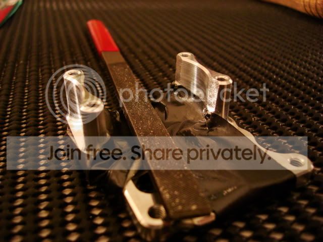

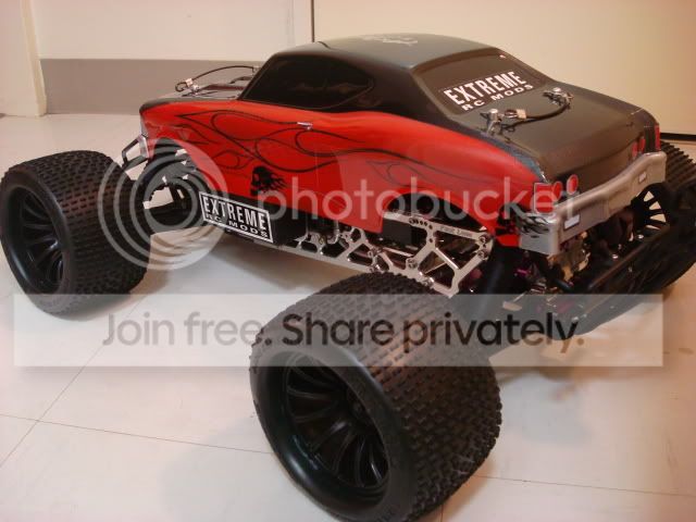

Got to finish a MT body. I will post it when I swap out most of the FLM (heavy) with stock (light). In order for the Picco to fit on the FLM motor mount I had to file the inner part of the mount so it fits without binding.
I am a clean freak and probably it will not be as clean but near to it.
I'm the same way man, I don't clean it every time, but every few runs I completely detail it out LOL. Looks like it just came out of the box. WD-40 works wonders on the plastic parts, gives them that new shine again.
