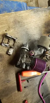

Well, was going to install a 16T bell to drop down from 17/47 to 16/47, also to throw some ARO in it and clean it up since I only ran it once this year that I remember. While cleaning it, the engine mount broke/fell apart in my hands.
Guess that will teach me to do any nitro maintenance. LOL!
