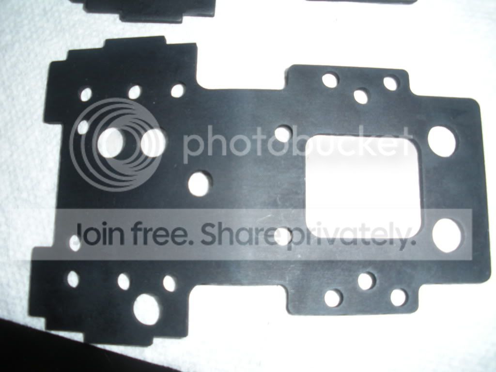

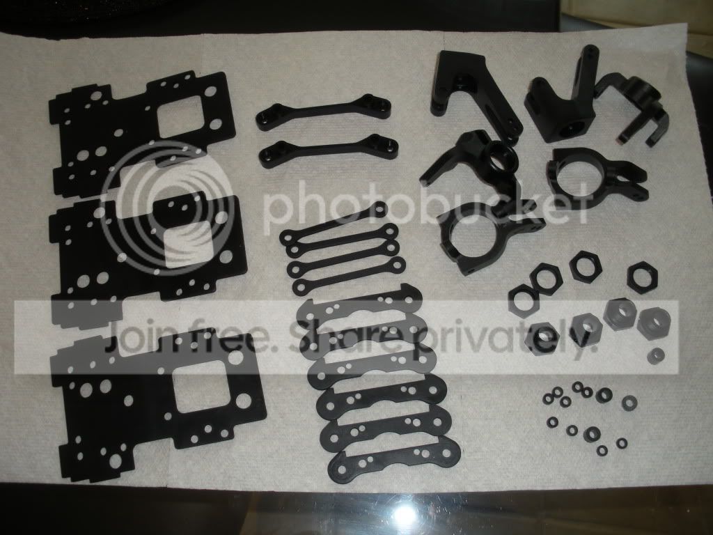

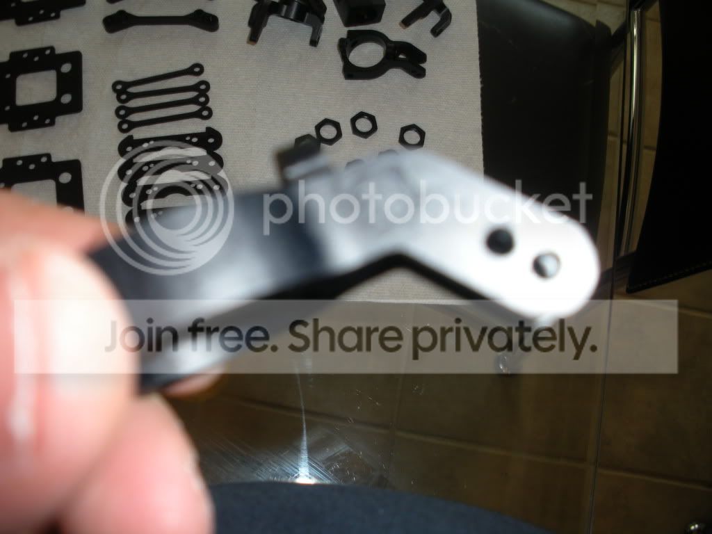

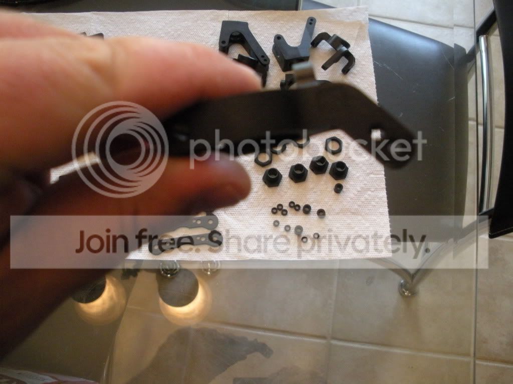

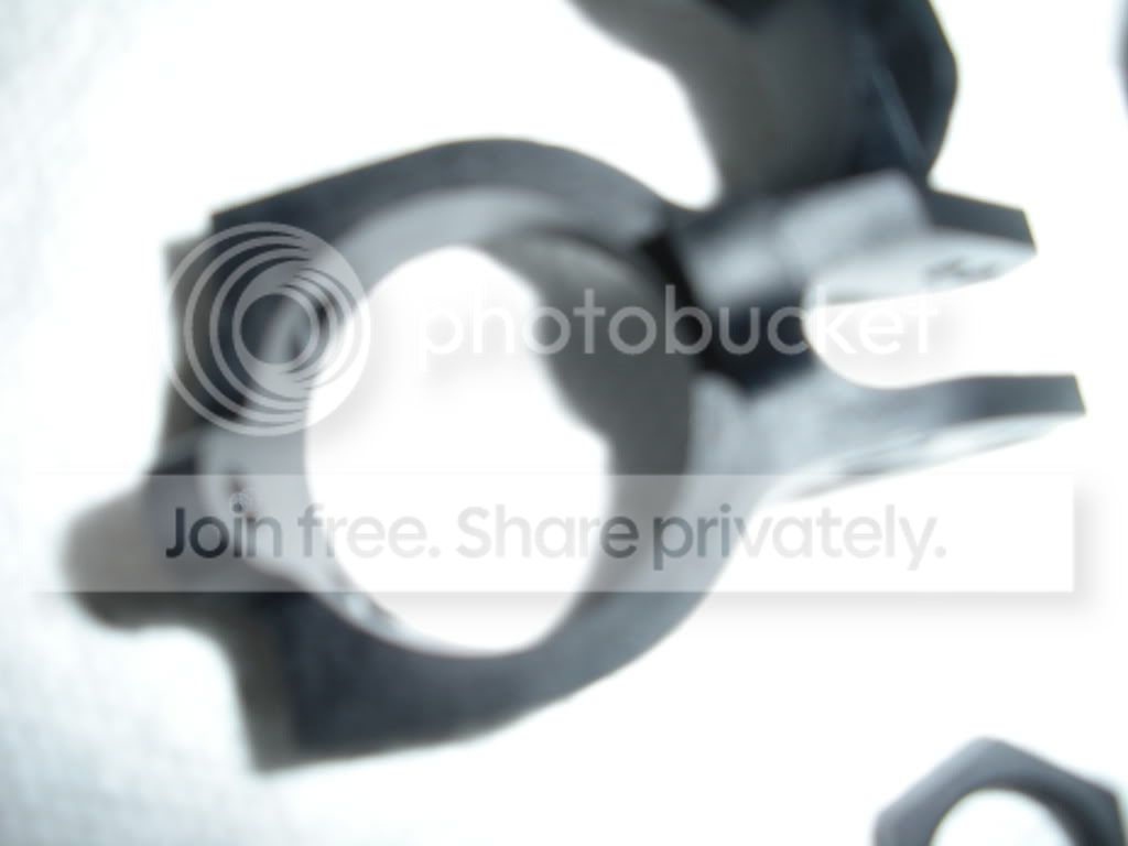

D-day has arrived! Most of the parts look really good. Some of them do look a little rough...literally. Also a few spots I could see the red anodize that didnt get changed to black.
Overall aside from the wait time I AM happy. Would I consider the parts to look o.e.m.? NO. But I aint building a shelf queen so I am pretty sure this is gonna look sick on the bmx track or the street or yard or wherever. If you must have perfection then look elsewhere. But for the $ and a basher I say go for it! They have a flat black finish. Also not sure but I did have some new parts mixed in that hadnt been installed that seemed (may just be imagination) to turn out a little better. ie the 17 mm hubs. I got a few of the stock parts done that I wont be using...so if anyone would like me to mail them one to inspect I will gladly do so.
