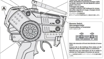

I believe this is the remote you have, if it's stock, have you checked if the throttle is reversed?
I did check this I also checked the motor wires which are marked abc it's been along time since I used it from the last time I remember using it I installed a new receiver box for the Ariel etc could this be the cause of the problem by any chance thank for the reply mate
Did you actually flip the switch to the opposite direction and check if it helped? Sometimes "reverse" on the switch ends up being normal for driving due to other things, like the Receiver and ESC.
