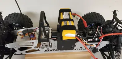

Having them up like that kind of kills the LCG the TVP's give you. Probably better off at least making it wider from front to back so you don't have to stack them. Will lower the COG a bit.
Looks nice though. Did you make the TVP's? Alza center kit or did you make that too?
Those are not the batteries I will be using with this truck, the only ones I had at the moment. I just ordered some hard case batteries, 6s and 8s single battery. LCG is pretty good the weight on the truck is perfectly balanced, I am also using rear Baja wheels so the truck is extra wide.
The TVP's are custom and had them made a long time ago when the truck was gas, came with the rear drive shaft since its custom. The center is Alza and wish I had made this change years ago, so much better tahn the stock tranny.

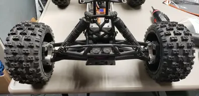

Used a custom lower arm hinge pin braces (+13mm offset) and Tekno Truggy universal driveshafts:
