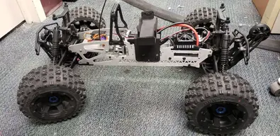

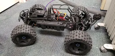

My opinion would be get this tranny to convert to electric: Alza Transmission
I have both savages and it was cheaper with the Alza transmission, look at the pictures I made my own battery mounts. 20210208_121555 (Large).jpg 20210208_121610 (Large).jpg

To be honest I think the kit would be the cheapest way to upgrade the truck to electric, I didn't know you can still get these.
It give you the battery boxes, chassis plates and the tranny that you would need to do to get it to electric.
If you don't want to go that route you will need to use the ALZA transmission since it takes care of the tranny and motor mount, with this setup you can use pretty much any motor and spur combination but the tranny kit is not complete when you purchase this. You will need a diff for the tranny which does not come with it and you will still need to create a battery mount.
so you will need to decide if you would like to spend $200 for the kit or about $150 for the ALZA kit and make your own battery trays.
