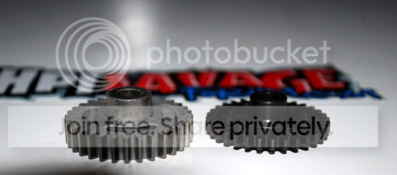

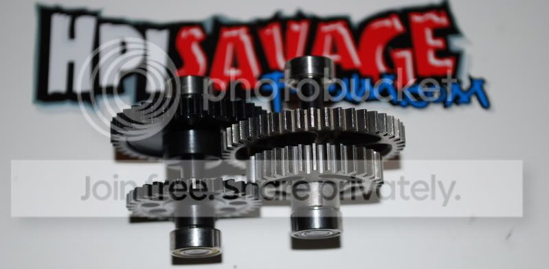

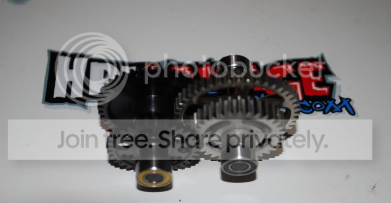

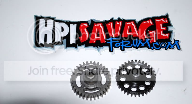

Here is the tranny rebuild
Boca Bearings and lightweight/machined HD tranny gears
part #'s
HPI86275 hpi light weight idler gear 29T
HPI86274 hpi light weight drive gear 32T
HPI102514 hpi HD drive gear 18-23 tooth
i have the 39t but didnt add it because it is equivalent to increasing your pinion by 9 teeth O.O. At some point i will gear down my pinion/spur and add the 39t because it is a machined gear.

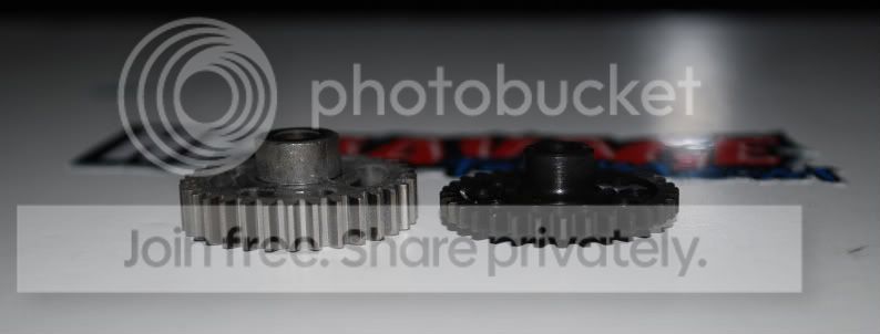

So i decided to dump the 44t idler and put in the machined 39t. Yes, I'm aware that doing this is equivalent to increasing your pinion by 9 teeth so i also ordered a 45t & a 15 & 16t.
Here are the differences between the stock and the HD - hopefully it will be the last set that my flux eats:
boca
looks good fred the bocas rock I'm amazed at how smooth they are.got a email the other day they have come out with a new type of bearing,not sure on the prices yet?
thanks for the kind words d.d.
i'll have to hit up their site and check it out. are the new bearings maintenance free like these?
