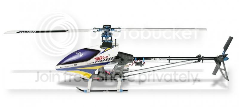

and i thought you already have ur Flux build finished.. cool :10:
i've 4 channel cheapo fix pitch heli, honeybee (not co-axial one) and its fun flying it once i know how to handle .. ppl said once you've addicted to heli, you will only go bigger.. let us know when you're getting it.. or you already got one? :rock:
So let me get this right Frddy - Hijacked his own thread ( brushless build ).
