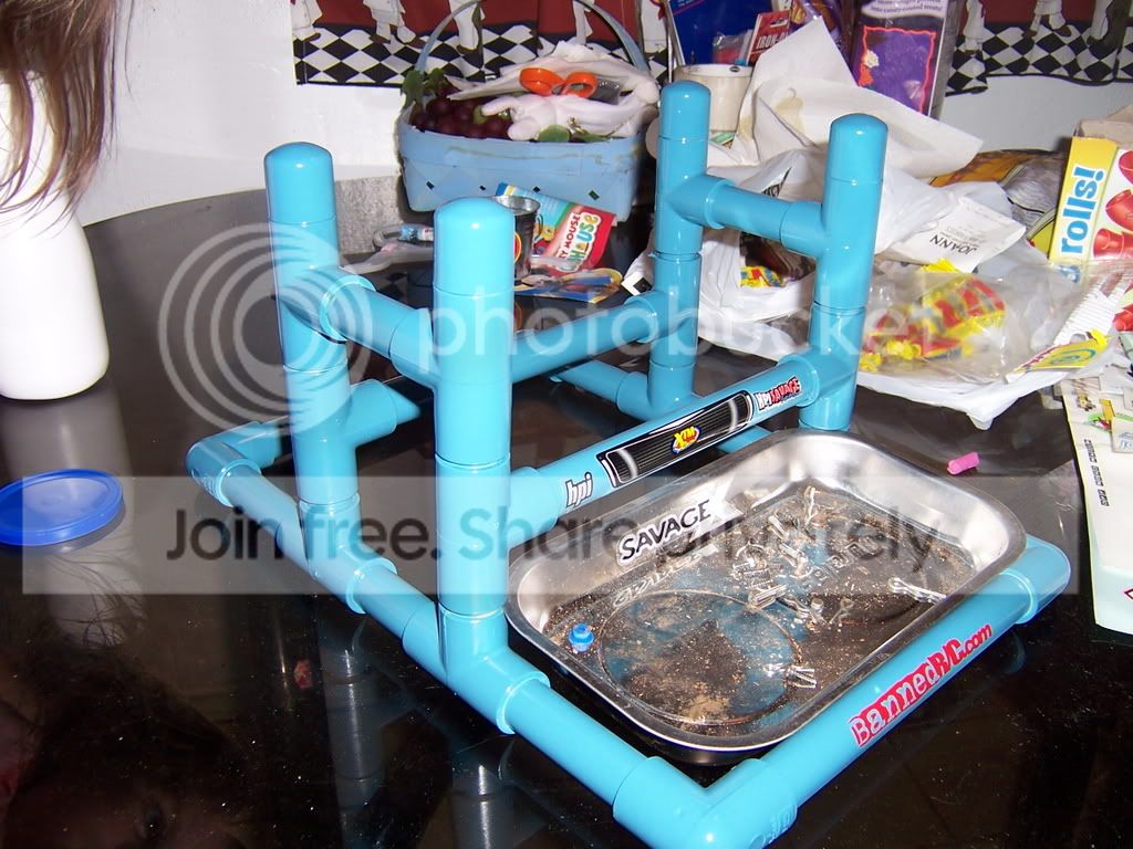

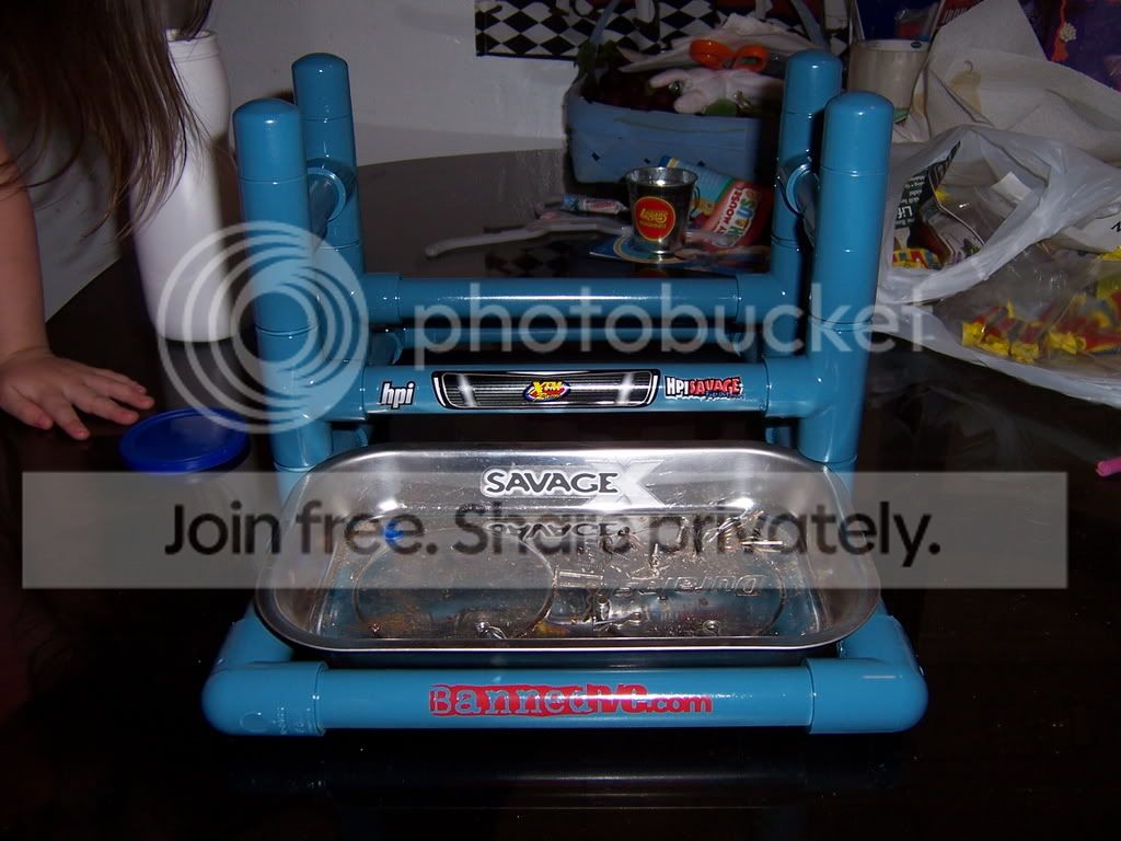

Here's pictures of the finished stand.
Whipnet: It's funny that you put a link to that in your post. I'm using the round one with my stand since I already had one.
This was a great project posted by YeahYeah. Works great!
Take note though of what xsavage3148 said about making it a little bit wider for FLM's and aftermarkets.

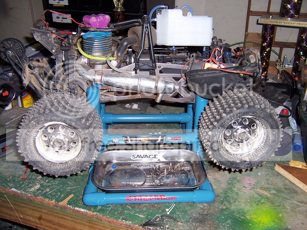

You can even lift and carry around the stand, they fit snug.
(Never mind the Savy, its under the knife.)

please tell me you actually use that pump jack for the savvy
You know it!! :)
It's really just for show/fun, but I actually have used it sometimes to keep my crawler jacked up so it doesn't flat spot the tires. :jamout:
