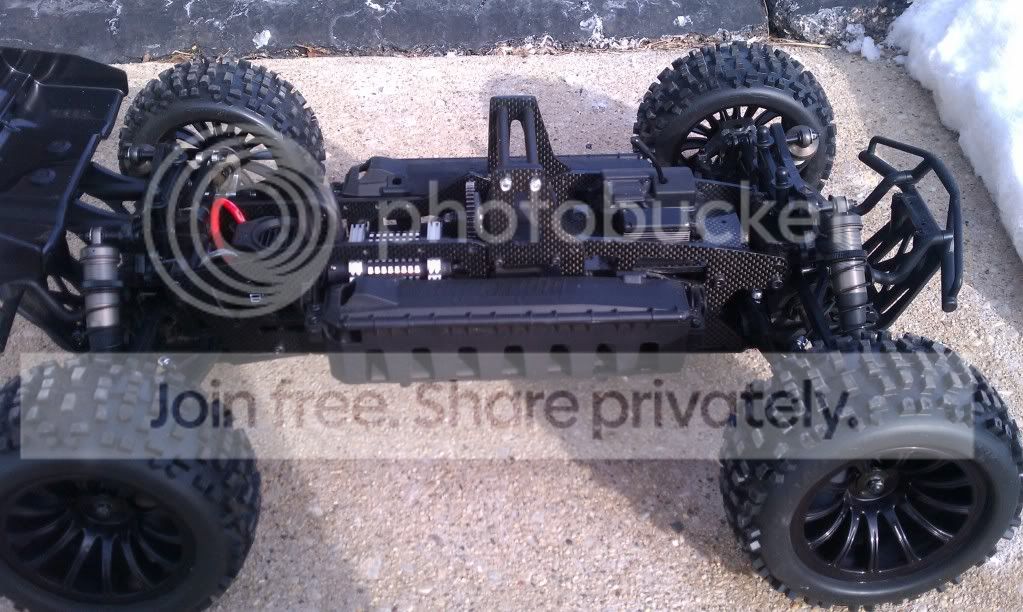

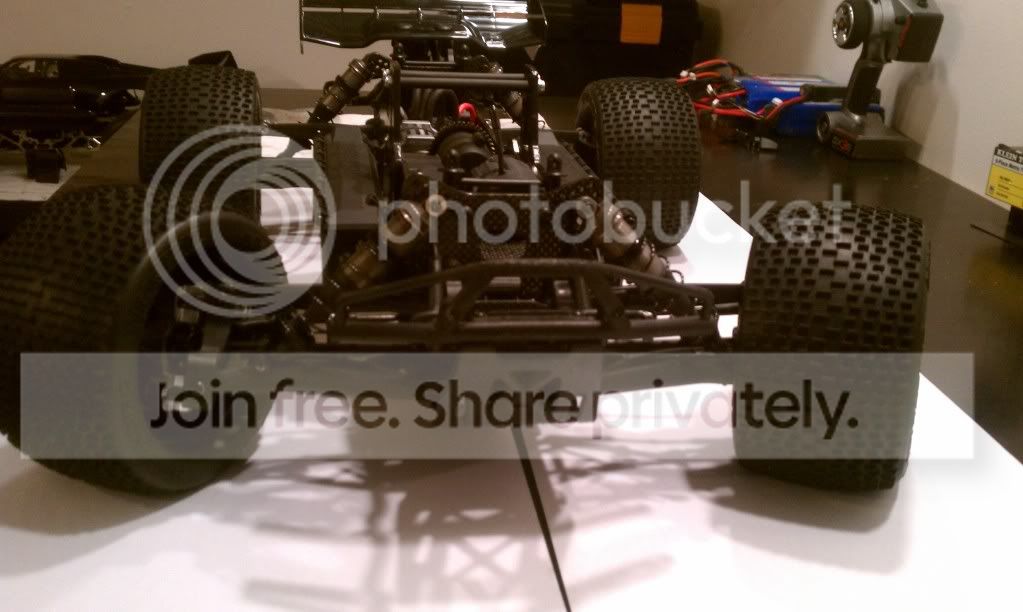

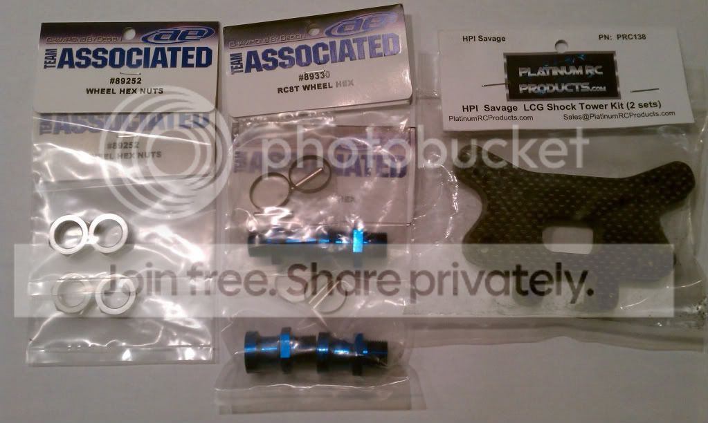

Got a Few thins in the mail today. Prc lcg towers, hellfire body mounts, and the rc8t extended hexes and nuts.

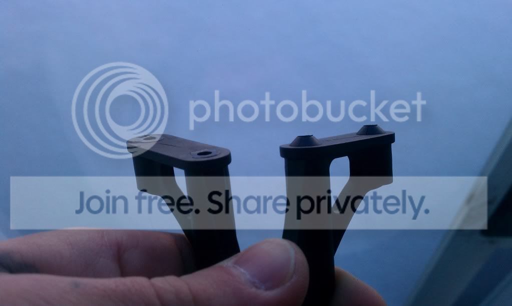

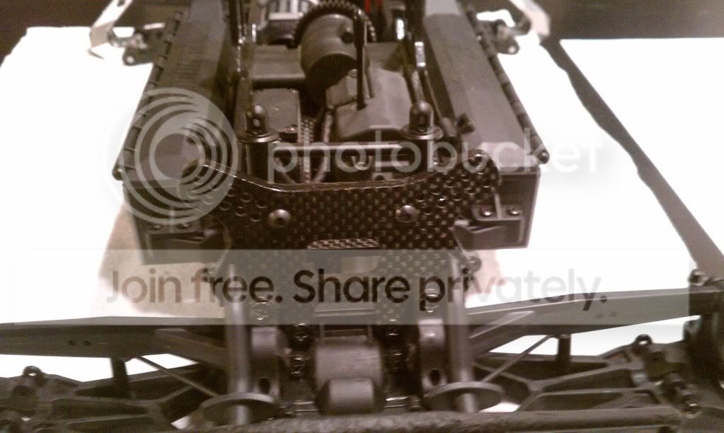

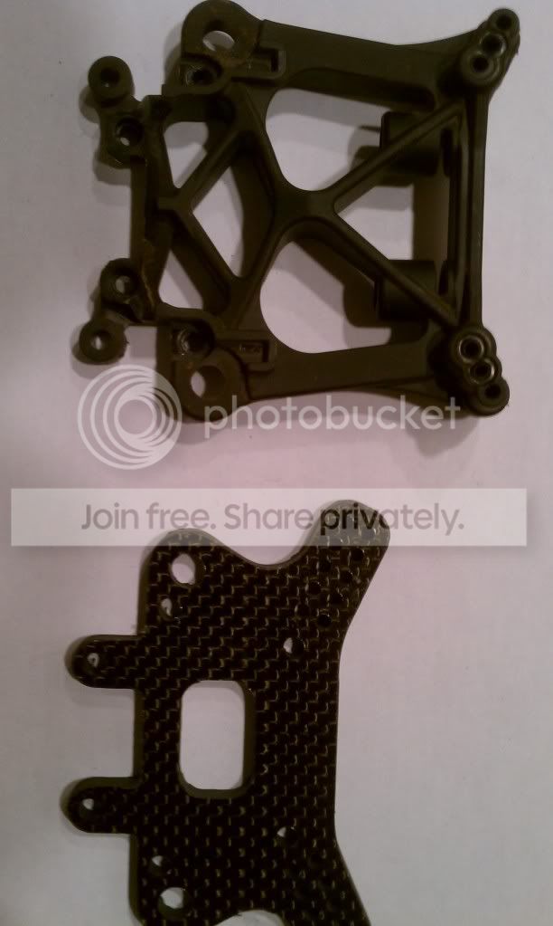

Size comparison of the stock towers and the prc lcg towers. Plenty of shock mounting options with the prc.

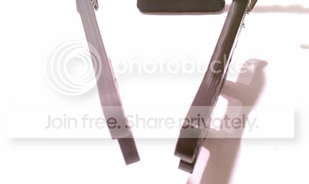

Sealed up the edges of the towers with some zap a gap.

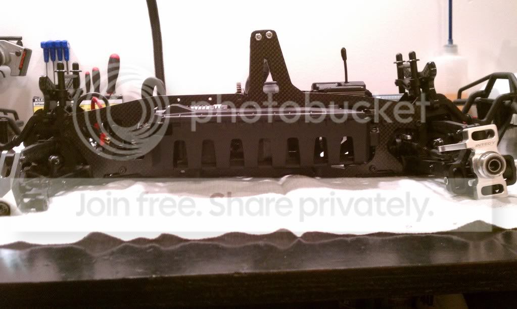

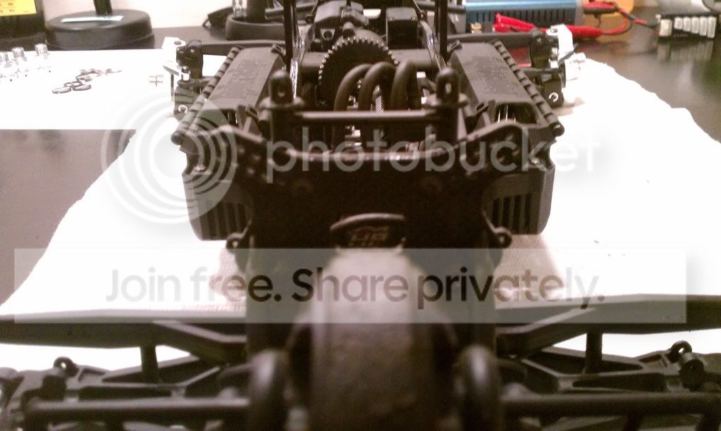

Got everything together so far.
Tomorrow I should be getting my d8t shocks and springs. Also should be getting my new body, wing, and hellfire wing mount.

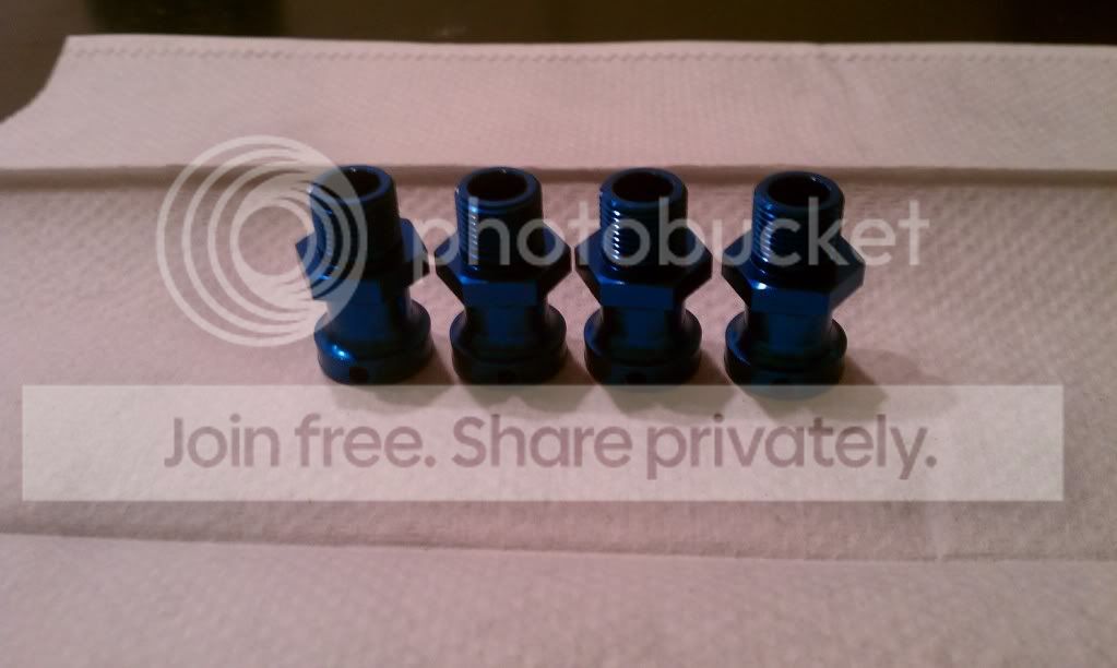

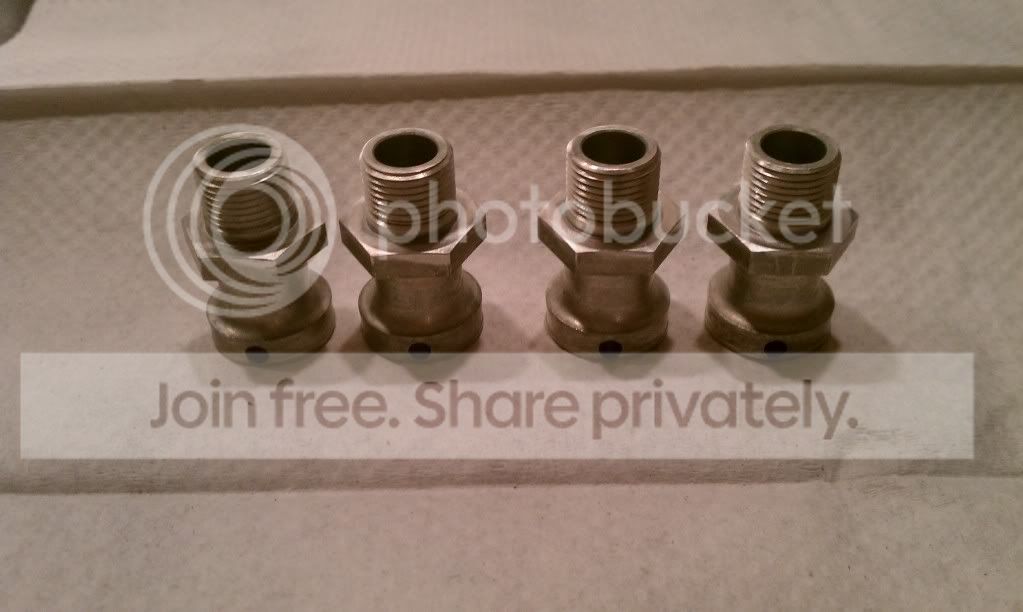

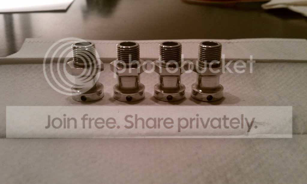

Ok. So here are my new extended hexes I'm gonna try out. First things first, the blue has gotta go!
After a short soak in some easy off.
And after a little bit of mothers aluminum polish. Looking to Get some things anodized black soon, but this will do for now.

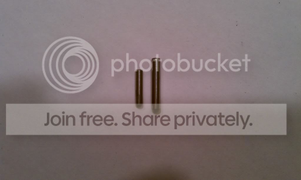

These are the stock pins for the hexes on the left and the rc8t hexes on the right. The rc8t pins are not only longer, but a little thicker also. The pins go all the way through the rc8t hexes and there is a small retaining ring to hold them in place. I'm probably gonna put a piece of shrink tube on there also as some added insurance.

How long did you leave them in the easy off for?
and did you just polish them by hand after? or use a dremel or anything?
And roughly how long did you spend per corner polishing? as i heard it can take a while

I put the hexes in a zip lock bag and sprayed it with enough easy off to completely cover them. Then every couple minutes I would rub them. It took less than ten minutes. I only spent about 5 minutes apiece to polish them by hand. As far as the axles, I brought them to my father in laws shop and told him what exactly I needed. After telling him that if he messed them up, he would have to buy me a new set, lol, he told me he had a place that he would have them do it right.

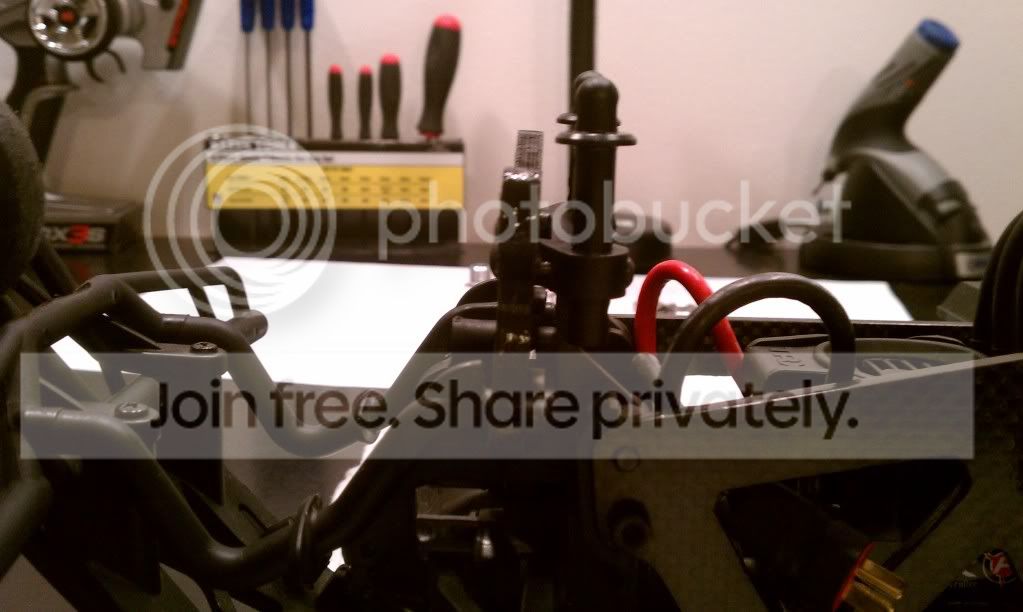

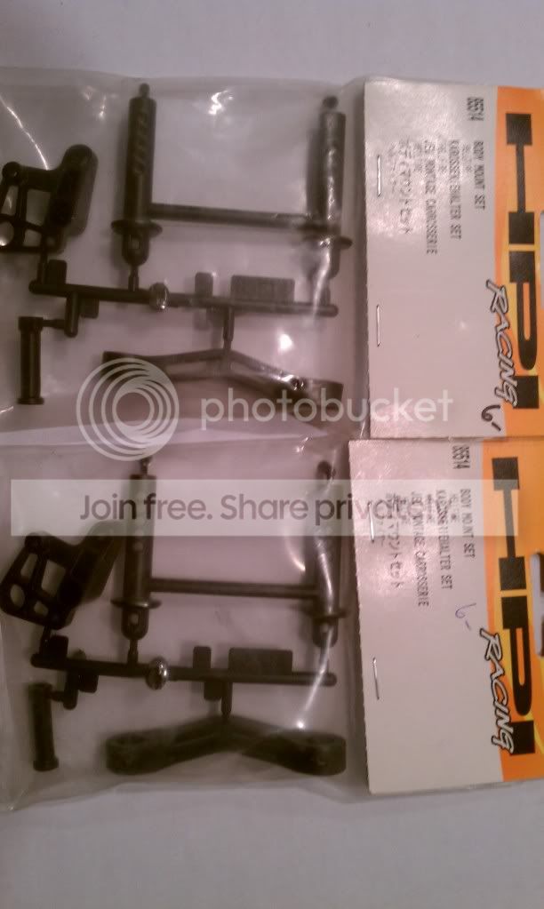

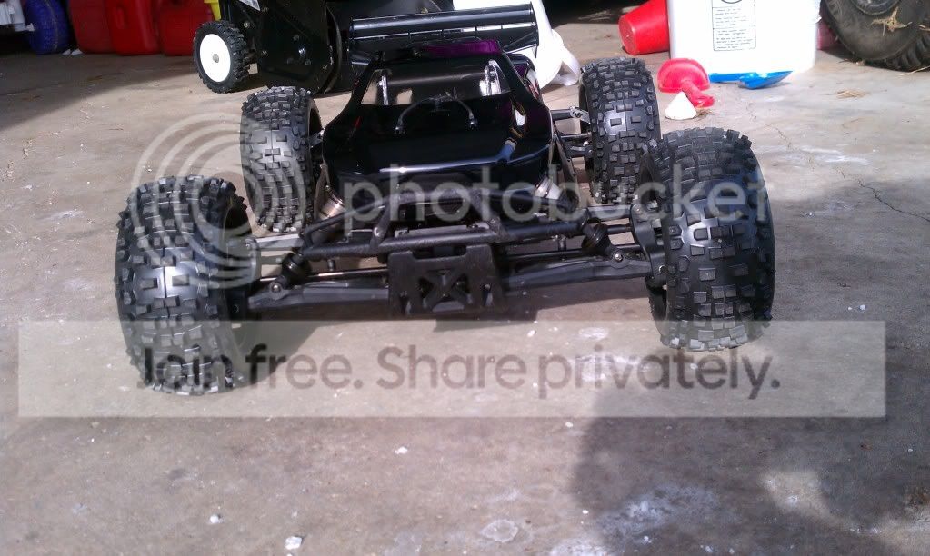

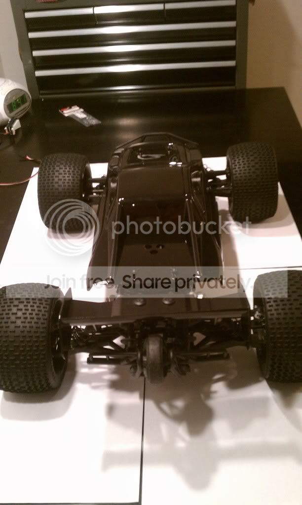

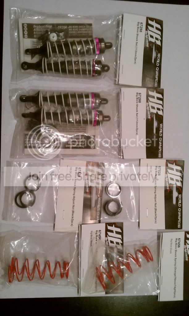

Got the rest of my parts in today!!! D8T rear shocks, D8T 76mm orange springs, and black threaded spring retainers. Also got my body wing and hellfire wing mount.

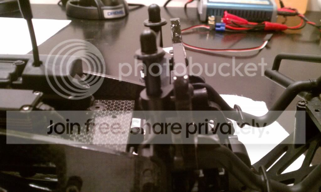

The hellfire wing mount had to be modded a little to work. The little nubs just had to be cut off. Nothing major, quick work for the exacto.

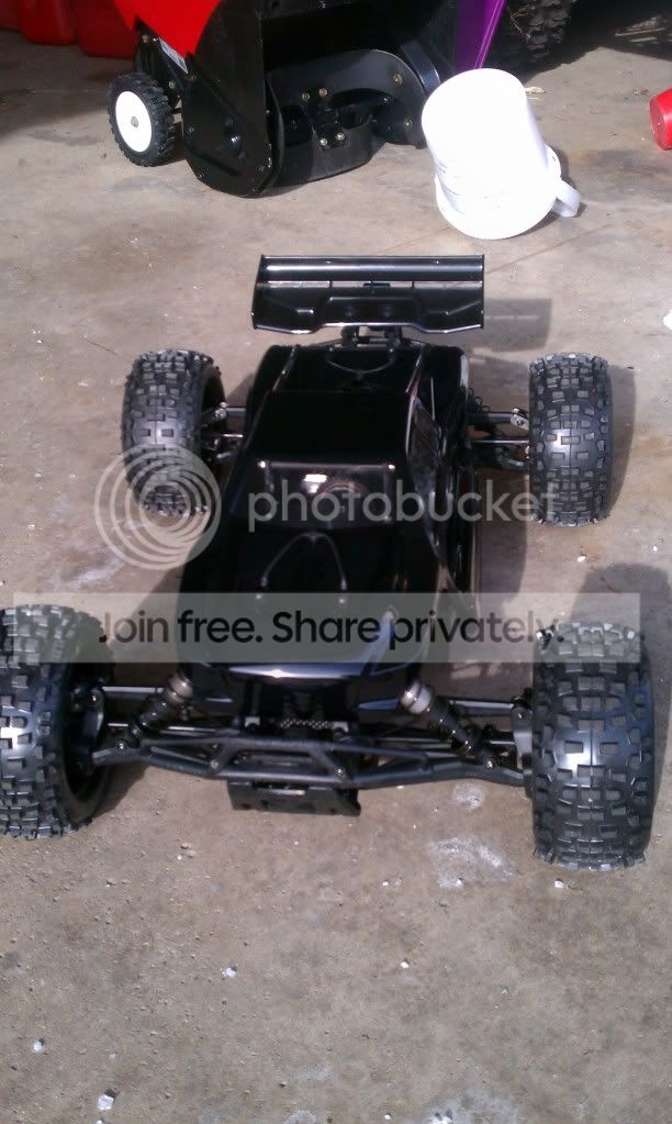

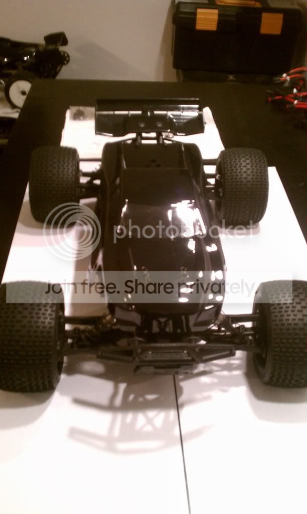

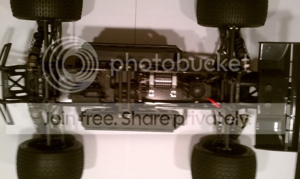

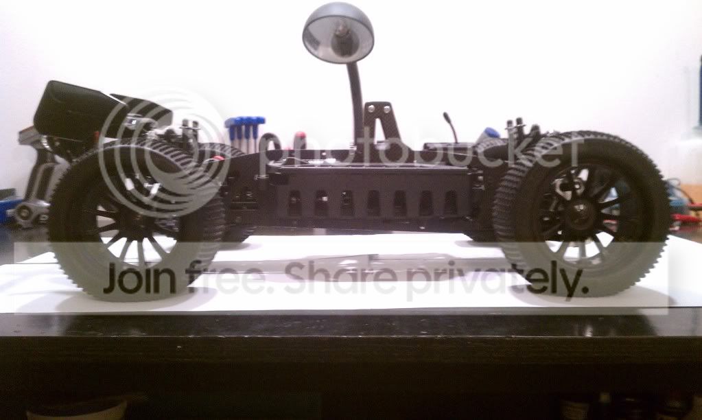

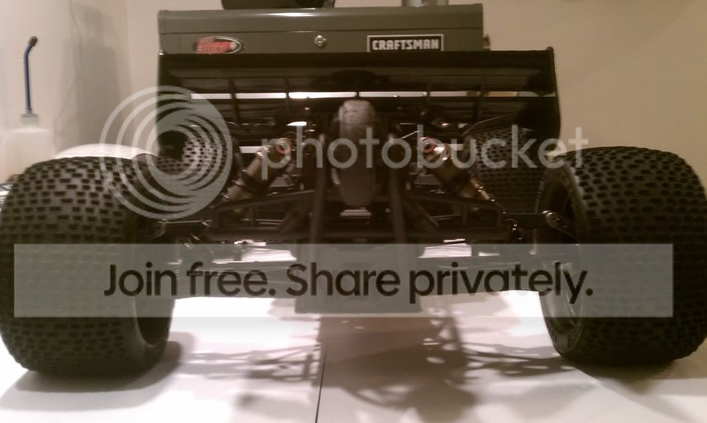

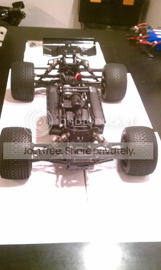

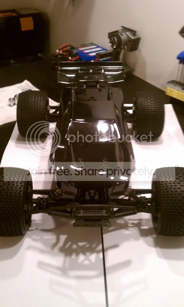

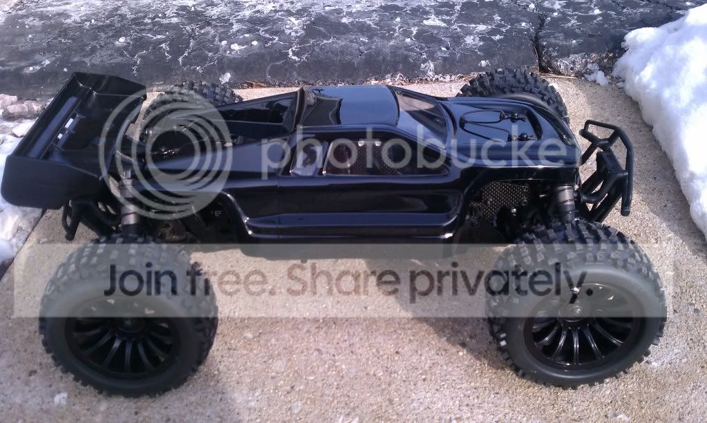

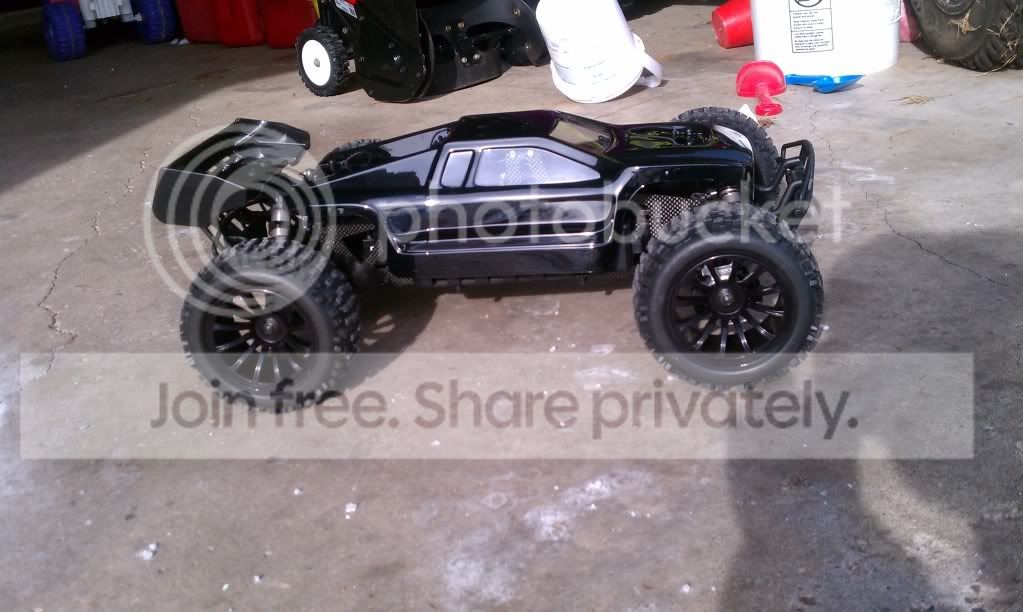

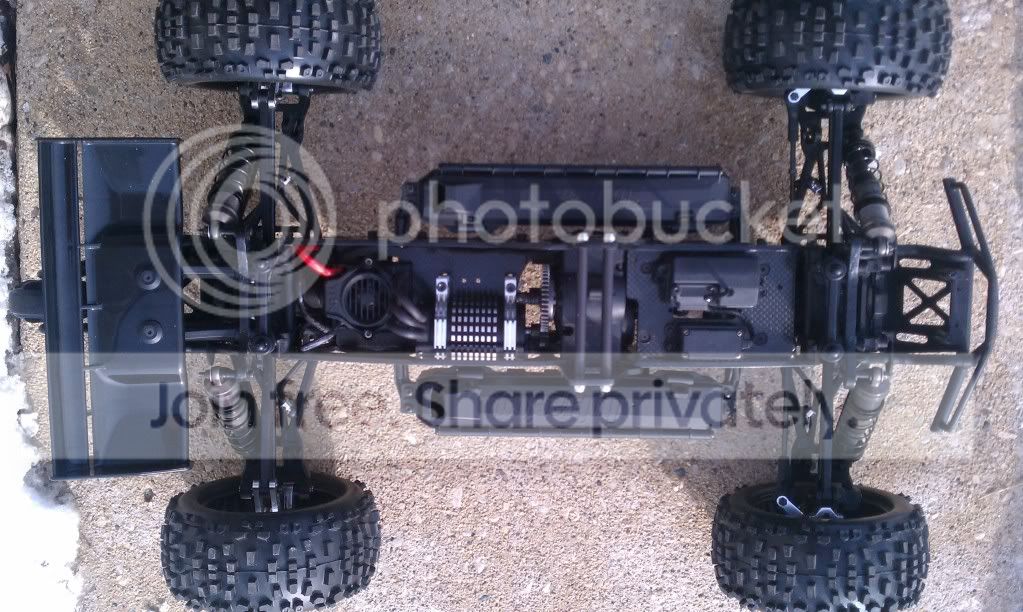

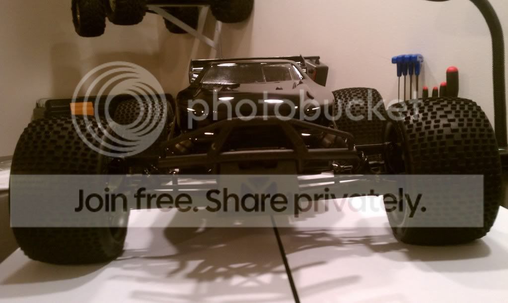

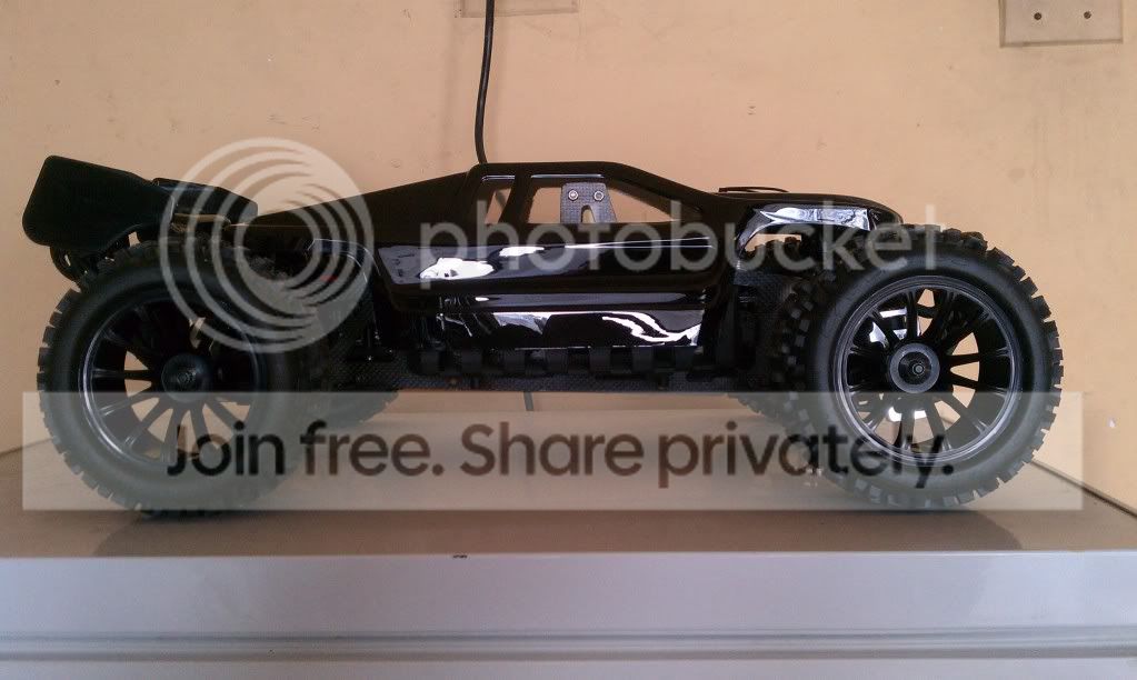

Got everything done and together. I ended up dyeing the orange springs black. Its hard to tell from the pics, but they almost look really dark brown, but at least they're not orange. I filled the shocks with 35 wt oil. Everything went together without any trouble. Only modding I had to do was with the wing mount and I also had to drill 2 extra holes in the rear tower to mount the wing mount. No big deal.

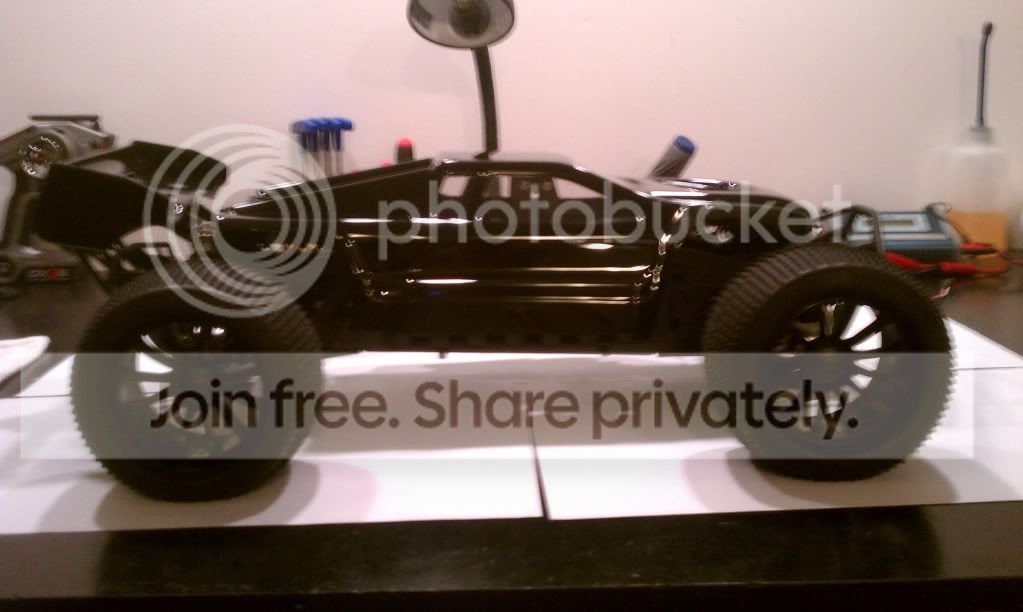

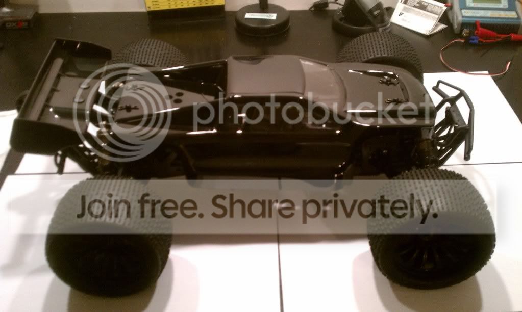

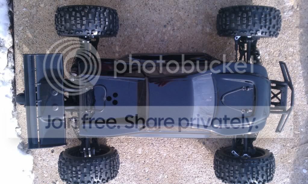

And here is another one of my custom, all black bodies, lol.
I have yet to mess up on one of the all black bodies. I tried one time to do a 2 tone, and the paint started to bleed pretty bad where I masked it off with 3m masking tape. I ended up stripping the paint before it fully dried with some nitro,lol. Worked like a charm. So I decided to stick to what I'm good at and do another solid black body. The body is a proline shift for the mbx6t. I wasnt sure if it would fit, so just in case, I could use it on my mbx6t. Its a little shorter than I would've liked, but it works.

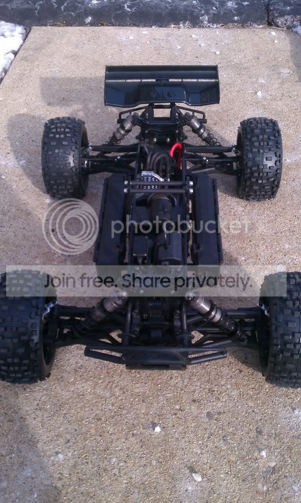

So now I just am waiting on my xl axles to come back. Should be any day. I'm pretty happy with how it came out. Just dying to try it out now. Comments, opinions or suggestions welcome.

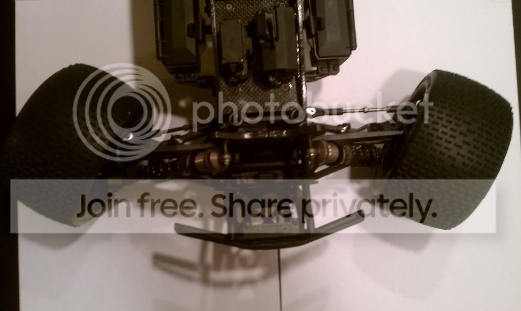

What still shocks me is how much angle you get at full lock with the integy hubs! Almost if not the same as the RSC kit!

The body is a proline shift for a mbx6t. I wish it was a little longer, but it works. I used 35 wt oil. I'll see how it works and go from there. I got the orange 76mm springs which were the longest and stiffest I found for the d8t's.

It does have quite a bit of throw with the integy, but not without the help of the dremel. I thought about going with the rsc but, all that purple really forced me to look for other options. I didnt want to have to deanodize everything and polish it all. Plus for the price of the prc, I got the integy carriers for both the flux and nitro on all four corners, and still came out about half of the prc. I haven't been able to run this yet, but I'm not sure how it would compare to the mbx6t. I'm sure the truggy would handle better, but the flux has to handle 100 times better than the nitro.
