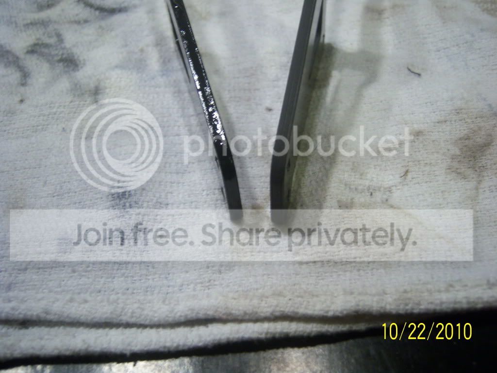

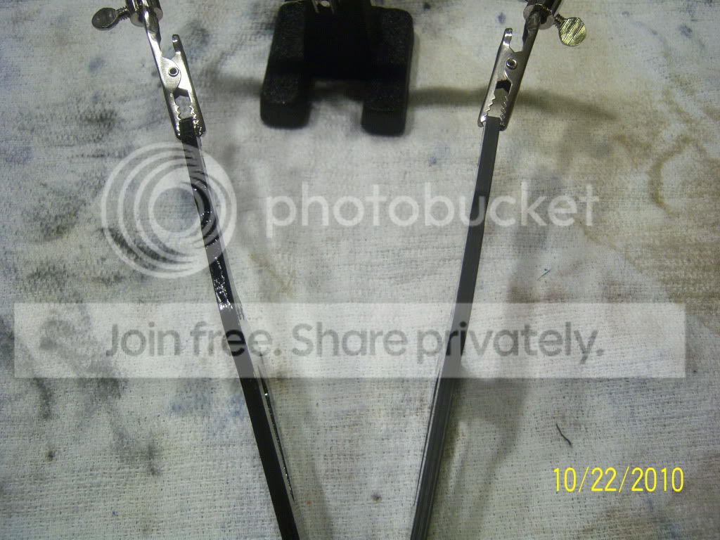

anyway, use ca. i used zap a gap. just put the edge of the part your sealing facing up, put a small (key word "small") drop on the edge. i unwound a paperclip and used that to spread it. it stays right along the edge.
sorry man, didnt mean to leave you hanging. thought it said.
Thanks. Maybe use medium, to help prevent dripping?
I'm sure any ca would work, just make sure not to get it on your fingers then touch the parts, you'll her ca all over your purdy cf.
its poetry easy to do with zero drops, the ca magicallyruns along the edge

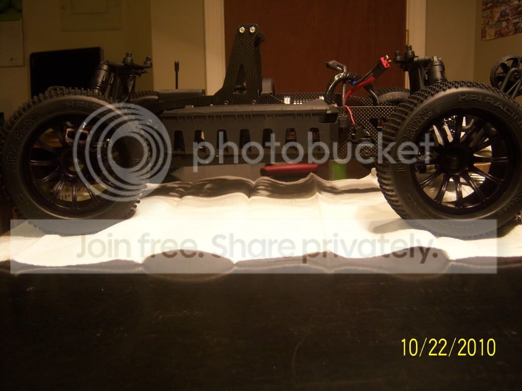

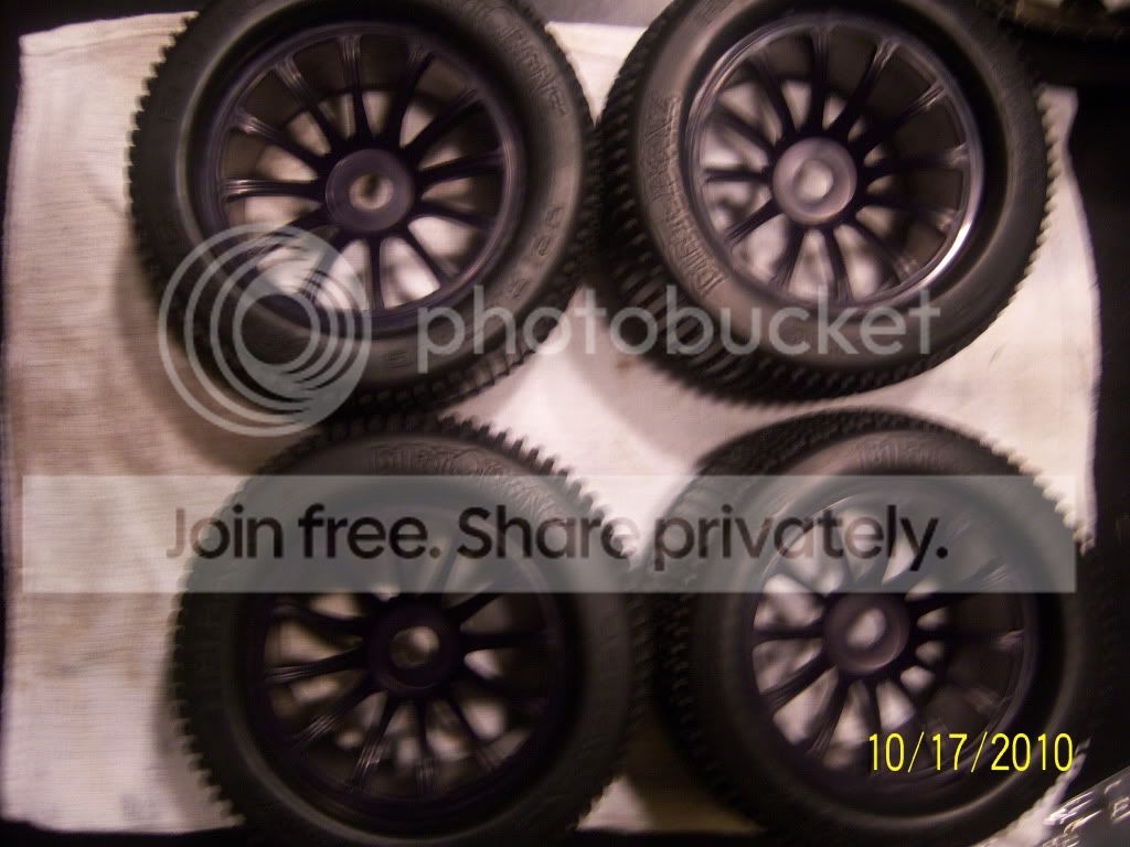

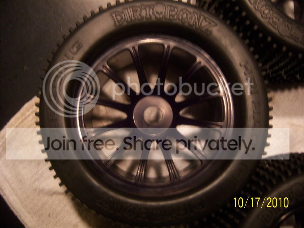

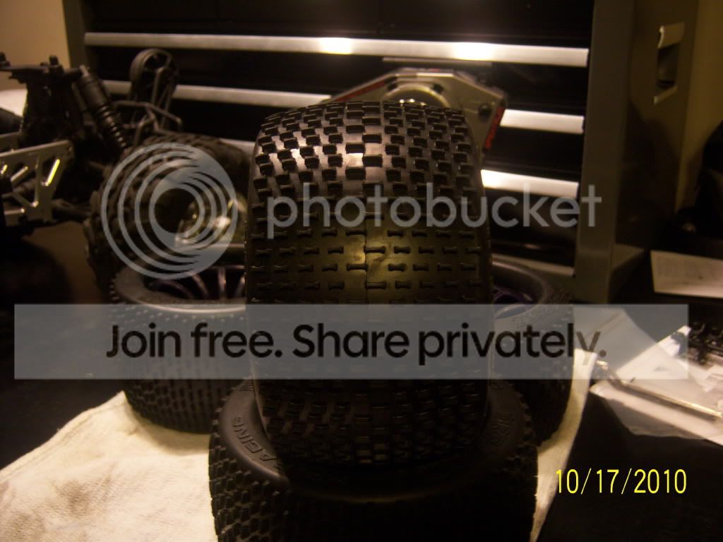

Well I ordered and paid for my PRC on 10/1/10 and still waiting.:dmt: In the meantime I got some new wheels and tires. Tires are obviously dirtbonz and the wheels are J Concepts rulux half ups 1/2 offset. Wheels were yellow, nothing a little rit cant fix! Plus you can find really good deals on the yellow wheels on ebay. So now just trying to wait patiently on my PRC. Hopefully it wont be much longer!
very nice build! VERY nice build!
I have the same ProLine lid here to go onto my trans-forward BL flux - I love the low-slung look. Are you using the XL extended outer axles?

Thanks! Yes I WAS using the xl axles, but I will be switching back to the stock flux axles. My xl axles bent pretty quickly. Well 3 out of the 4 did.

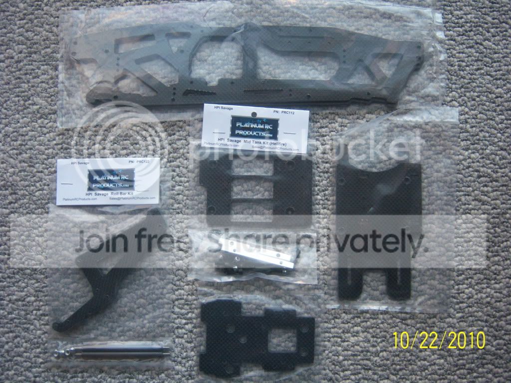

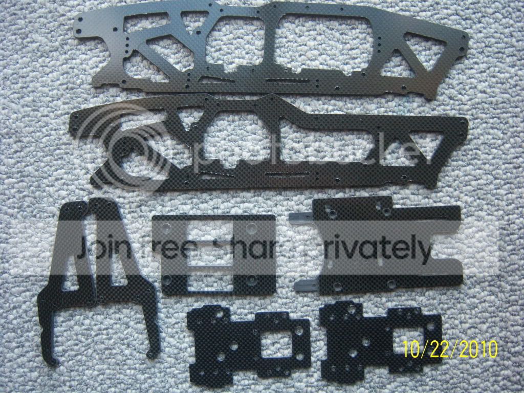

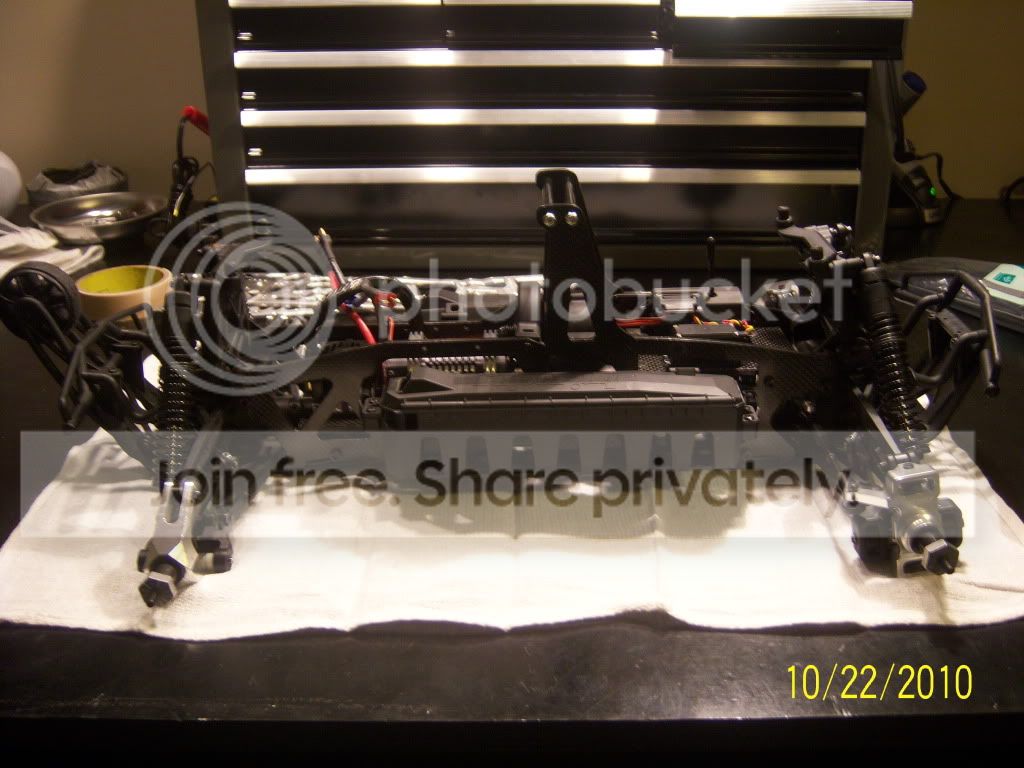

Well my C/F finally came yesterday!!! This is some nice looking stuff!!! Time to get to work!!!
Sanded all the edges with some 600 grit sand paper and sealed it all with some Zap A Gap. Makes a big difference. Gives it more of a finished look, and supposed to help prevent delamination.

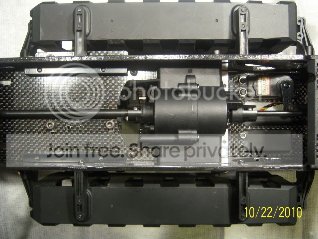

Everything fit together very nicely. Only grinding I had to do was a tiny bit on the tvp for the motor plate. Overall I am very happy with the results. Now just got to figure out what to do next!!!

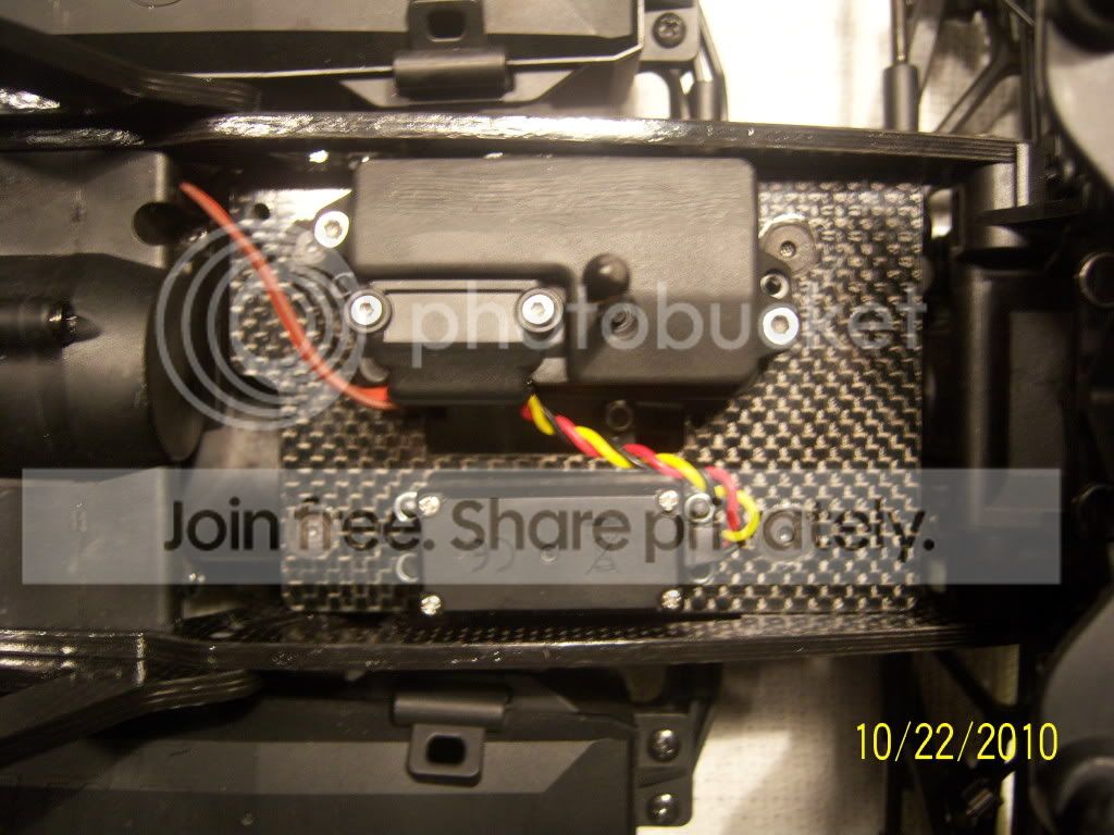

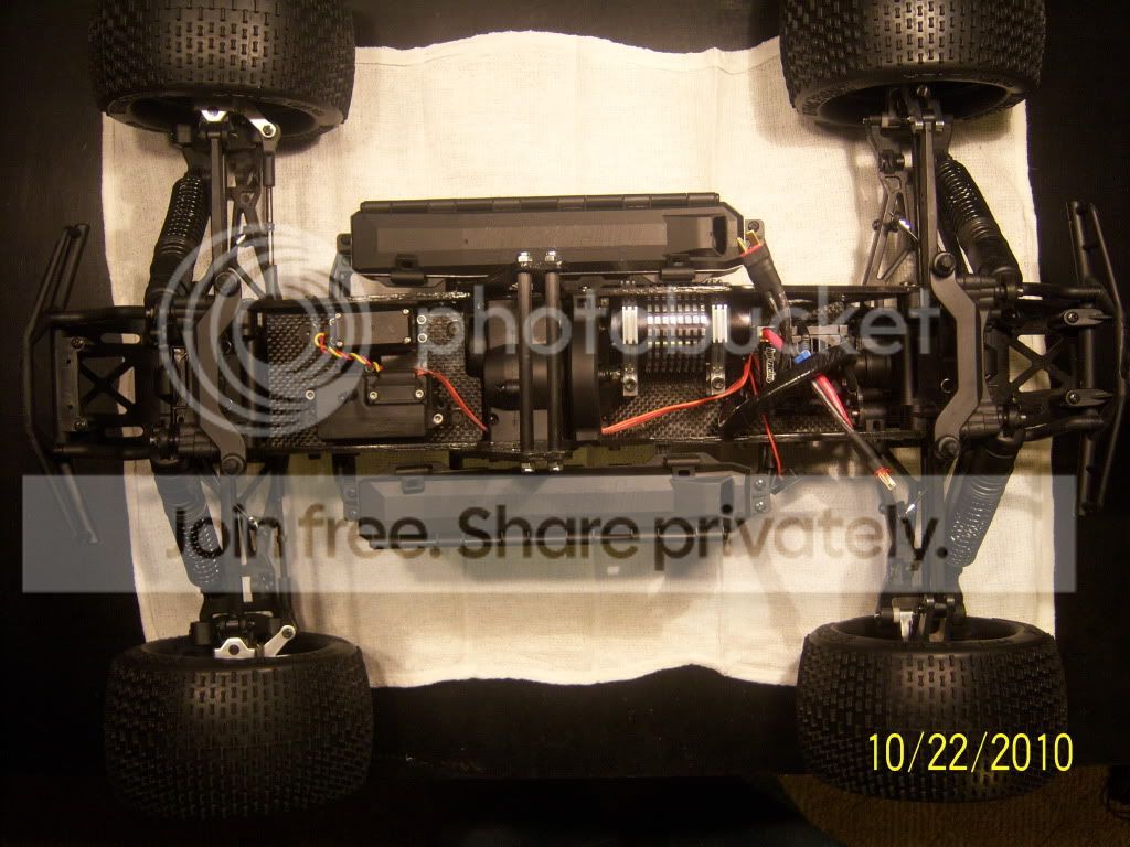

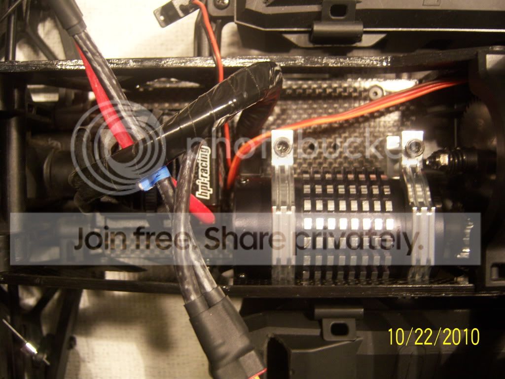

Thanks!!! RX box is a traxxas 2608, from a nitro rustler i believe. The knuckles are all from integy. So far they are holding up just fine. Got the same knuckles on my nitro too and no problems there either. Probably would have gone with the rsc, but that purple really forced me to look for alternatives. Didnt want the hassle of easy off and polishing everything. Now just deciding if I want D8T shocks or just go with hellfire shafts, and PRC C/F shock towers.
cool. I'm liking the box. mine is off of a traxxas summit but the wires go in the other side.
yeah I'm sold on the integy stuff. its tough!

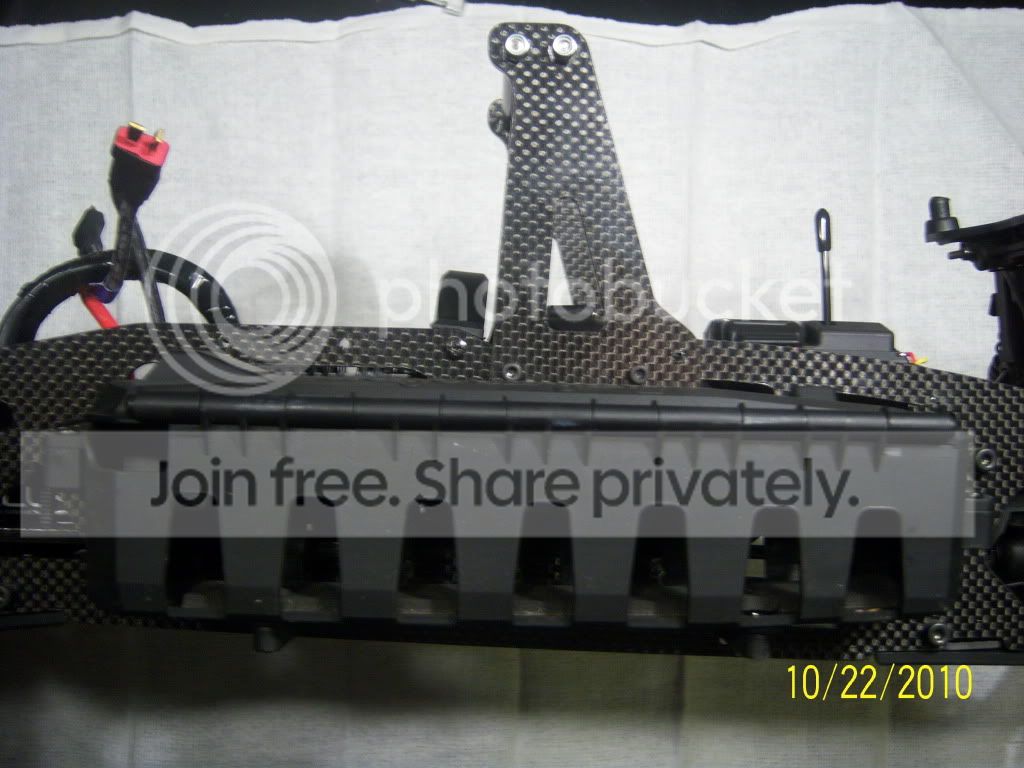

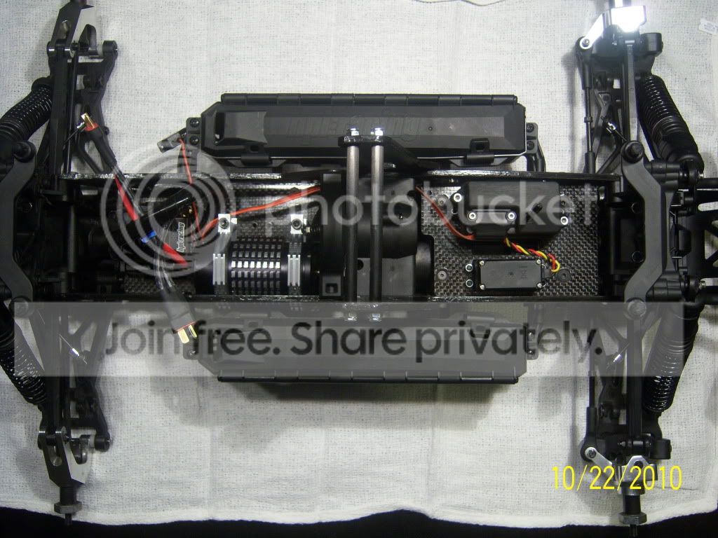

awesome job!!! Looks great! Another Carbon build ! Making me reallll jealous!
