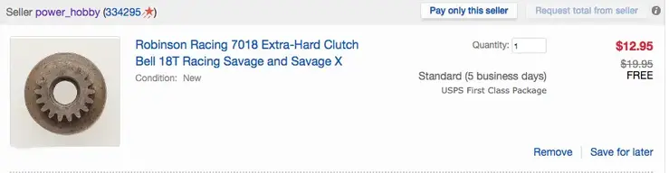

Hey hope ya guys can give me a hand. Today I started to break in my savage. I let it idle through 2 tanks of fuel like it said. When I got to the driving around I gave it some gas it moved foward a little bit then stopped. The motor revved up but the truck wouldn't move.took a look at the truck and turns out a small section of the slipper clutch was stripped all teeth gone. It was just about 1/2-3/4 of a inch gone. I was thinking about just getting the metal versions of both the slipper clutch and the spur gear. What else would I need to run this set up? Or what do ya recommend?
