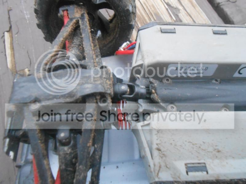

yeah tell me about it those were suppose to be "bullet proof" and Super Heavy duty bones might have to find some titanium ones, lol oh well brakes happen just wish i could get through a set of batteries before it happens.
Hey Shark, is that an actual Flux, or a conversion? Are you using the Flux bulks? (HPI #102272) If you're using the bulks that came with the X or XL, they look the same, but they don't use the stronger composite plastic that the Flux uses. The composite Flux bulks are more resistant to flexing, which may be what killed your BP gear.
