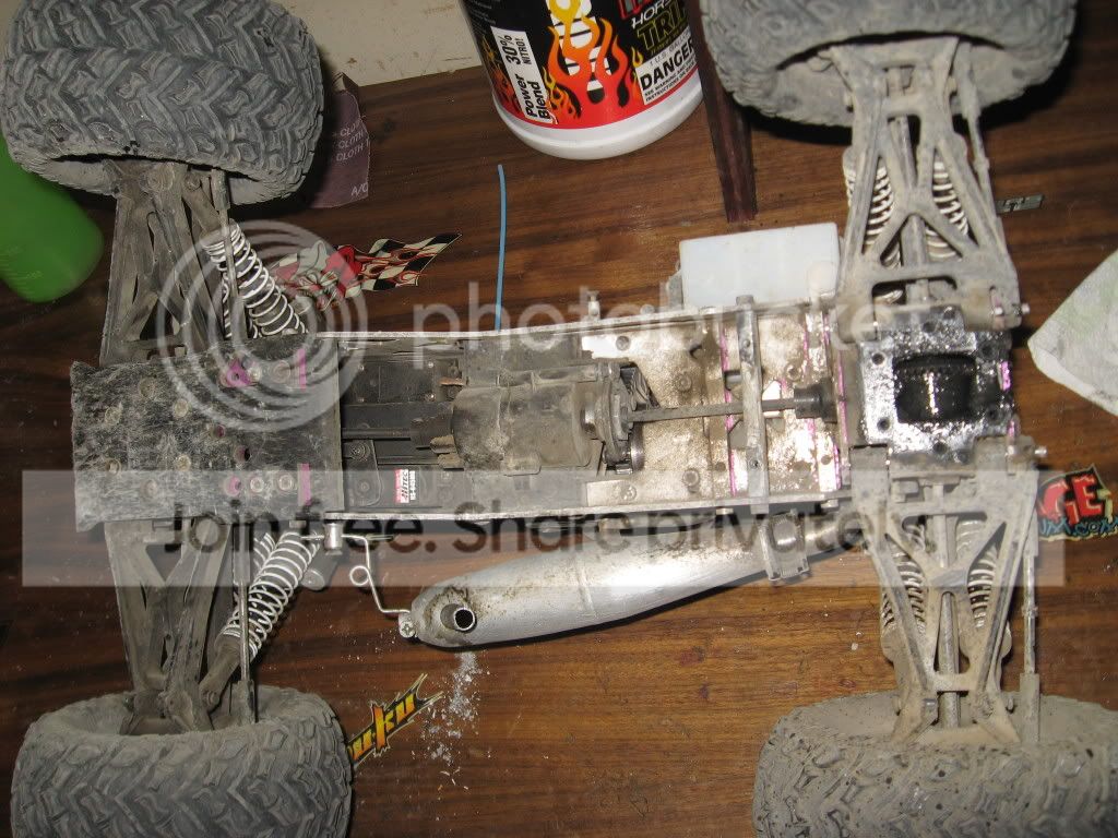

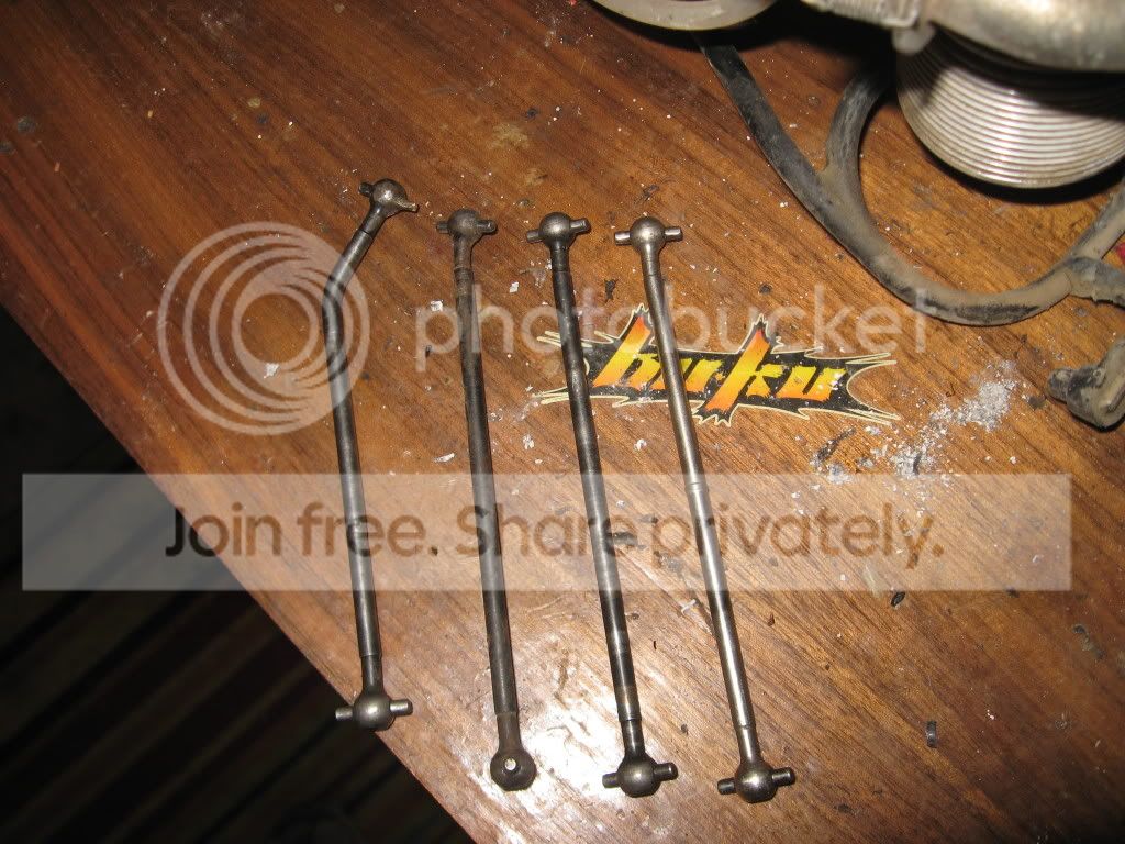

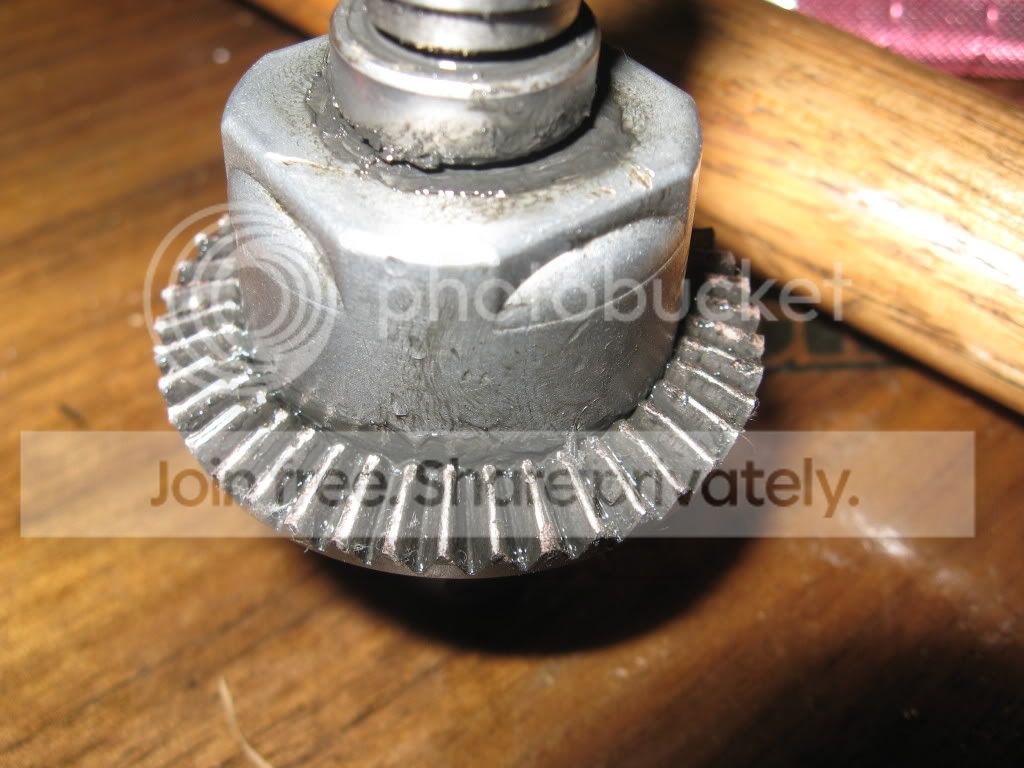

Been a few weeks sence I really beat my truck , Probably be down a a few more weeks due to lack of funds.....
tweaked the tvp's, 4 dogbones, spur, diff toast.
Wow thats a good bit of damage for ya.......
How are the cen shocks holding up for you, compared to stock maybe?
Nice dogbones J. Are they custom made? :resp:

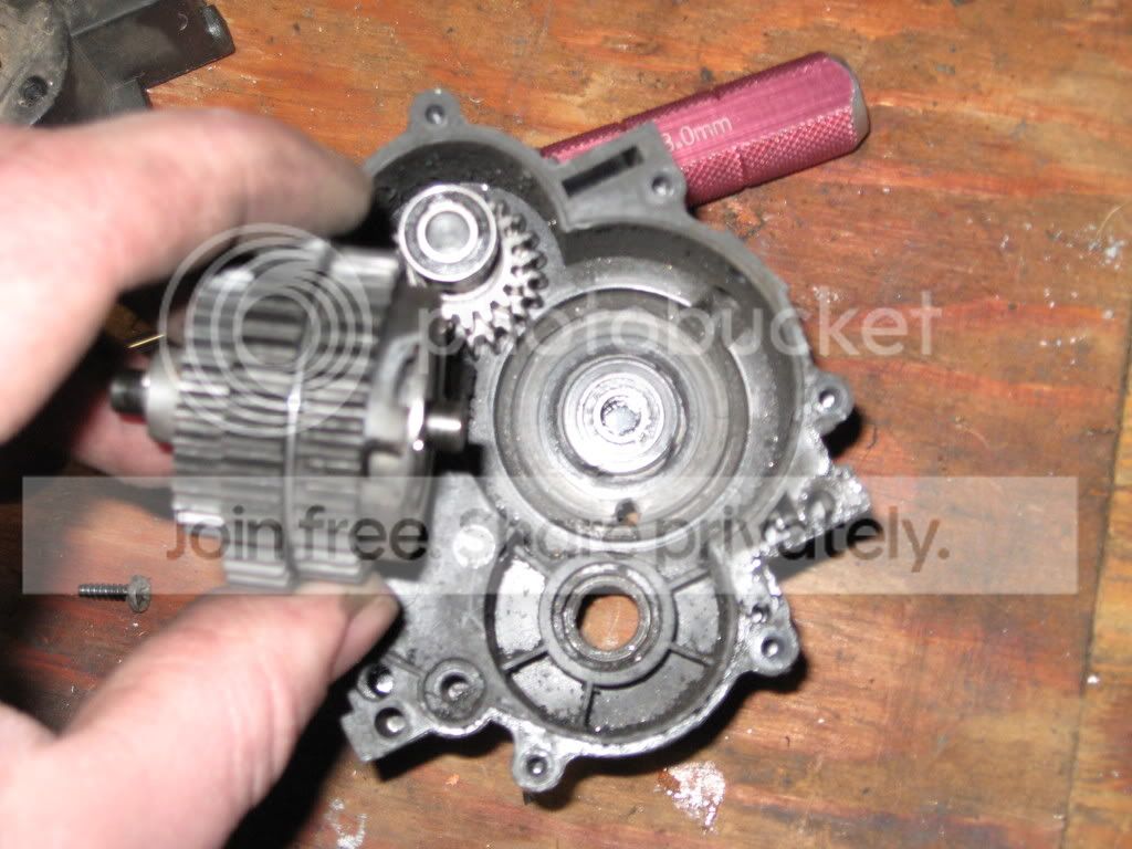

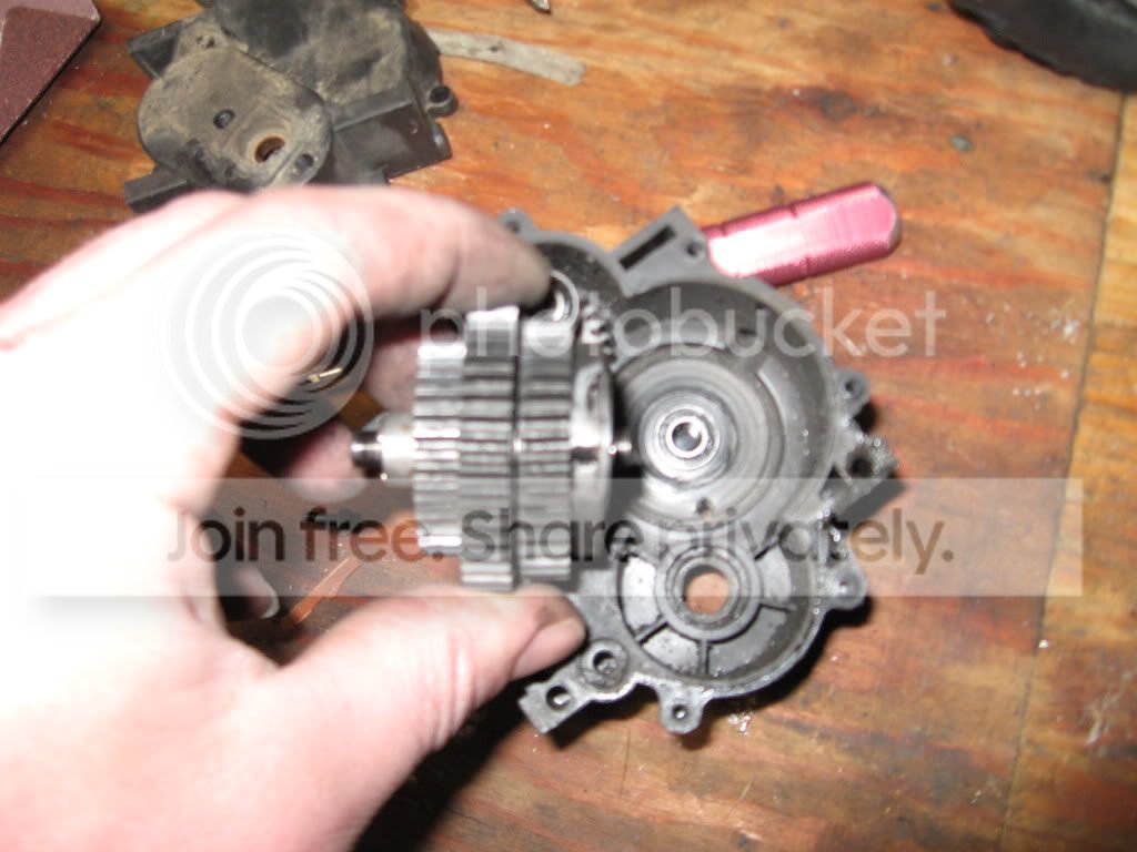

Tranny Damage today ,, HOW DOES THIS HAPPEN ? I am thinking about 20 gallons of hard bashing probably took it's toll
Notice the hole in the tranny case and the chunk of metal missing (next to the adjustment hole)
jeremy that happen to me twice
that little screw that holds the clutch finger in place backs out and ripps the heck out of the trans
