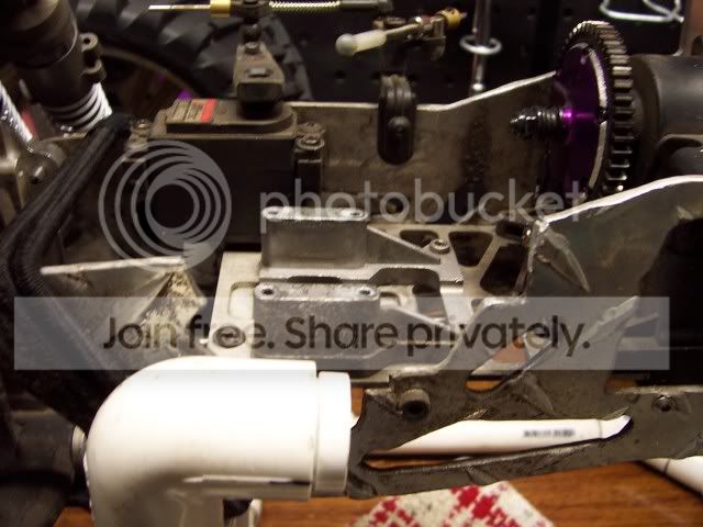

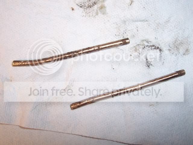

I found some more damage when tearing down the rear end. I have no idea how long they've been like this, but, oh well. And on a side note, RPM lower A-arms and Cen GST 7.7 rims/tires are still in excellent shape. I highly recommend these parts. Here's the pics.
As you can tell by the gouges near the end, I had one heck of a time getting them out.

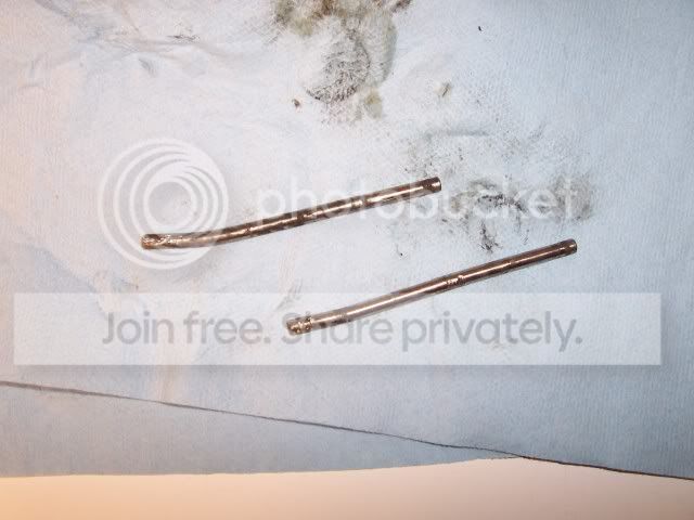

X, are those supposed to be pins bro? nice damage!
Yup, that's what they are. They were straight at one point in time. It took me almost 10-15 min. to get each pin out. Using just about every tool I could think of. Started with pliers, then tried hammering it out, then finally broke out the tiny vise-grips. They were a bugger to get out. I also slightly bent the hinge pin brace that mounts on the lower part of the diff case. I was able to straighten it back out and reuse until I can get a new one.

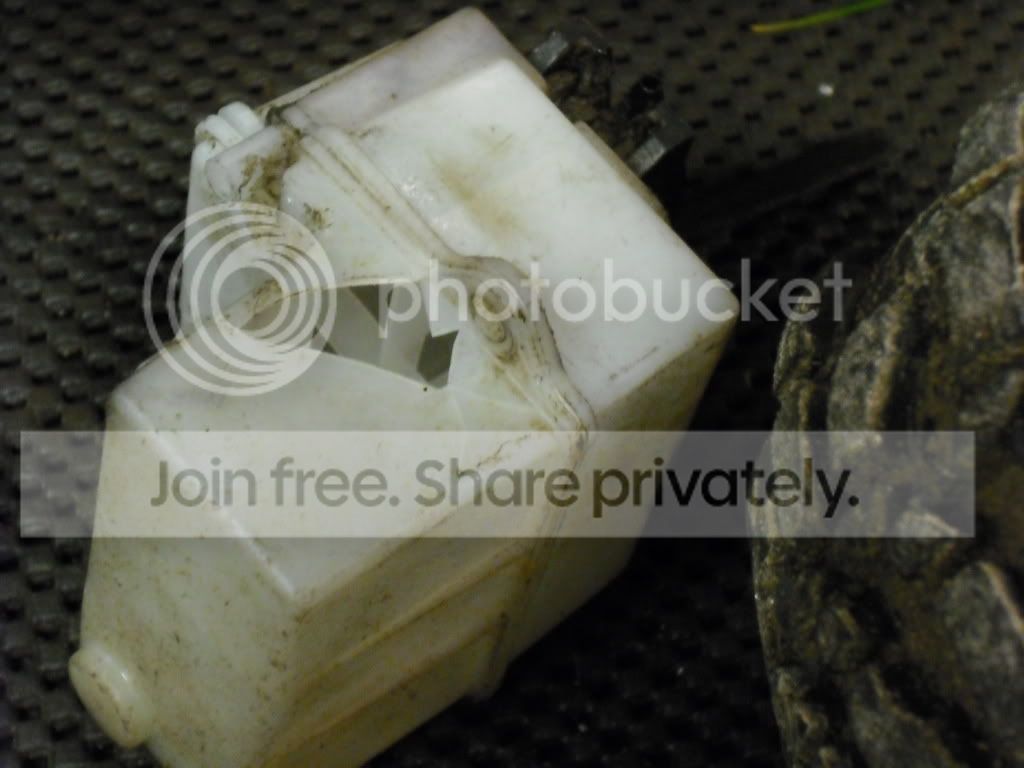

well i got my buddies 25 up and running so we head out for his first bashing and well he did this after a tank and a half (worst sound i have ever heard)
its the grey truck before he recked it lol
sorry for the blurry pics
how did that happen? that must have been a loud crunch. extended tvps...mid tank conversion??? :FarleyParty:
he is a rookie lol just got out of control rolled the truck and landed on a 6inch surveyers post and it was loud . he is lookin into new tvps just not sure which ones to go with.

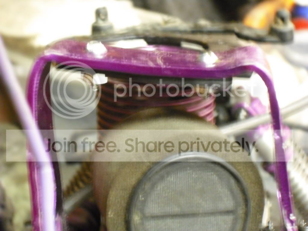

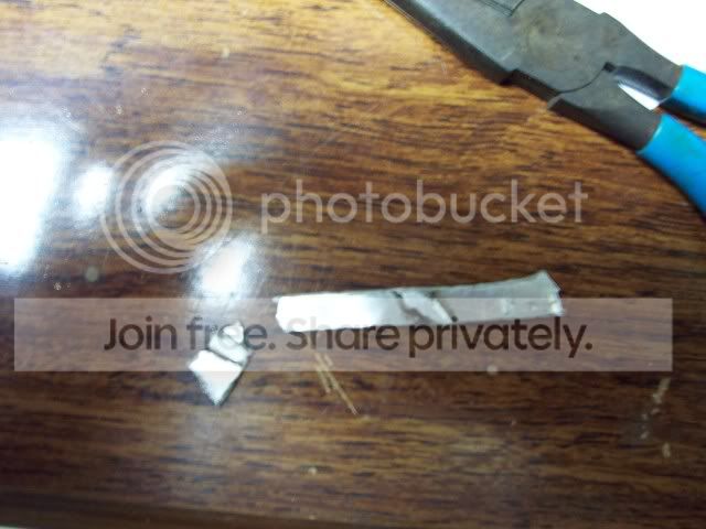

Found this damage while putting the motor back in after checking the condition of the clutch shoes and replacing CB bearings. Not sure how or when it happened, but, oh well. All fixed up now. All I did was take some heavy gauge metal (18 or 16) and broke it to make an angle and bolted it to the outside of the TVP accross the broke section. Will get pics of it later. Also, today broke a pin that holds the wheel hexes in place on the axle. I'm guessing that the wheel nut came loose and it caused the hex to rotate and snap the pin. Oh well, all fixed up now. Here's the pics.
