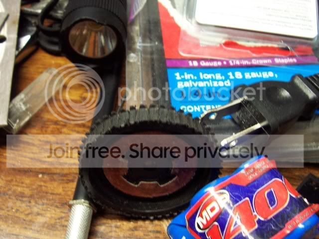

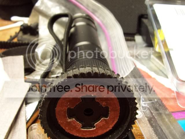

Damage from motor break-in. Don't understand how this could have happened. Gear mesh couldn't have been more perfect. Oh well, switched back over to the HPI alum. hub/steel ring gear set-up. I think the plastic one stripped cuz I was runnin the hardened/vented racing CB.
Cb got to hot.. You can tell b/c it's melted
your clutch shoes were probably dragging or something .. Being a hardened cb wasn't the problem

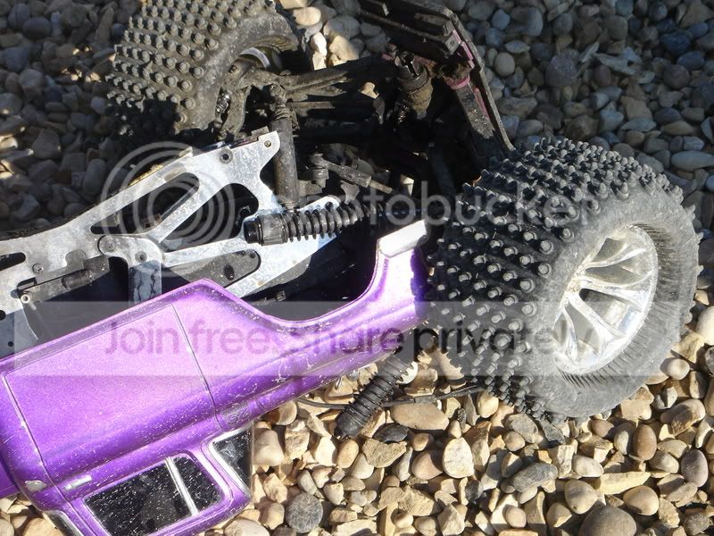

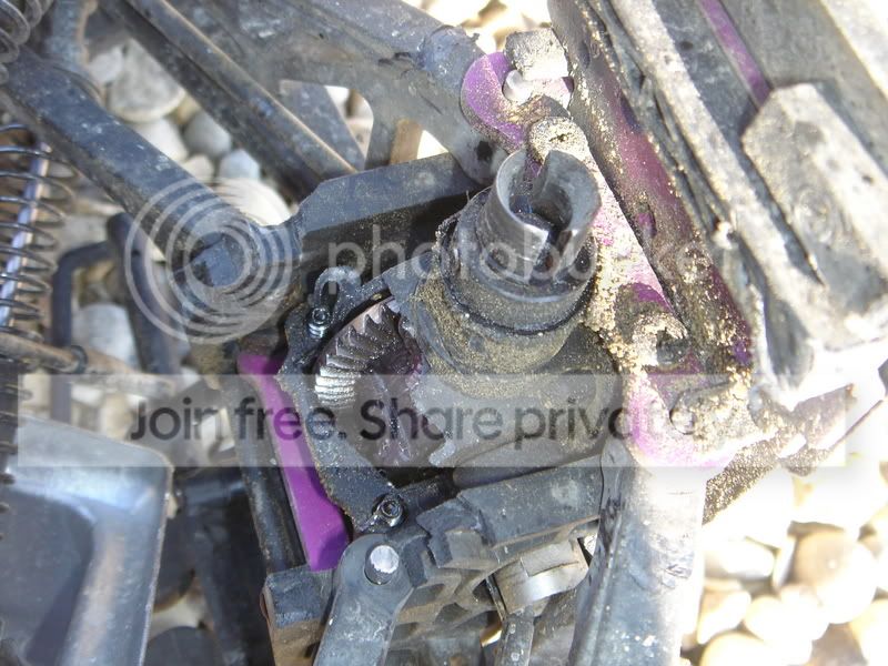

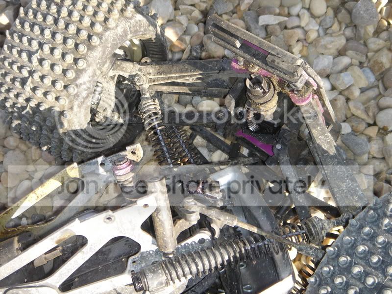

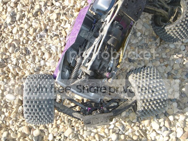

I finished getting my truck together last night and just couldnt wait until this morning to run it so I went out to the shop and proceeded to get it running and re-tuned.
before the rebuild I was running pretty lean so I reset the lsn and hsn to flush and started over since I added a buku.
I had the tuning plug in the pipe and was making passes adjusting my hsn. I had just made my last adjustment and made a pass and it was running sweet so I thought "Just one more then I'll work on the pipe part of the tuning."
I ran the truck out and was bringing it back and ran out into the grass where it evidently hit a small hill and endo'd a few times then did a twist or two before doing several cartwheels when it came to rest this was the carnage.:duh:
Take off the aluminum a-arms and you wont have to worry about breaking the knuckle, they don't assorb any of the impact at all like the stock a-arms do.
looks cool but does more damage than good.

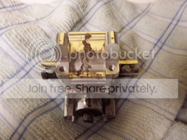

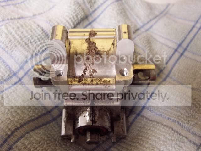

Since my truck is down while waiting to get my motor back from Crash, I decided to finally go ahead and rebuild the cen diffs cause they need it.
Do you think they need replaced at all???

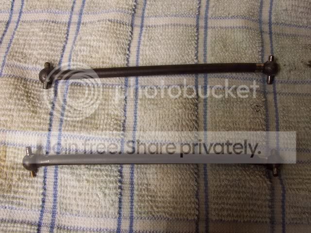

Here's a pic of the 2 front FLM dogbones.
They need replaced too.
Not sure about the diffs but I do know that the drivecups look like they need replacing bad on the diffs......
Yeah, that's why I asked about the drive cups Jeremy. But, I forgot I already got 4 to replace them with.
Now I'm gonna start looking to upgrade to the X-style easy access setup. That way I don't have to tear everything down to work on the diffs.
Damn... you should apply some kind of dry lubricant to those cups next time. That pretty much eliminated wear issues for me.
Those FLM dogbones really aren't that much stronger than stock, because the S7 tool steel is annealed. When tempered it has a yield strength of 220,000psi, and there is no way you could bend them... Try some IRC dogbones.
