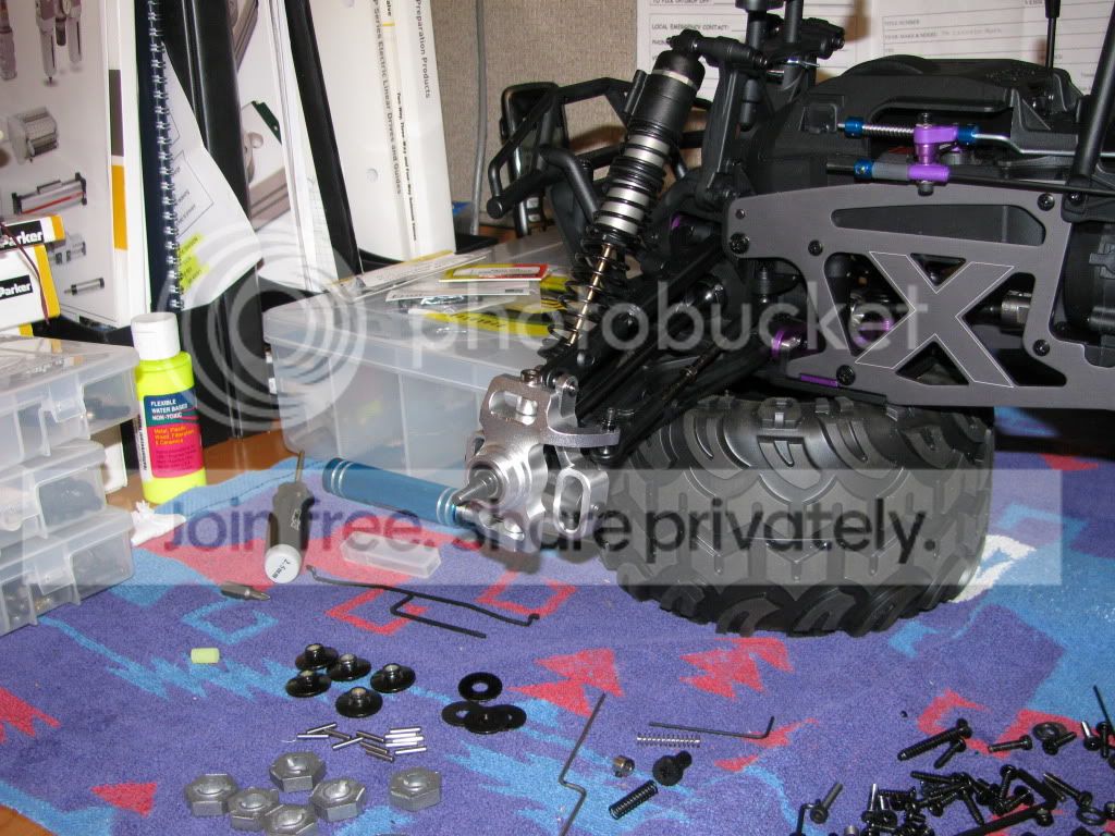

OK, I ordered the Integy rear hubs for my savage today. To get rid of the access bulk back there.
I also ordered the GPM front steering knucles and assembly. to increase my turn radious. I was able to find the CVA's with large diameter shafts and 2.5mm pins but they are not in stock. They were $50, I didn't think they were a bad price.

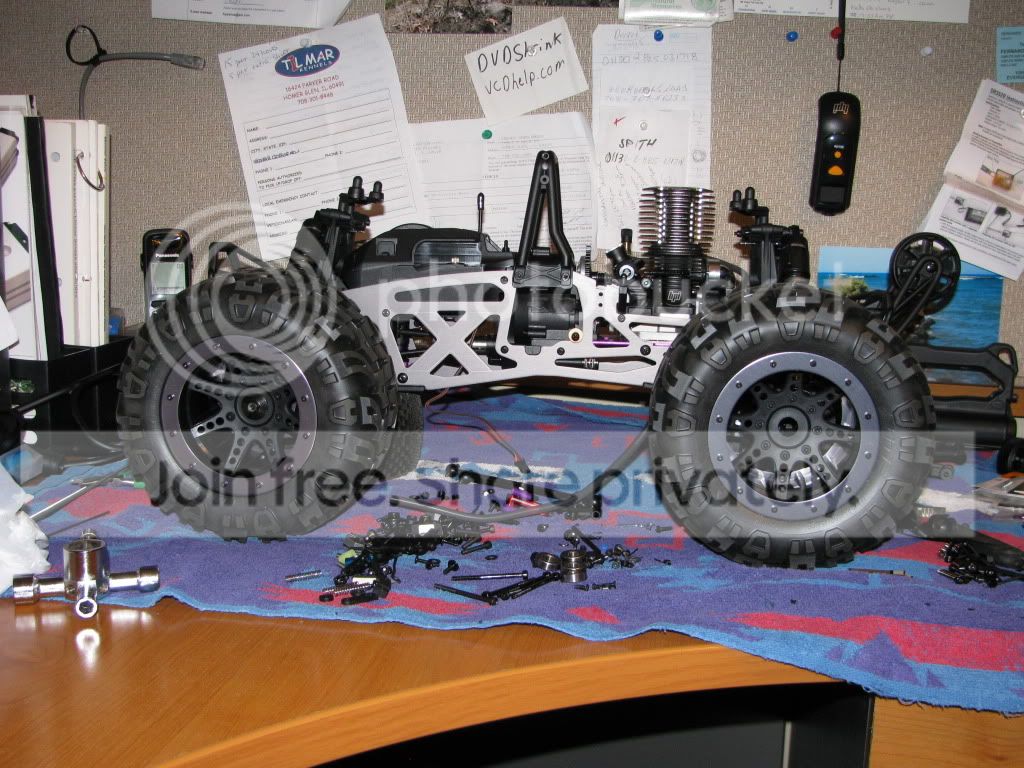

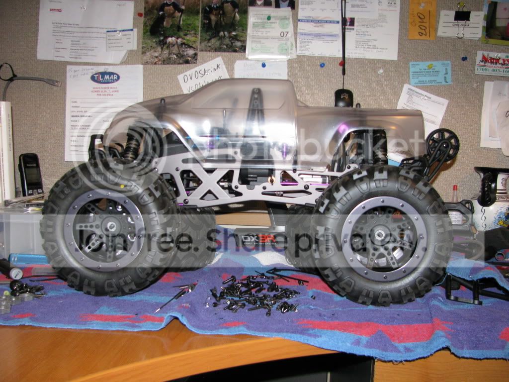

My AXIAL Beadloacks are in and MOABS mounted. They look nice, but I am not impressed with screws going into plastic wheels. There really isn't a way to put pressure down on the bead without stripping the screw in the plastic. Future project is to find a solution. These pictures are just up next to the truck, tires are not actually mounted to the truck.

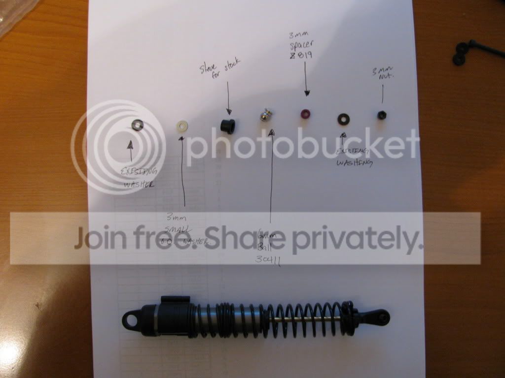

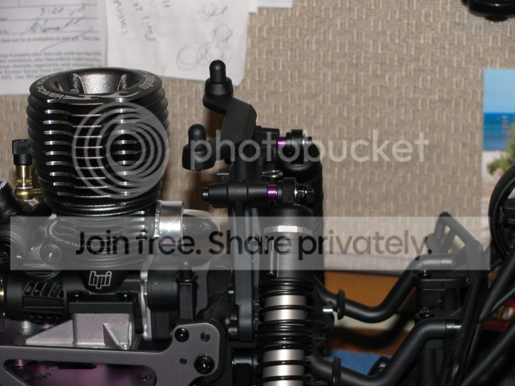

This is how I solved my HPI BIG BORE SHOCK problem. The problem was: To much slop in the upper mount in the hole of the shock.
I used OFNA part number 30411 bells, HPI spacer Z819 and walla. no slop.

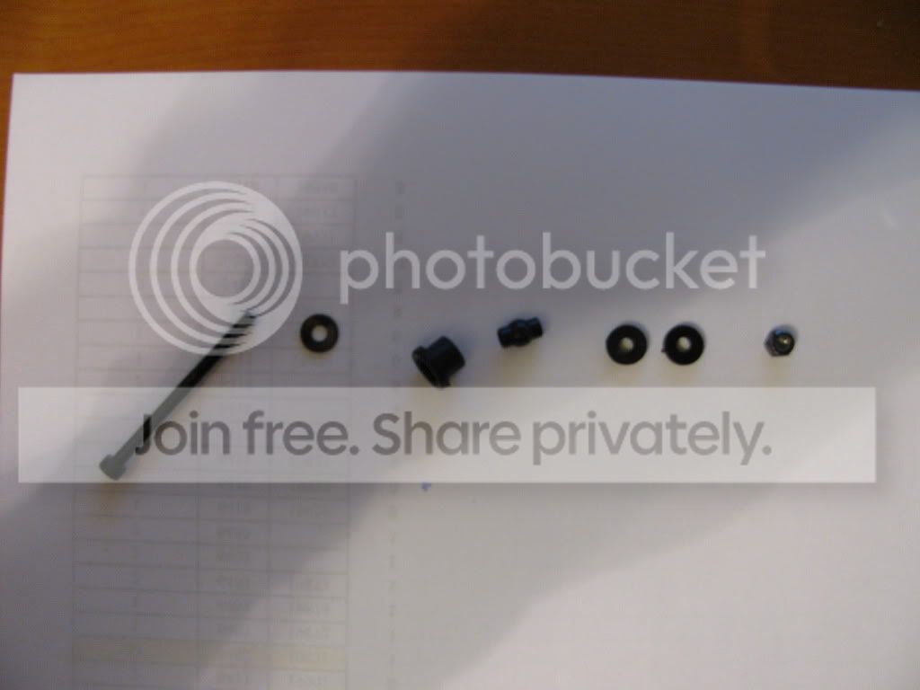

This is how it was from the factory and there was alot of slop

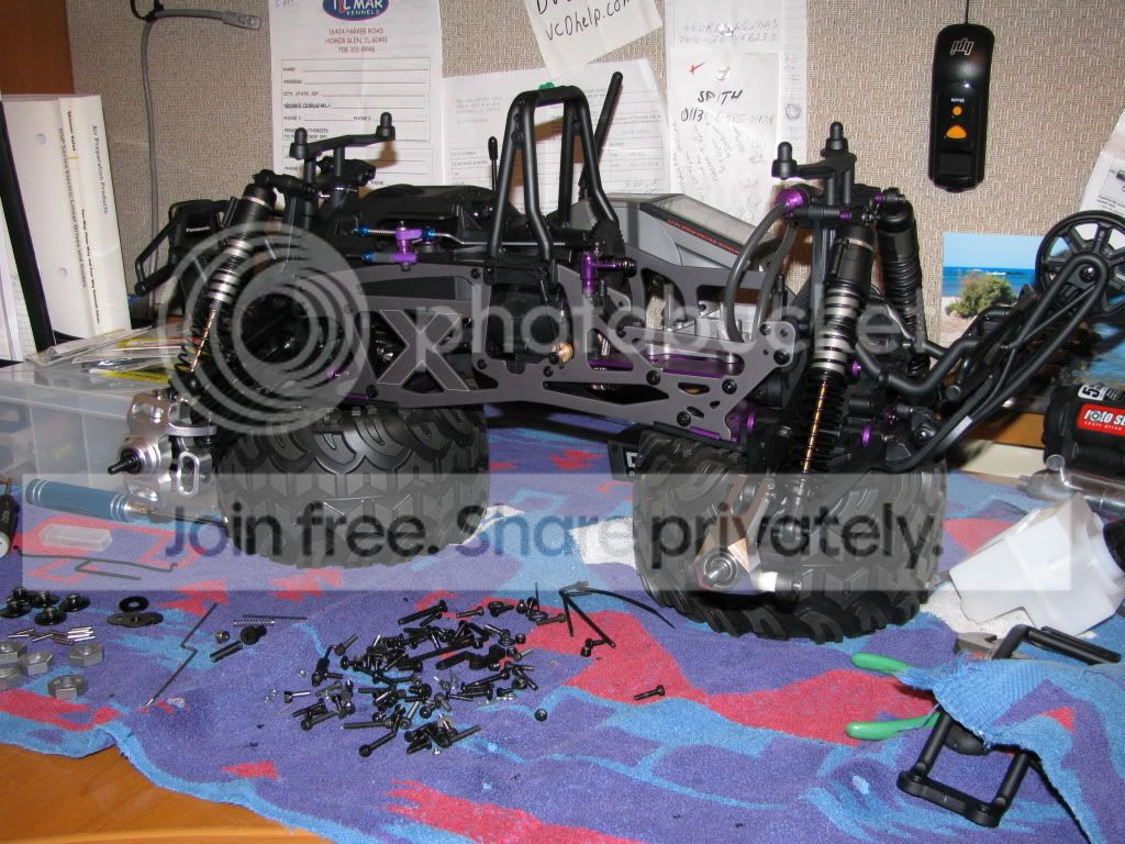

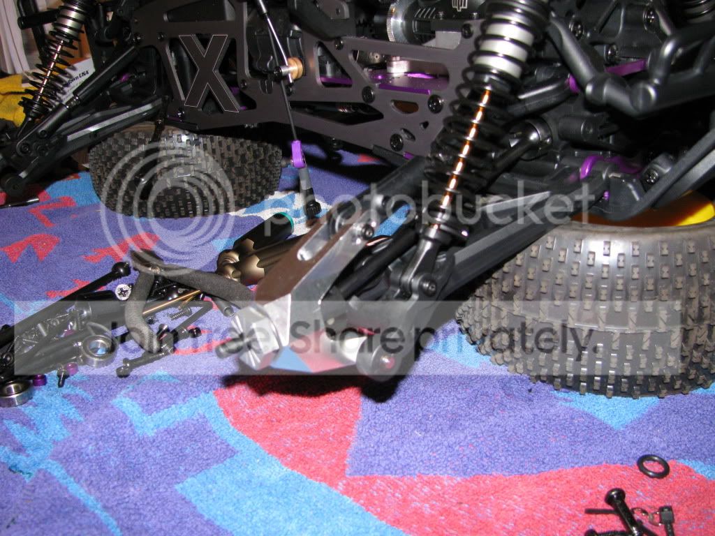

New rear hubs came in yesturday and installed today. Now I'm waiting for the fronts and some linkages and I am ready to go.

Have a question about the BB Shocks, is the Bell and extra spacer something that is needed or is it just user preference? I bought the plastic BB Shocks and just wanted to know if that is something I need as well or if stock will work as is.
Thanks,
ulua
The stock will work, I was not pleased with the slop in the mount. Basically the slop comes in the black ball and the sleve it goes in. The inner sleeve diameter is 6mm the ball itself is 5.38 and there is too much slop. If you mount it and snug it down it will squeeze the assembly all together and you will not have movement on the upper mount at all.
The way I did it, you will have a solid no slop setup and the shock will move freely.

OK, got most all the parts in yesturday got it all mounted and almost ready to go. I am having my motor gone through right now for more power. I should have the back next week and will be ready to roll.
I purchased the GPM front hubs because the turning radious on the stock stuff sucks. The increase the turning radious tremedously. Keep in mind I have also put bearings in the stock servo saver.
The rear are heavy duty Integy

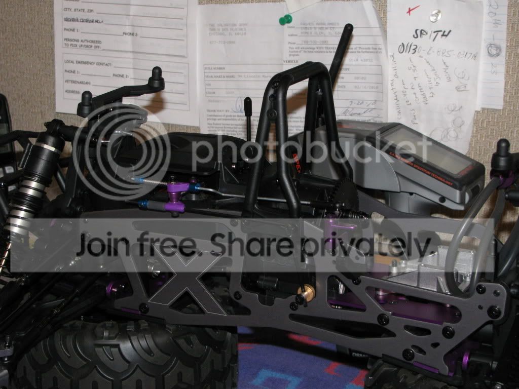

The linkage is done
This is how the truck will sit when all said and done. I do have another set of real beadlocks I am working on.
Its to cold to paint right now, but I will have the masking laid out but next weekend.
