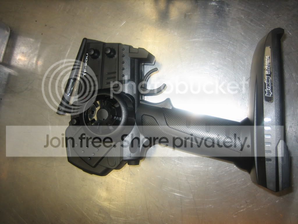

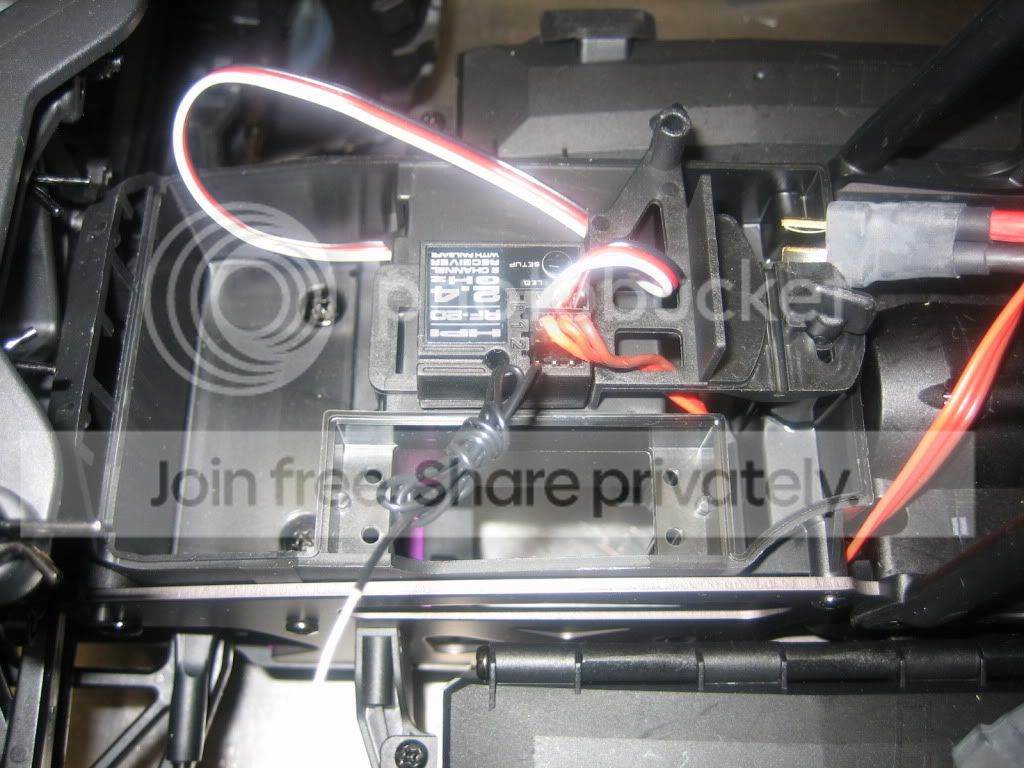

Here is the 2.4ghz stock HPI radio. It's cheep but a great start to go to 2.4 on OEM truck. The receiver is absolutely tiny, it's less than half the size of my 3PM receiver's and less than 1/4 the size of all the 27mhz stuff. I'm not sure why the antenna is so long for this guy compaired to other 2.4 systems but o well.

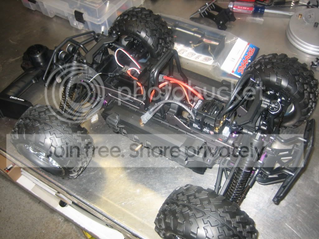

First mods were to shave the front hubs to gain steering radius and I installed the 1/2" wider XL shafts to gain 1" width.

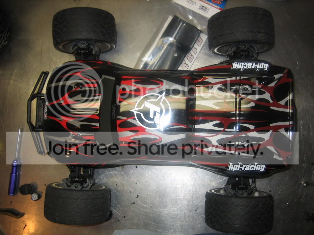

She isn't this perdy anymore, has a little road rash, LOL. You can see in the last pict the CF look alike wing although you cant tell it looks just black in the package with this camera and the lighting. The body is very wide but will fit nicely with the 1/2" wider axles and 1/2" offset wheels. I guess we will see.

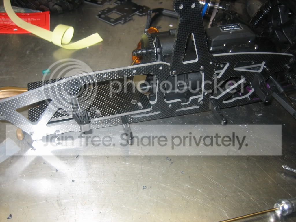

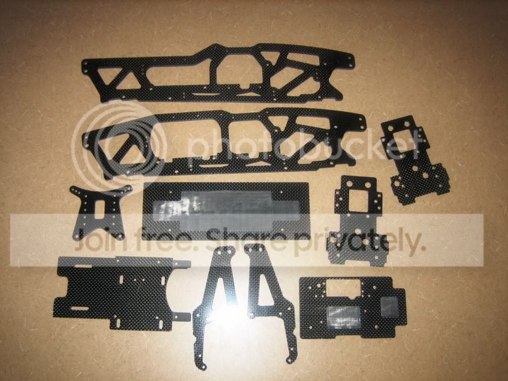

Alright, this is what you all are looking for. Just a teaser shot of some of the CF parts. Keep in mind some of these parts are custom to this build.
Those are sweet Jason!! Can't wait to see this build come together!! rockout
Those are cut outs. Places where I took about 2.5mm out of them to lighten the parts.

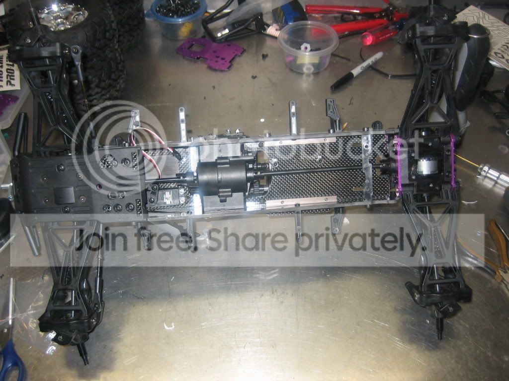

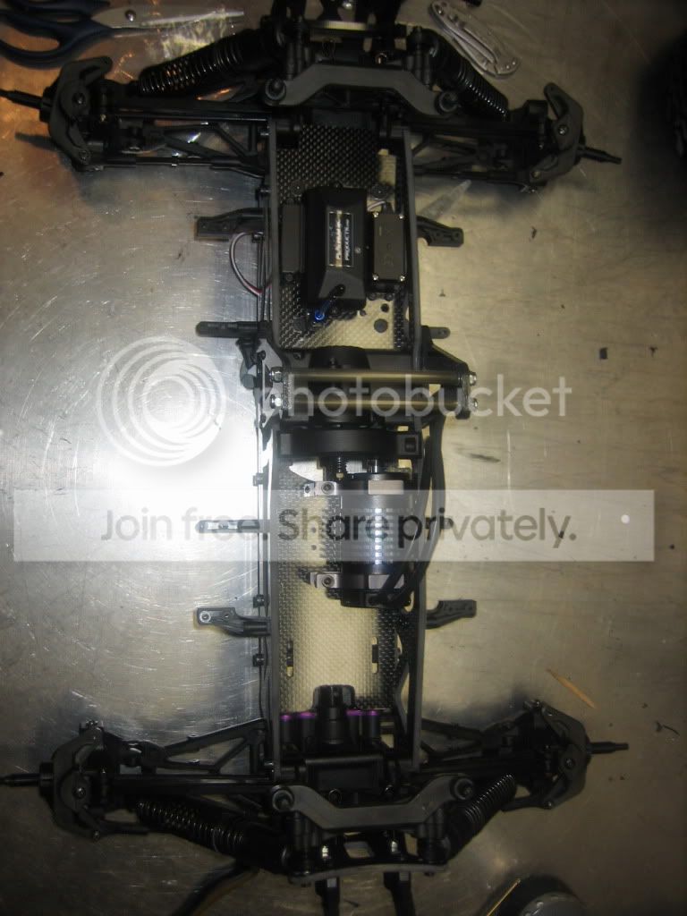

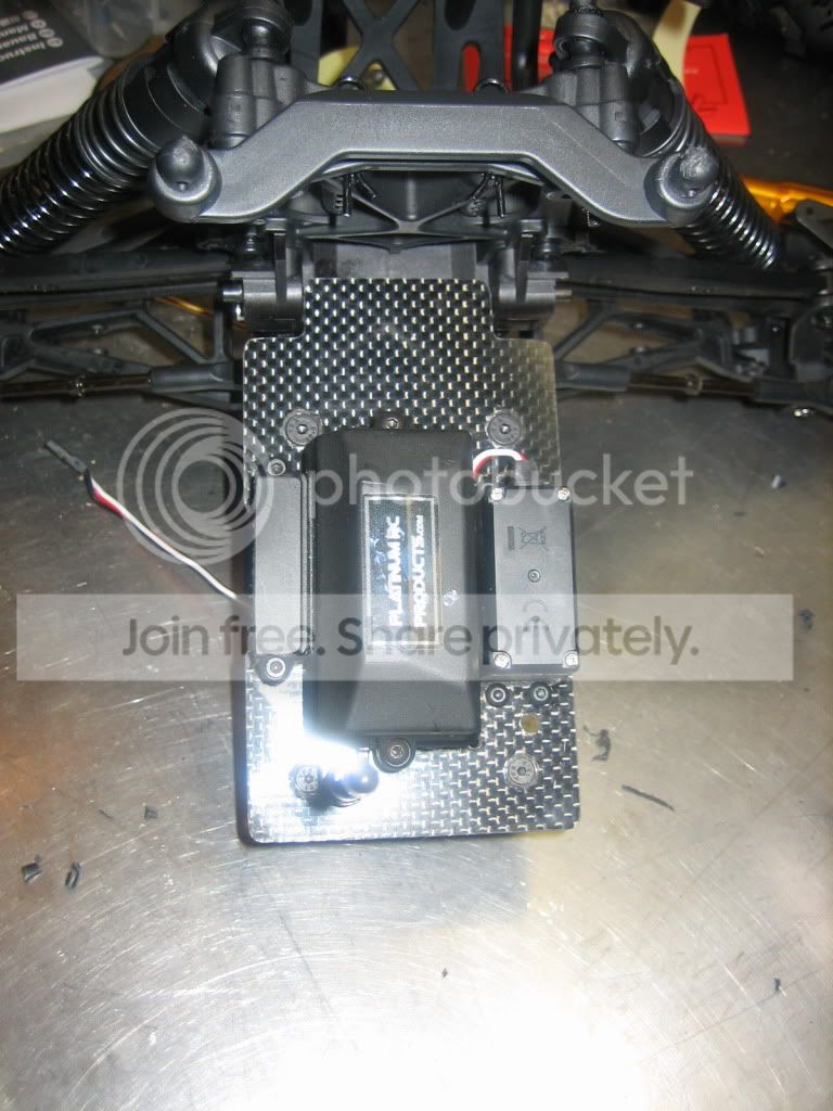

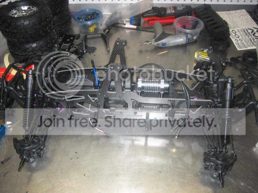

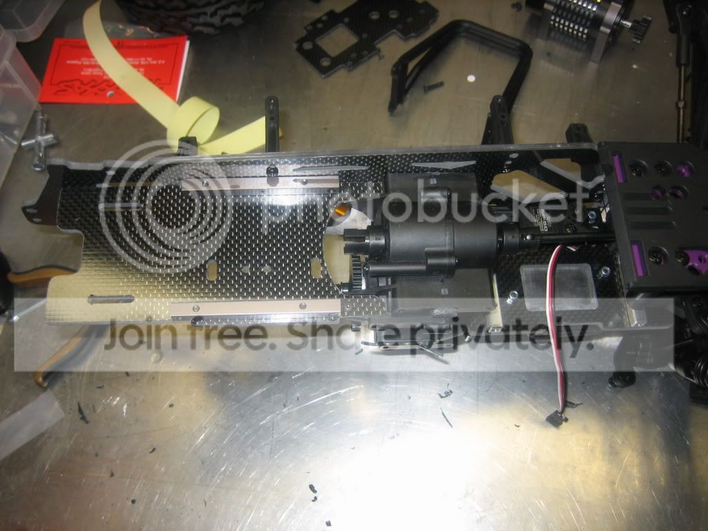

Well she is pretty much together. Needs the ESC mounted, battery box's installed and electronics hooked up and lower bulkhead plate and bumper installed. The body is being painted currently, it will be pretty simple but will work. The BP diffs where shimmed very good as they were. I did clean and refill them with 5000 in front and 7000 rear. I think it came along very well. Here are a few shots of it. Threw assembly, I would have had more but the cam battery is dead and the wife miss-placed the charger.
