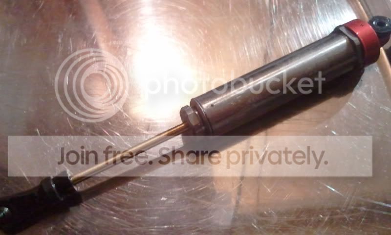

What are those shocks from, where did you get them, and how much were they? Can you use stock HPI Big Bore shafts and pistons with them? I love the look of those, and if they're cheap enough, I'm gonna grab some...
They are just regular Alloy BB and Plastic BB. The alloy BB is just naked without the spring etc. I'm just running it for increased damping as my spring setup is very stiff.
Those aren't HPI alloys. I've got a set of A720 HPI Aluminum Big Bores on my truck now, and they're coated dark grey and have plastic lower caps. Yours are obviously different. Plus, in post #1 of this thread, you said they wer cheap Hong Kong parts. Do you remember where you got them, maybe have the ebay store you bought them from in your MyEbay list still?

Ascender - you are right, these are the HK Copy BB... But they are awesome. And i can make the sway bar upper arm pins stays work, but they are not needed. They are in there tight, plus the plastic bumper bits work anyway.

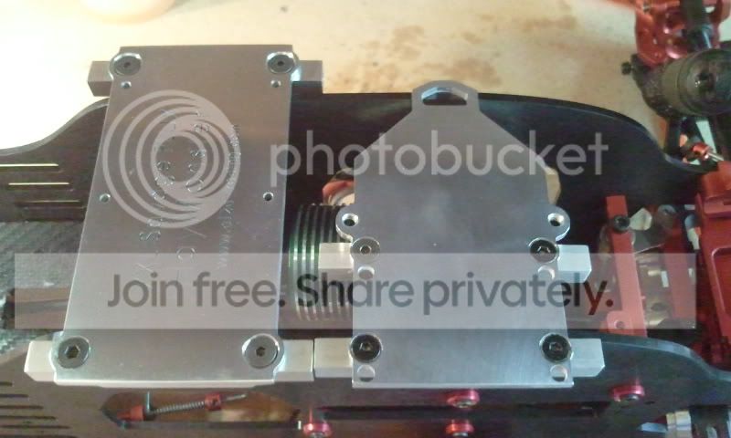

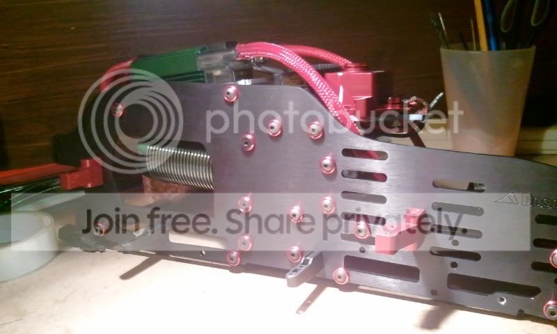

I have realigned the diff mount correctly now...

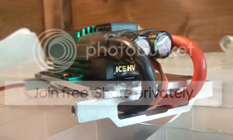

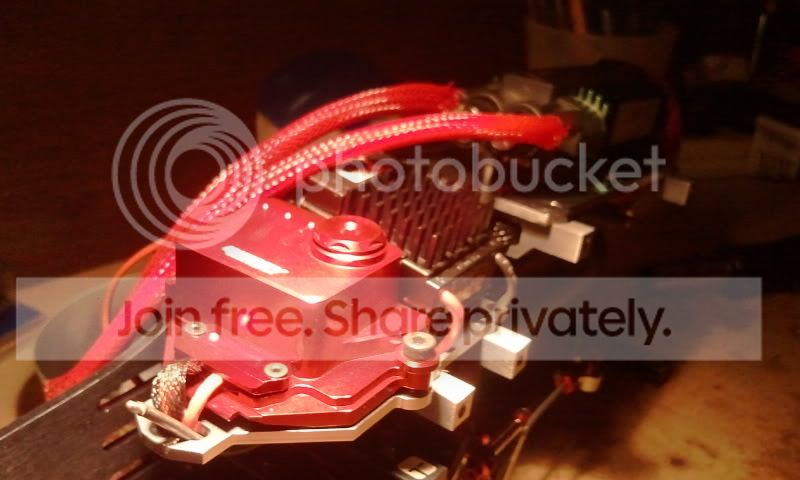

I just wanted to work on the wire mess that could occur if i don't get this right... So i wanted to see where everything would sit...

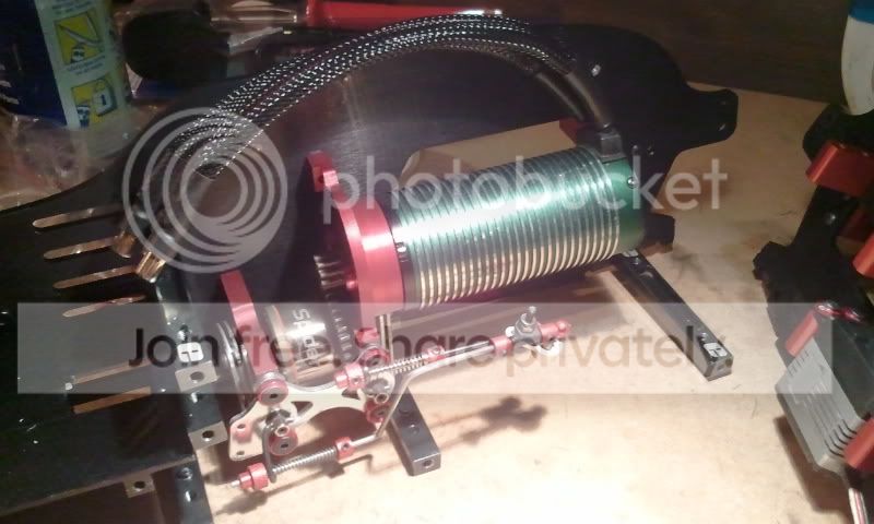

Some Wire Mesh to protect wiring.. .
BTW it isnt finished yet... So not all ends finalised

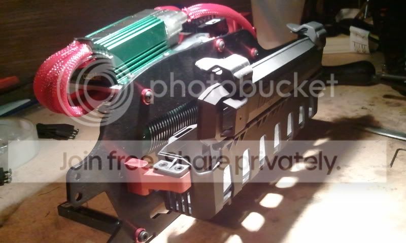

Black Mesh on Motor Wires

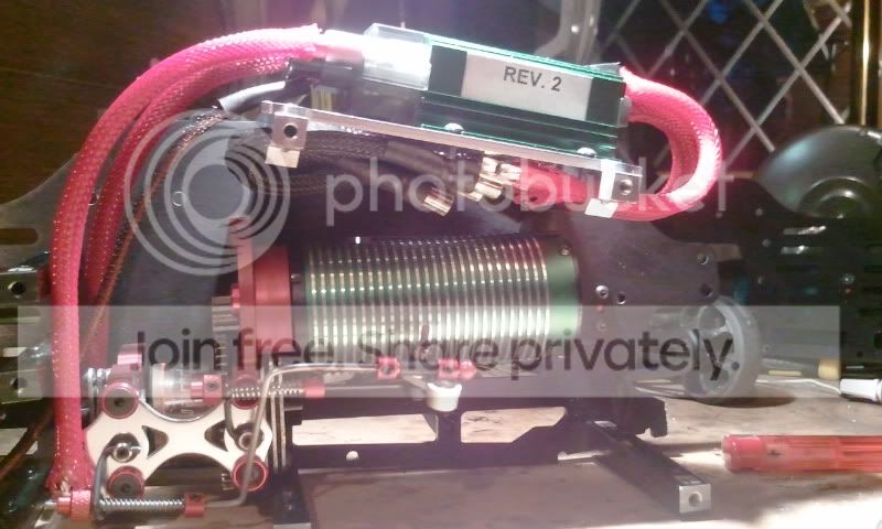

How ESC & Motor wires will eventually connect when i finish soldering of bullets.
How everything looks from below with the BEX and RX Case installed. _ servo wires obviously not pictured
Note the Wire Stay Holder at the front of the RX Box built into the plate. (THANKS DEJAN)

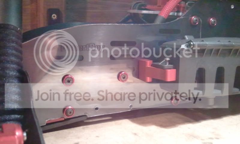

All Chassis drilling done and how it looks with Battery Box Mounts.
And One more

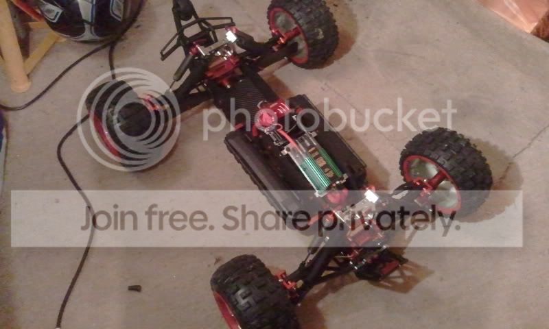

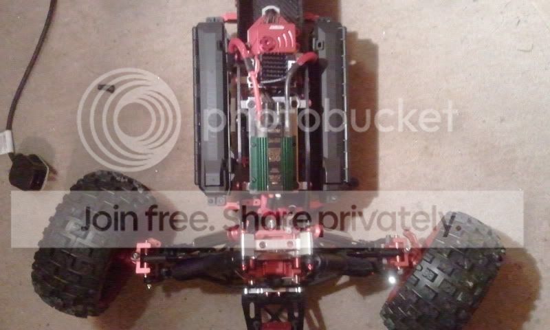

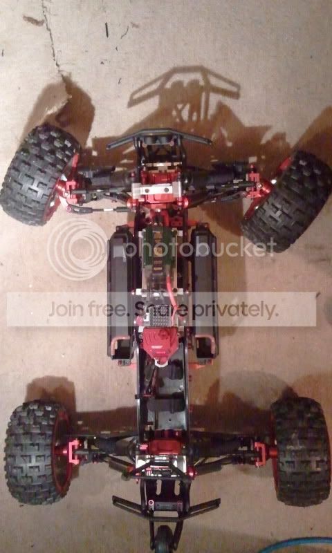

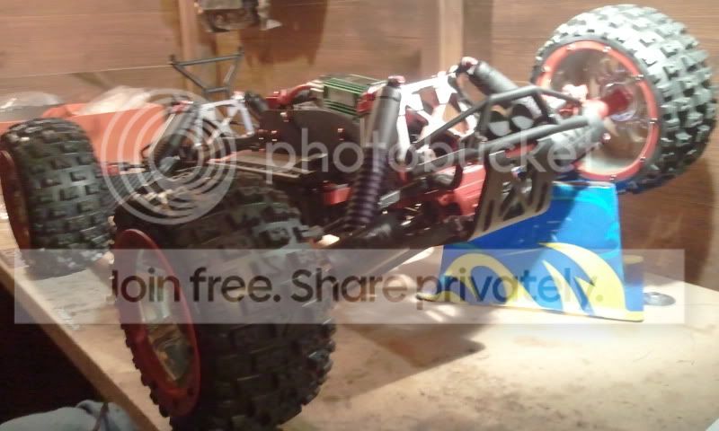

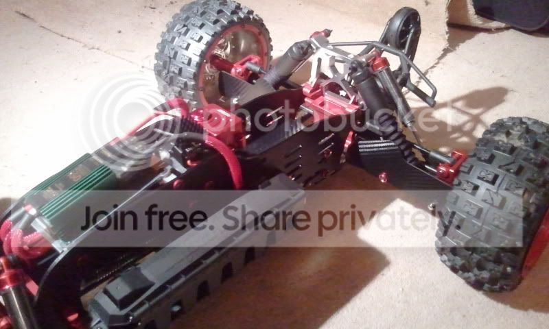

Here are some more pics as it comes together
Directly From above
Steering Throw.

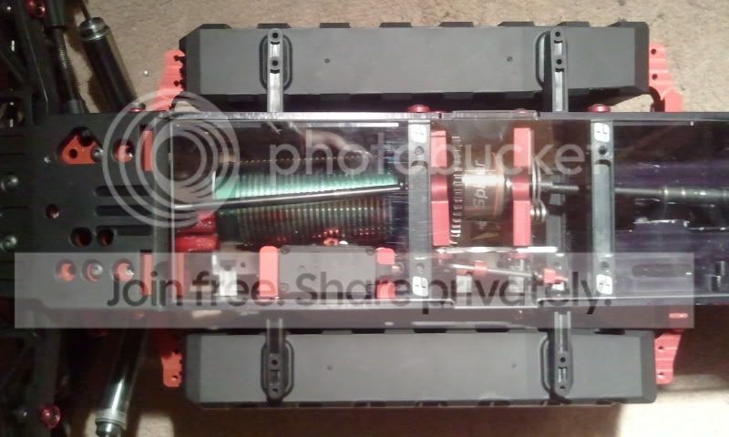

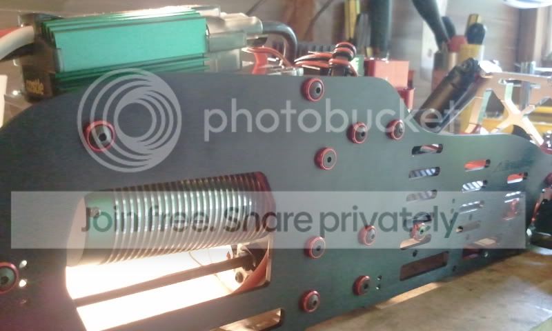

From Underneath... A little Upskirt shot 😉 through my see through skid plate made from Bullet Proof Material! Shows off my internals nicely and will make fault finding easier if i have a prob with my centre diff
The Rear end is completely finished
So Close!!!

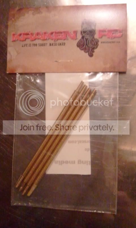

I received my new REAL TITANIUM Suspension shafts from Rob at KrakenRC!
http://www.krakenrc.com/index.php/products/products/view/2/10
These look awesome, and are extremely tough. Definitely tougher than stock from what i have felt, and for people that stilll bend the Alloy BigBore Shock TI COATED Steel shafts, you know what to upgrade too now 🙂

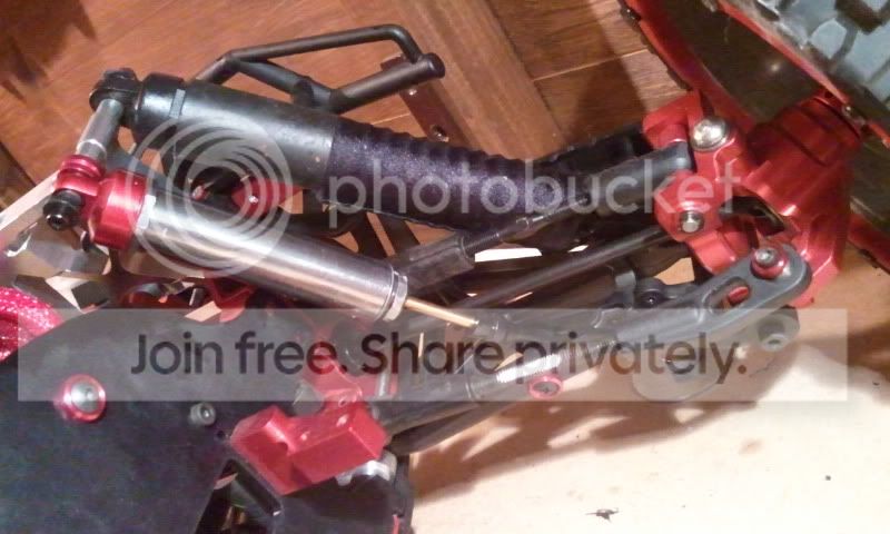

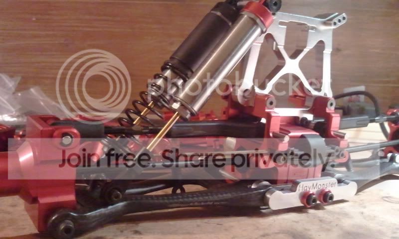

Some nice pics installed showing i still get great travel with my shocks.
Rear Shock

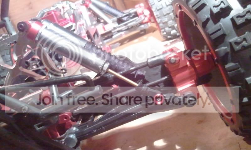

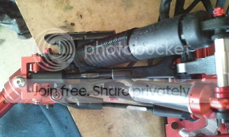

Front Shock - ------- Note it isnt installed in usual lower a arm location!------ info below as to why...
WHY HAVE I MOVED THE FRONT SHOCK and Removed the sway bar? Because i wouldnt get full steering throw without so.
Only the front sway bar has been removed. I will have to see how it handles without it. I'm hoping the large offset hexs will save me here.... Only time will tell.
Where the Shock Is now sitting on the lower a arm (sway bar location) Notice the Shock with the black sock using the original fitment position.
Steering at full throw. You can see how the steering rod end connecting to the spindle, requires the space where the shock end would be fitted to reach its full throw.
So now i have moved everything, and i am getting full throw... I should have great steering
