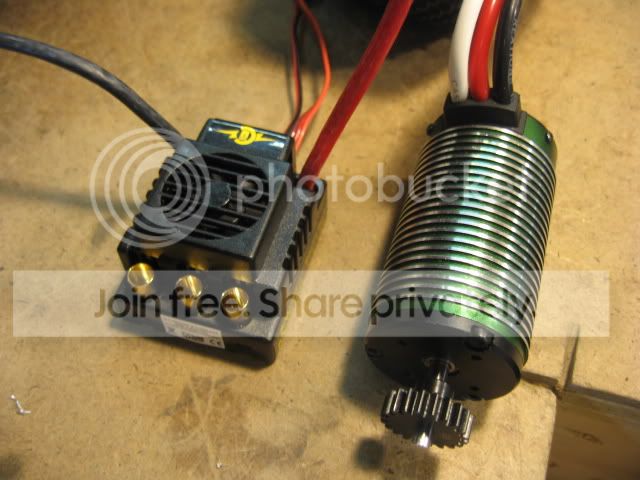

Ok well the MMM is in and my other parts from ebay.

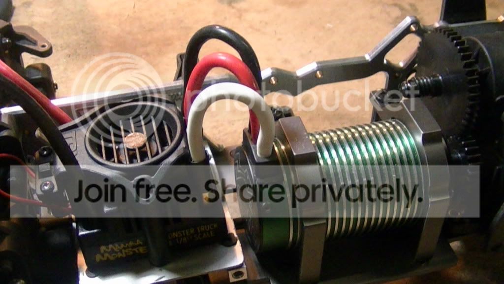

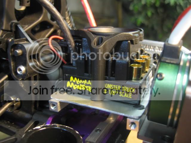

Now I need the TRX ESC mount since i located the ESC in the rear by hind the motor. Enough reading picture time.
• Castle MMM 2200

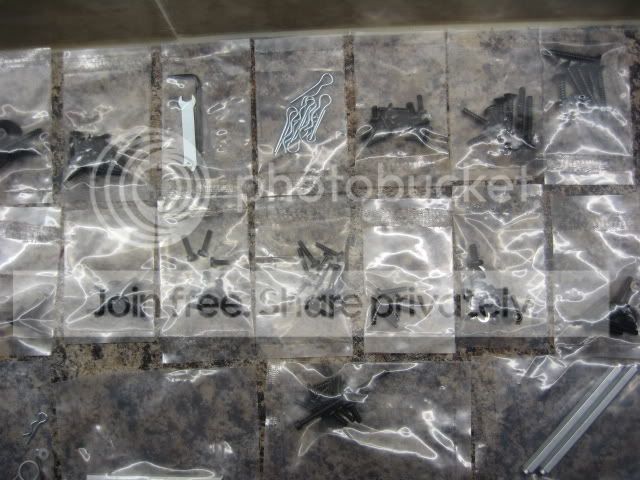

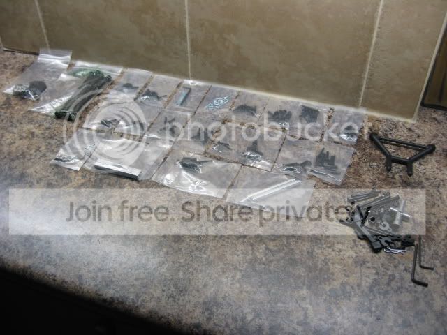

• XSS Screw set, 44t spur gear and flux axles (found out they don't fit the STD hubs)
• Top view of the screws, $8 for all of them

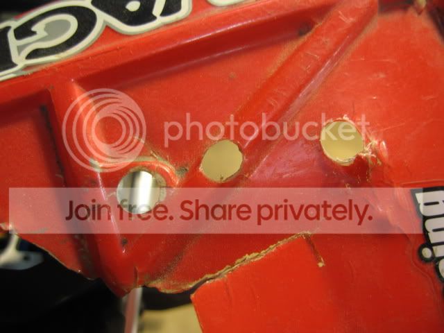

• Came up with a brain fart

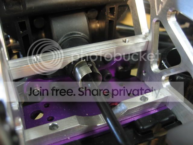

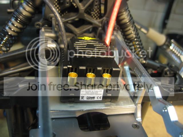

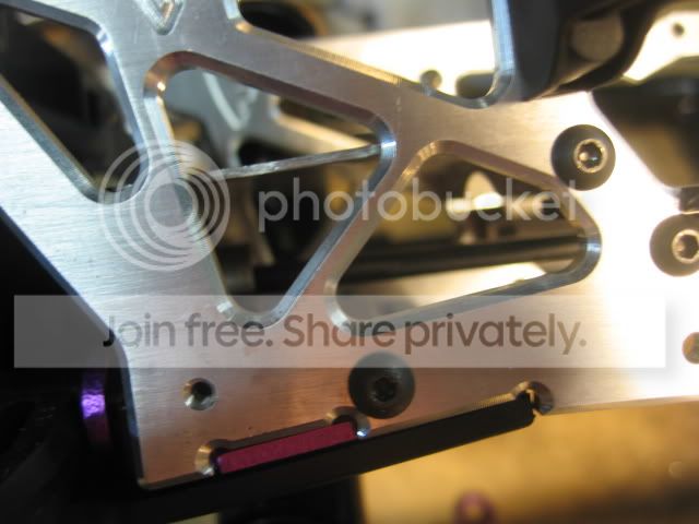

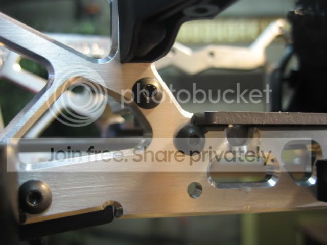

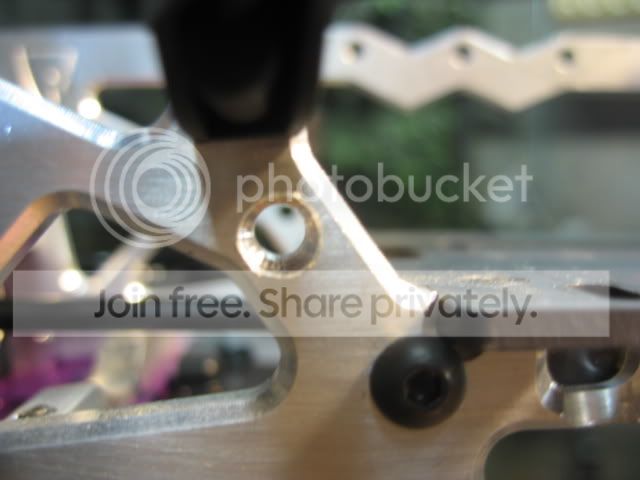

and made a rear mount for the esc. Drilled out a hole that was already in the tvp

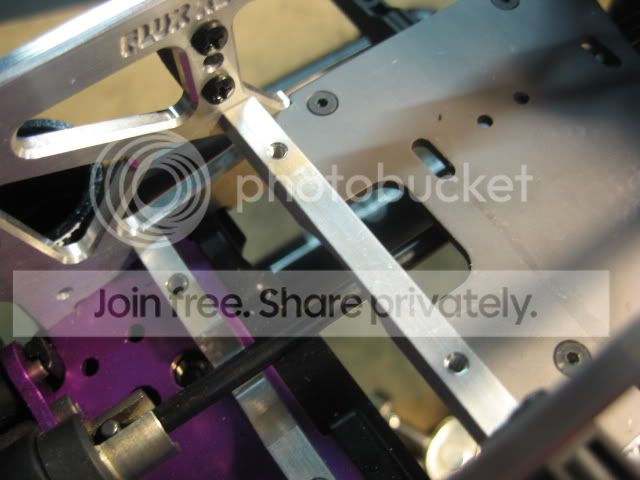

• used the engine braces that came with screw kit

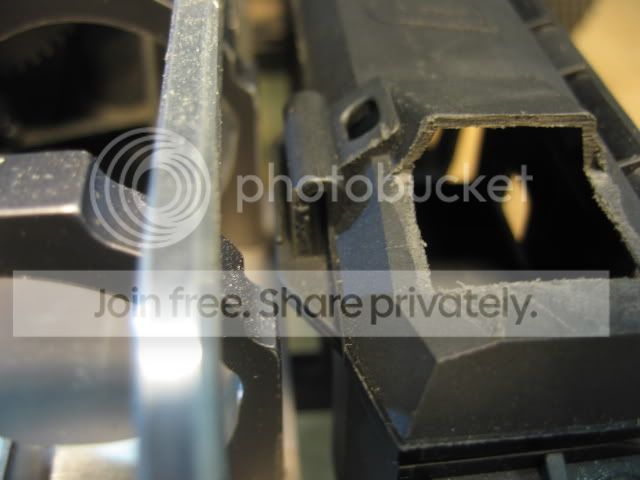

• Clearance with the rear brace
• Drilled 4 holes and used 4x 3Mx10mm flat heads
• Like i said before i need the TRX esc mount to mount the esc
• Clearance from mount to drive shaft
• Pretty nice fit

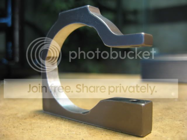

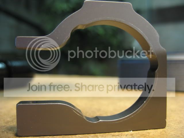

• and for the HPI motor mounts i called a machine shop
and they will charge me $10 to bore out my mounts to the required inner dia to kit the MMM can

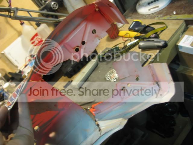

• This body has seen better days.
Ill be running this on the flux till i can get some throttle control 🙂

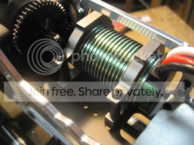

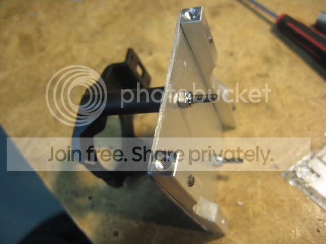

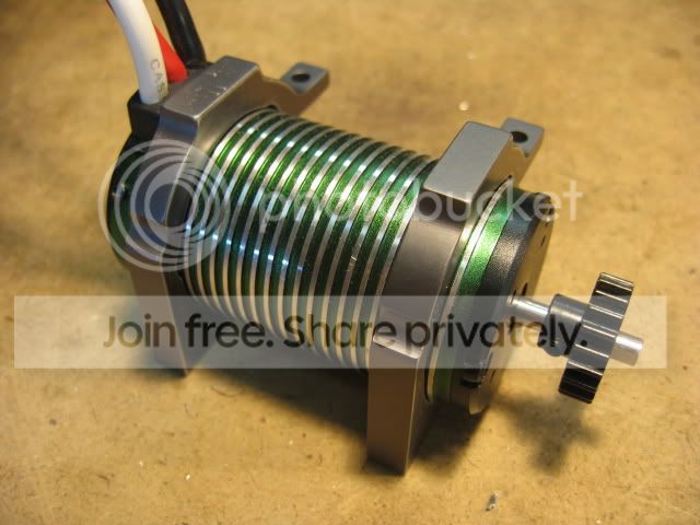

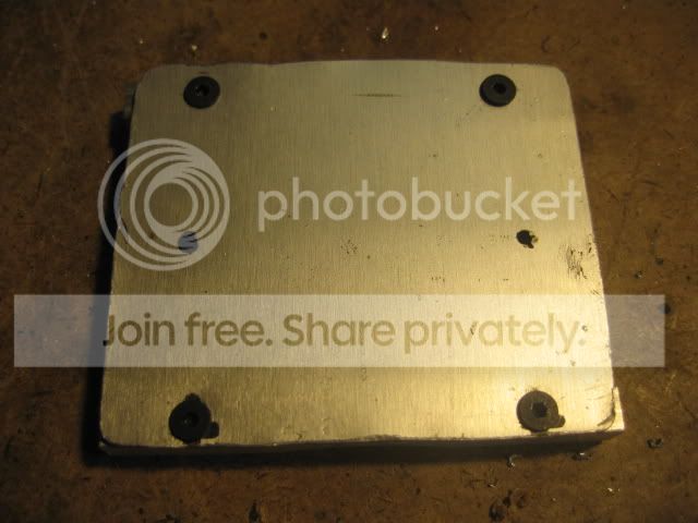

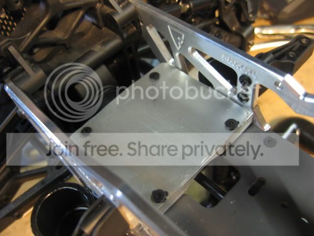

• Here is the mount i got milled. Not in a million years
would i be able to get a clean cut like that with a dremel -
• Perfect fit, no slop -
• Motor and mounts in the flux -

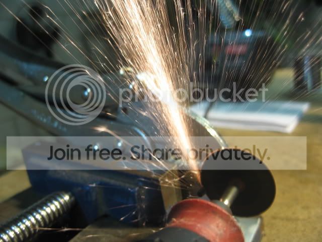

• SPARKS 🙂 Here I'm shorting the screws that mount the esc mount to the plate -

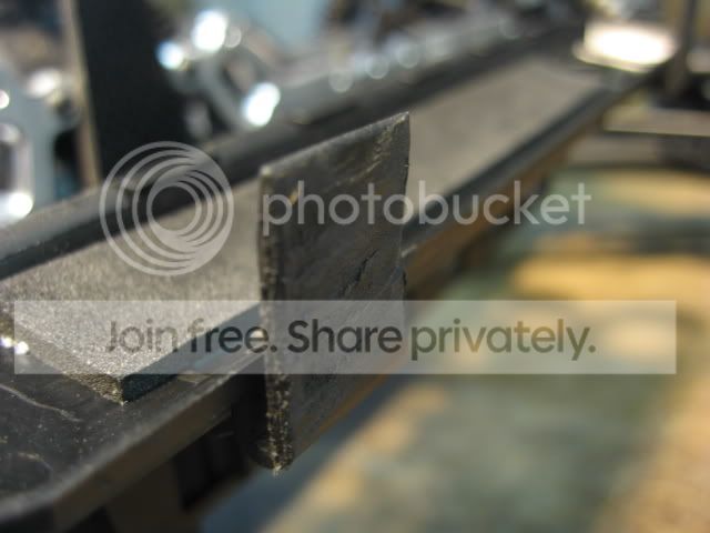

• Shaved the tabs off the battery box tabs as i flipped the
boxes around to get more room and i wouldn't be able to fit my fingers between
the boxes and tvp -
• Shot from the side, ill be using 2 Velcro straps on each box -

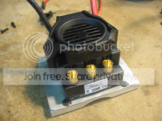

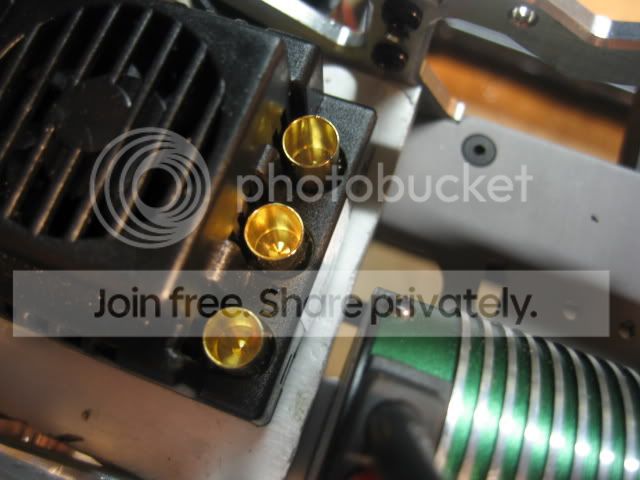

• The TRX esc mount came in so i drilled the holes to mount the esc -
• Looks pretty good 🙂

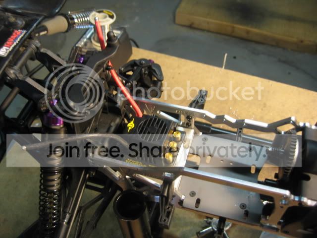

• Heres the esc mounted -
• Plate mounted in the truck -

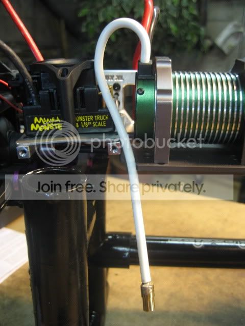

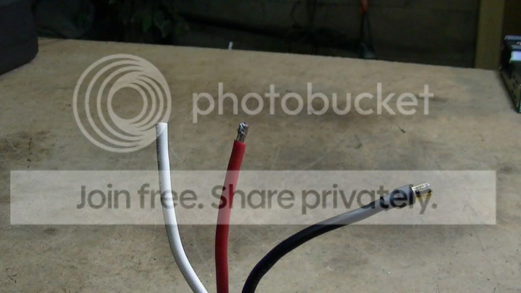

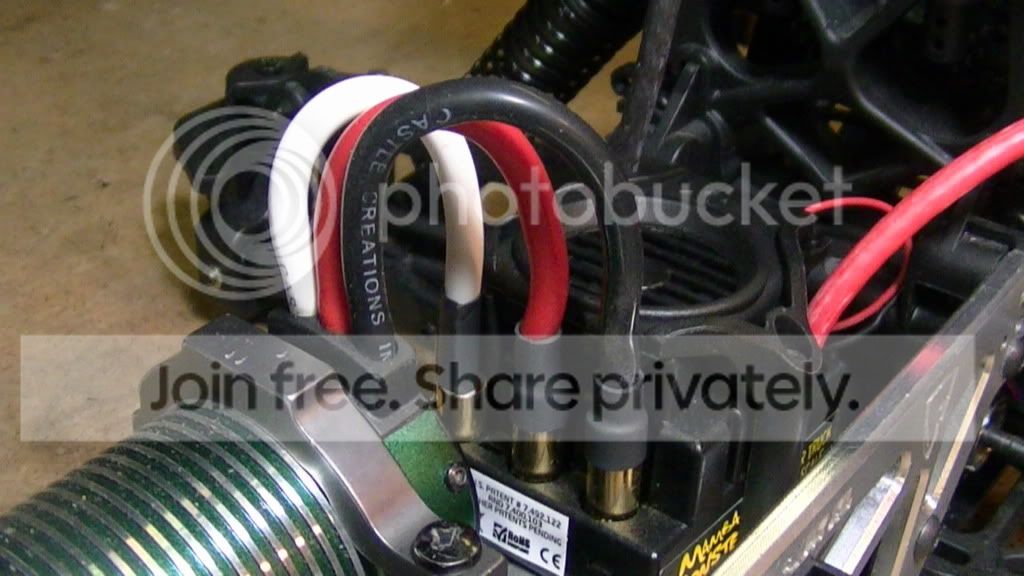

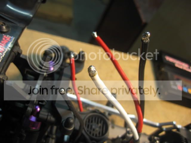

• How long the motor wires were -
• How short they are now -

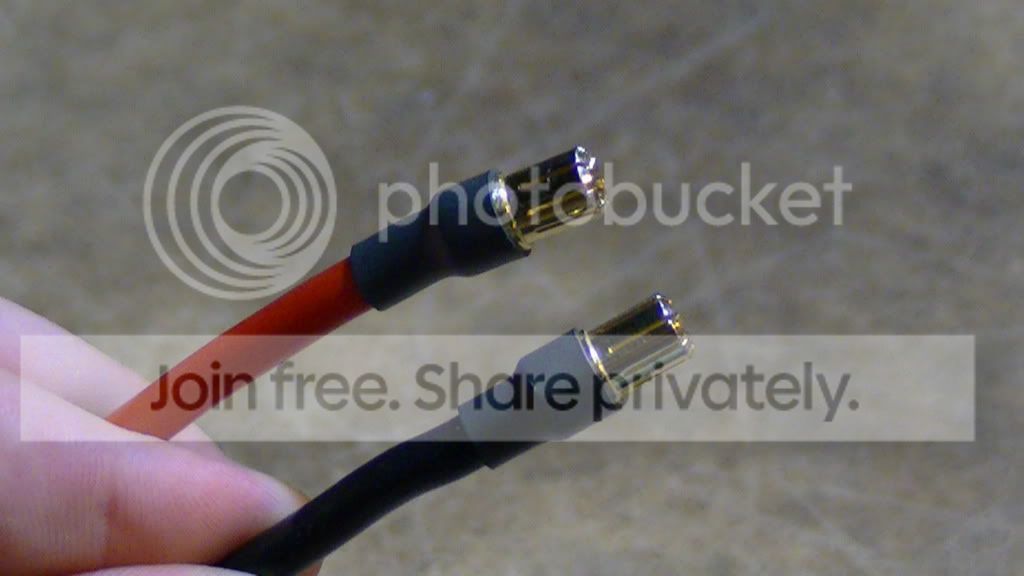

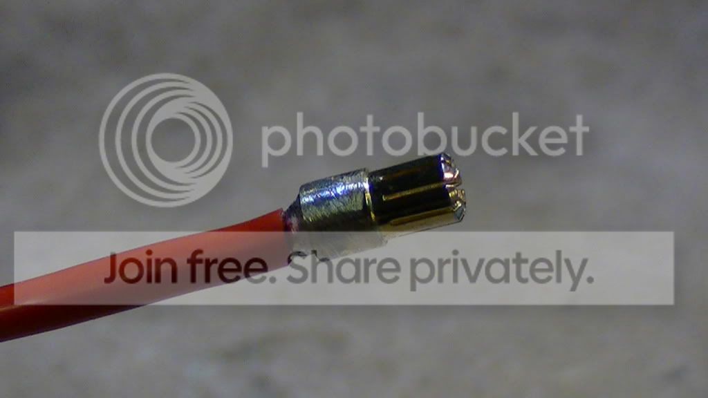

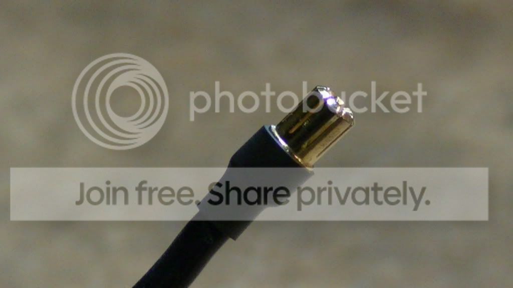

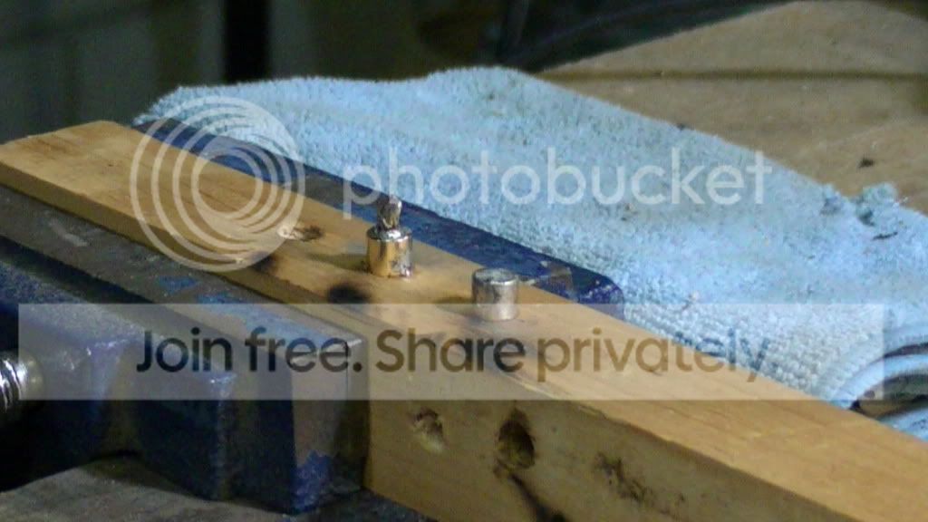

• One bullet connector on -
• Close up, shinny 🙂
• Used a 1x1 piece of wood to hold bullets while i heated them up -
