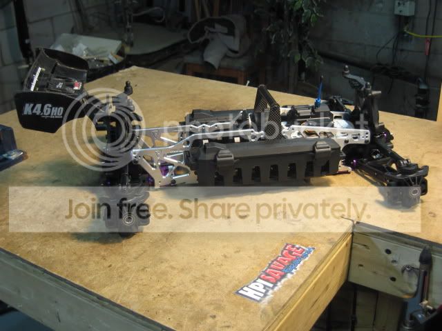

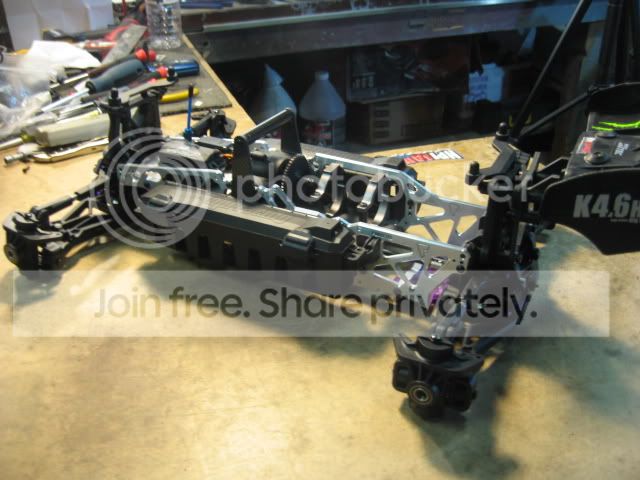

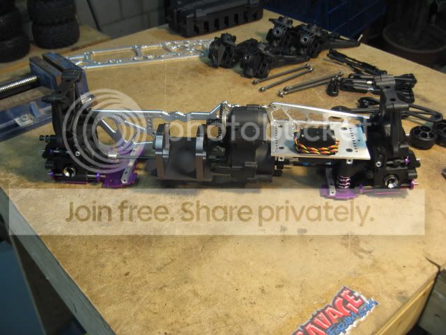

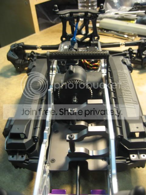

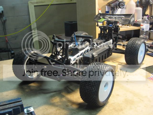

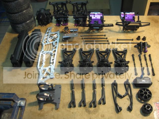

• FLUX in pieces
• Aluminum Big Bores
• Front end

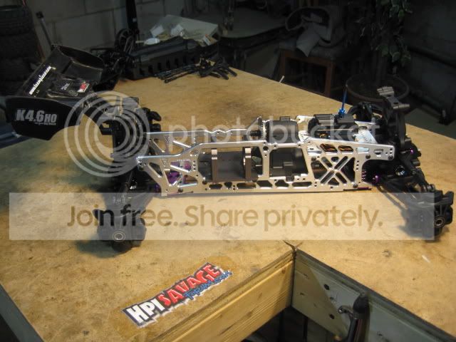

• Rear end, Motor mount, trans and front end mounted
• Close up of the motor mount
• Both tvps on
• Receiver Box & Servo
• Battery boxes and Roll bar mounted
• Closer look at the boxes, trans and mount

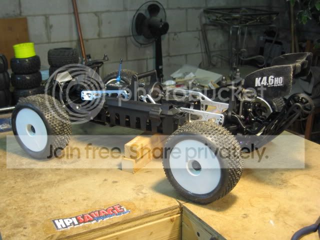

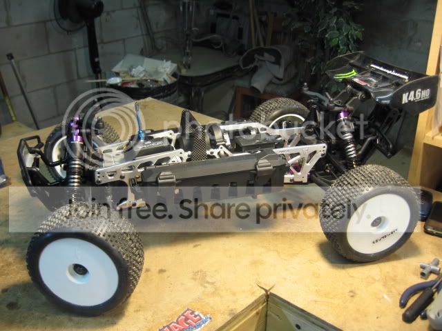

• Side view
• Side view with tires mounted
• Front View
• FLUX with the TX
• HYBRID FLUX FTW !!

What batteries and charger are you going to start with? Looking real good.
ive been wanting to see the flm flux plates they look kick butt
now you can mount your esc inside the tvps behind the motor.
sweet truck, the kidd.
sweet truck, the kidd.[/QUOT
What does the esc mount to Frddyj?
2x 2s 7.4v 5000mah 40C Blue LiPo
2x 3s 11.11 5000mah 40C Blue LiPo
Thunder AC6 charger.
Thanks for the kind words Fred.
Yup they look pretty sweet, they might be replaced for PRC in a few months.
and yes once the funds come in ill be getting the extended motor mount, servo plate and ext tvps.

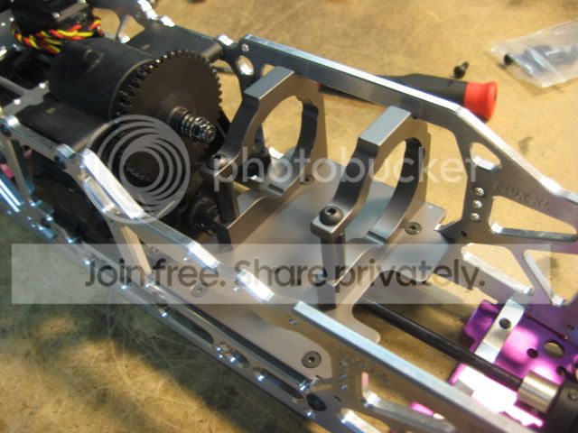

Brandon, would the prc motor plate work with the flm tvps?
if the flm tvps are xl length (and i think they are) you can get the prc extended motor plate. its extra long and you can simply wire tie your esc to it behind the motor like bank did.
i have the ext prc's so i didnt have the length back there to fit the esc so i used a flm cross brace and bolted to it. came out kick butt & very well protected back there.
using the ext motor plate back there is about a zillion times easier.
Fred can you post a pic of your esc set up ?
I'm curious on how do you did it.
Like yourself, at this point I can not afford all the prc so I thought that motor plate might work well with the flm xl tvps?

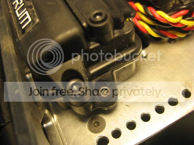

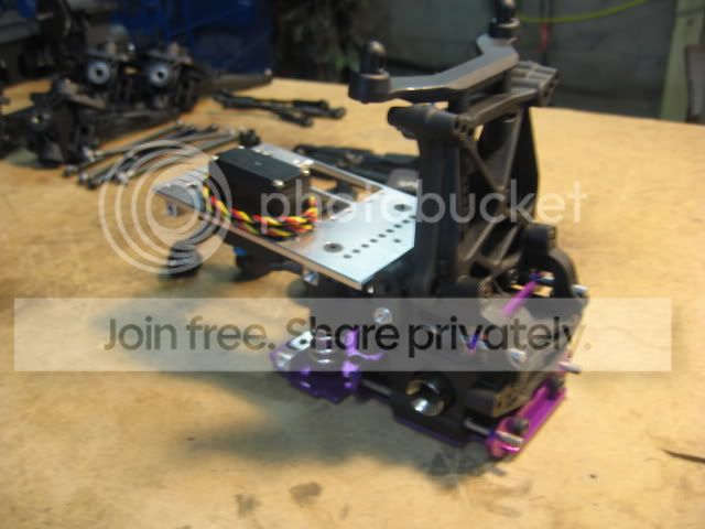

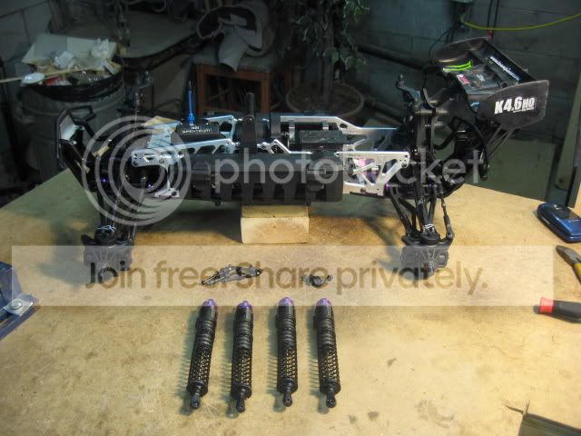

ok guys i wrenched on the savy a little more. Nothing big, mounted the big bores, mounted the receiver box, and made a PVC stand :)

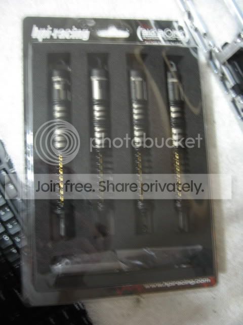

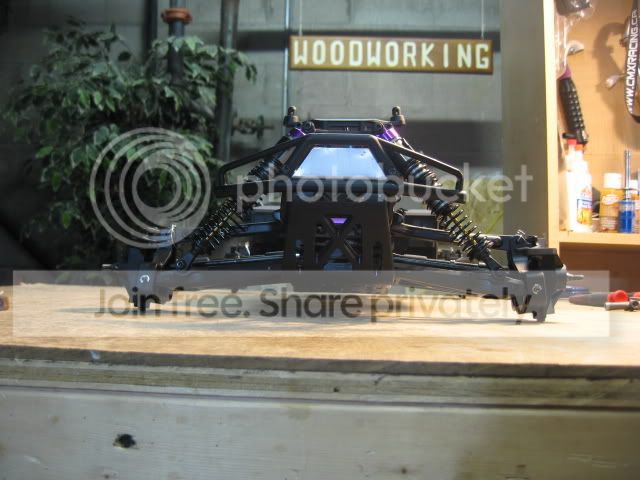

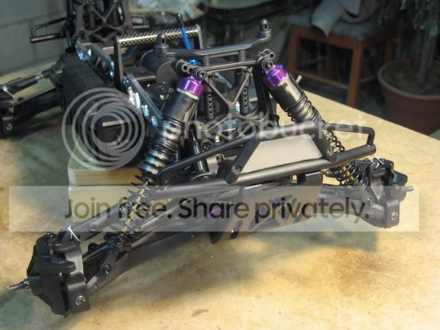

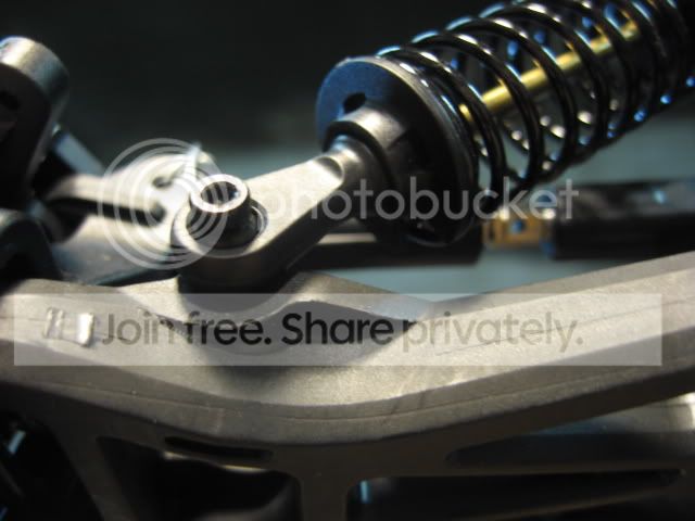

• Front shocks mounted

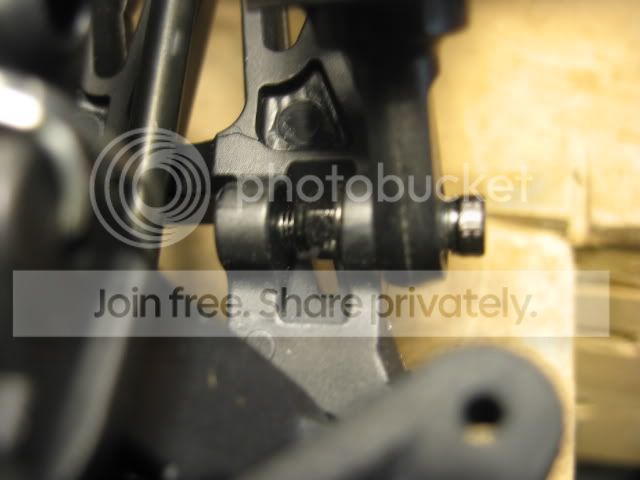

• Mounted the shock on the outside of the groove
• Used a M3x20mm and 3M lock nut
• All done :)
• Believe it or not i didn't even fill the big bores yet

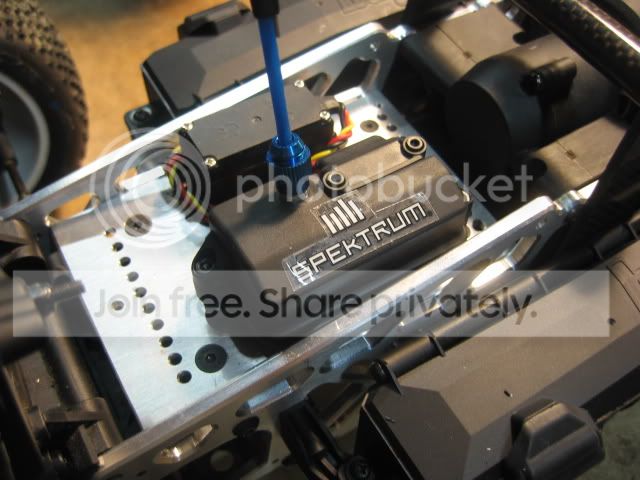

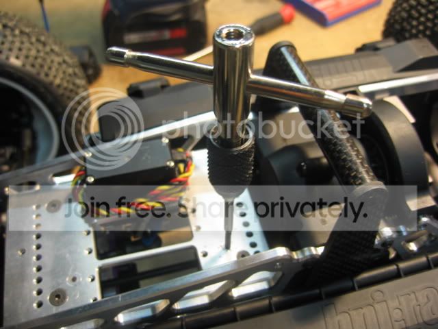

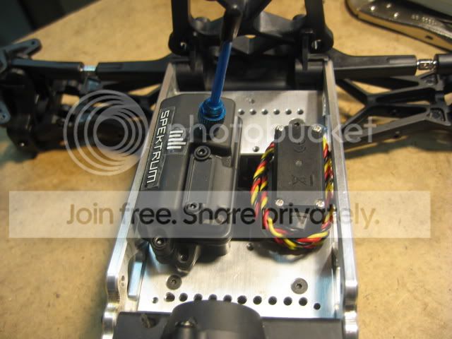

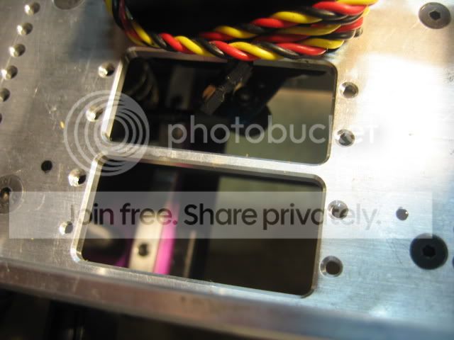

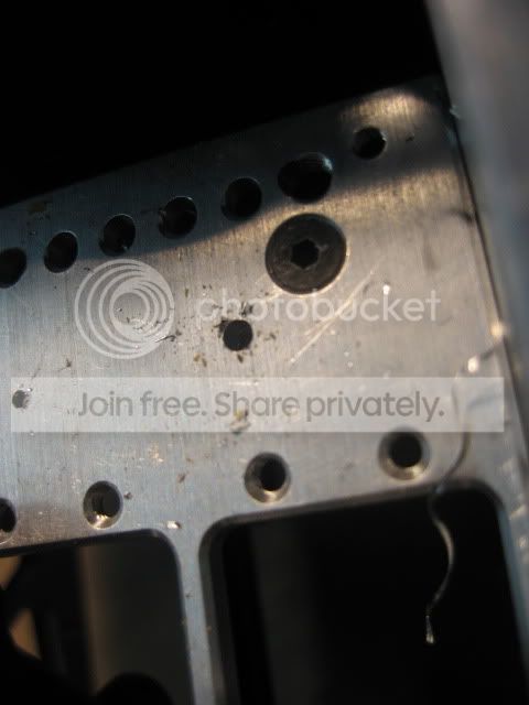

• Marked the holes for the receiver box
• Drilled them out with a 2.5mm bit
• Tapping the hole out to 3mm
• Mounted
• How it's mounted M3x15mm button head

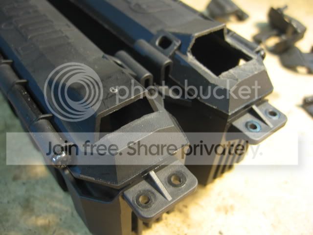

• Did the battery box mod, just need some fuel tubing to go around the inside

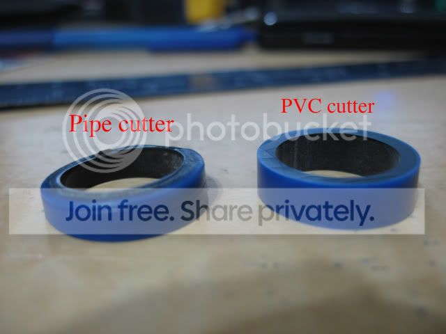

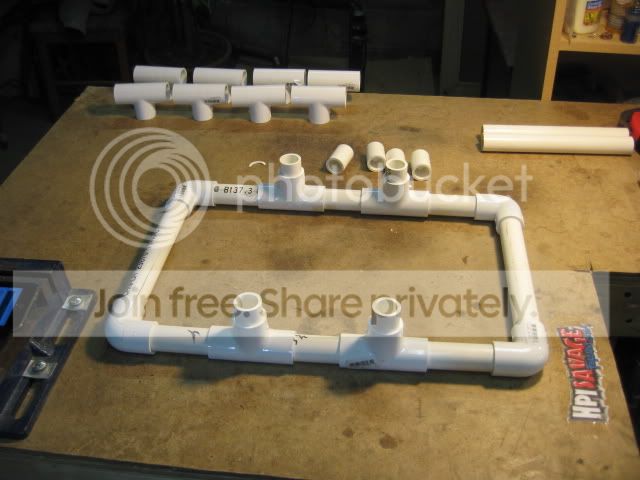

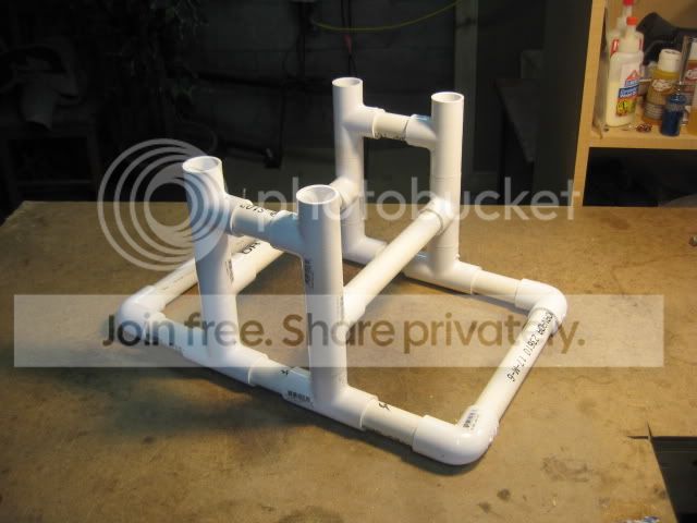

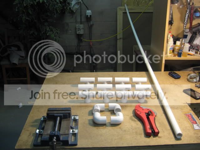

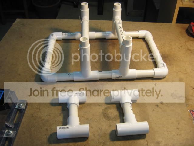

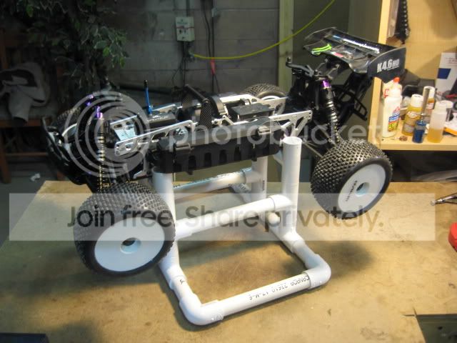

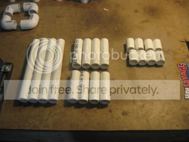

• Got the stuff to make the PVC stand (they only has 3/4" PVC so i got that. Total came to $12 and i got the PVC cutters for $25
• Cut the pieces to size
• Fits good

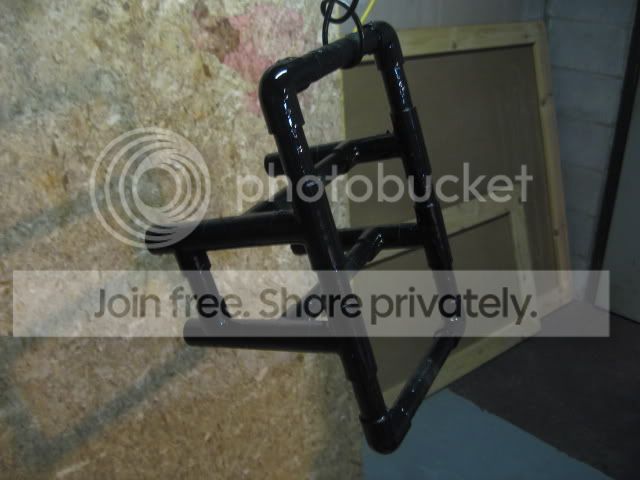

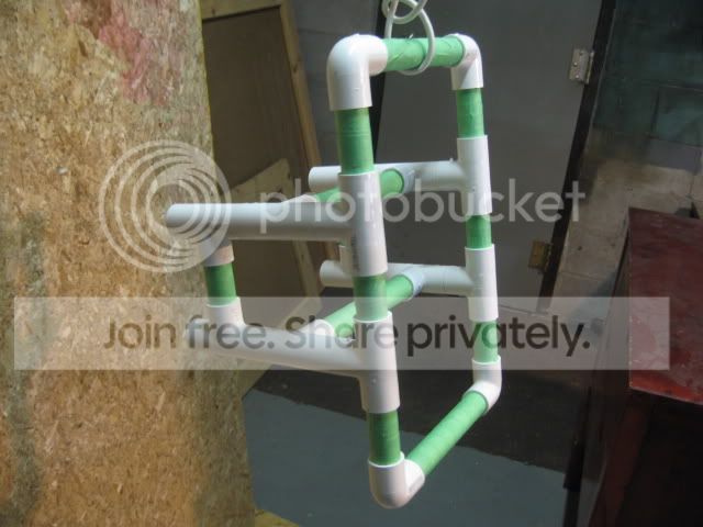

• Masked off the parts i was going to paint red
• But it was going to be a pain in the arse to mask the black off and paint the white red so i painted it all Black
• and to finish it off here is the difference between using a pipe cutter and using a PVC cutter

The esc will be in the stock location for now. When the funds allow me i will pick up the prc ext motor plate to mount the esc behind the motor.

When i started the build i said by spring, winter isn't even over and i have 90% of it done. Yea i'm saying around 13 LB by the end with motor and esc.
Looking good Brandon!
Do you have any pics of the clearance on the shock and upper a arm?
Did you use the stock mounting on the tup of the shock? I can't really tell in the pics.
You must have a good pvc cutter, with the one I got from Home Depot I get a squarer cut with my hacksaw.
Keep it coming bud!
Keep it coming bud!
Thanks Texas, I'll bet a pic when I get out of bed lol.
Yeah the PVC cutter I got was $25 reg $60 there like scissors really sharp blade on it I cut my self a few times just by touching the blad. And yes I used stock mounting on the top.
