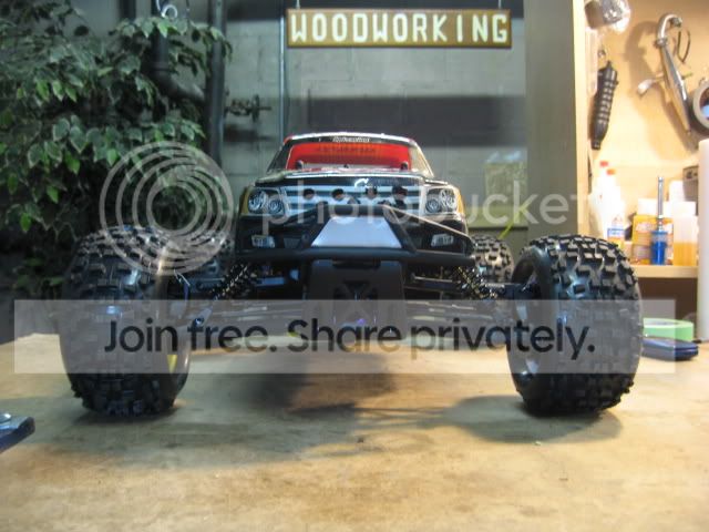

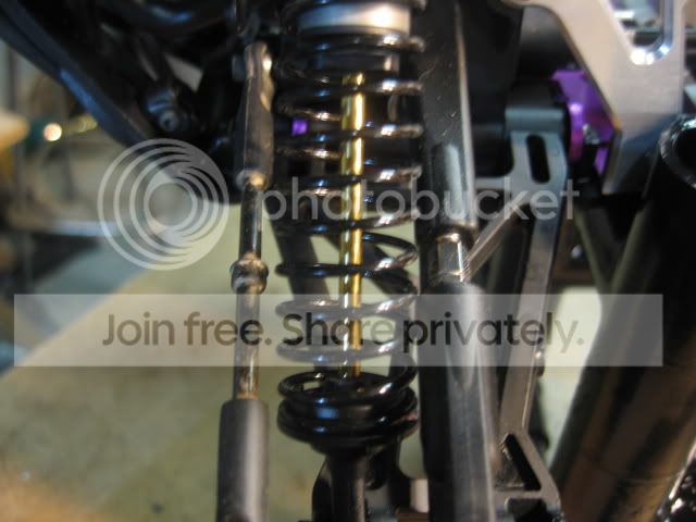

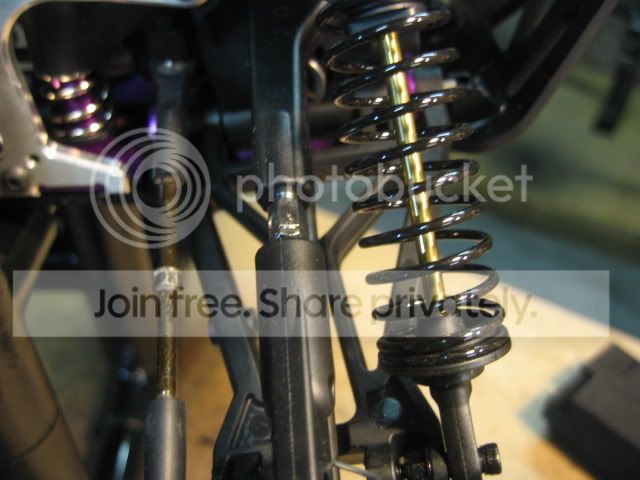

Do you have any pics of the clearance on the shock and upper a arm?
Did you use the stock mounting on the tup of the shock? I can't really tell in the pics.

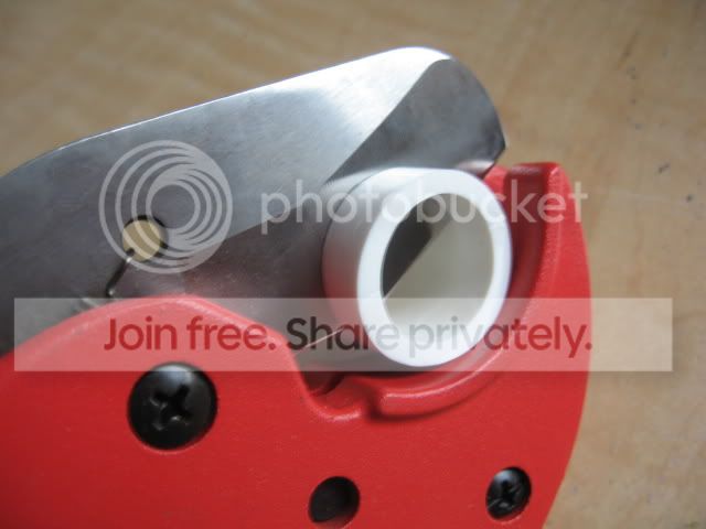

You must have a good pvc cutter, with the one I got from Home Depot I get a squarer cut with my hacksaw.
Keep it coming bud!
Here is your pics Texas.
FRONT
REAR
Thought i would take a few pictures of the PVC cutter in action 🙂

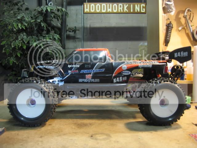

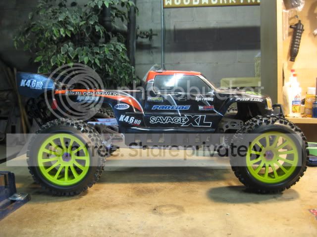

Need your guys opinion, which looks better?
** NOTE the yellow rulux's will be dyed black **
Half-up 1/2" offset Rulux's
1/2" offset Dish
Rulux's on the left dishes on the right

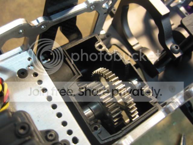

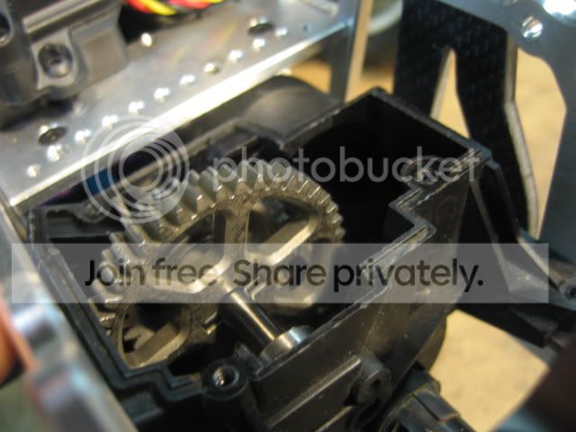

and here are a few pictures of the converted trans
I personally like the rulux better. I just got a set myself with badlands. Did you mount the bead on the inner ring or the outer? Kinda looks like the outer ring since the sidewall has the buldge. I mounted them to the inner ring and glued them and glued the to the outer ring also. The sidewall looks much better, and being glued twice, should never come off.
There is a inner ring and outer ring ?
I guess mine are mounted on the outer ring.
I like the rulux better too.
For some reason the badlands look to small with the dish wheels on the XL tvps and with the rulux wheels they look decent.
Can you snap a pic of yours ?
wow they look like there mounted on normal wheels haha.
Ill dye my wheels and mess around with them.
I also noticed the badlands stretched from being on the rulux wheels, i took the rulux wheel off and put on the dish and it slid right on with about 1/8" of play between the dish and the tire.
The bead on yours is sitting inbetween the lip and the inner ring. If you move the bead to the inner ring and glue it, the sidewall will still be tight on the lip and you can just run another bead of glue. It just gets rid of the buldge and looks a little better imo. I like this combo either way.
Yup, the rulux wheel are a little bit bigger. They are the same size as proline lpr. Set up like this reduces the sidewall for less side wall roll.
ok cool, learn something new every day.
I was going to sell the rulux wheels and go with the dish but now after seeing yours and understanding the wheel more ill keep them. Get some ritz dye tomorrow after work and ye the black.
I also have a set of dirtbonz on the rulux 1/2 ups. Those didnt matter where I glued the bead since they are much wider. They fit and look pretty good too.

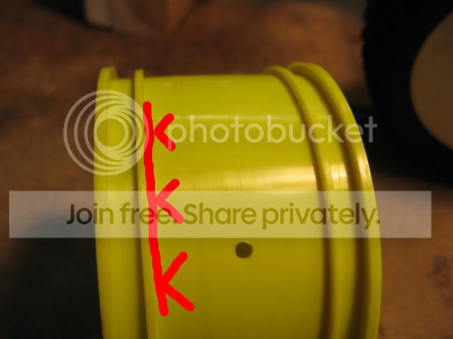

So just to make sure i understand this.
I put the bead along the "red" line correct ?
I just saw something really wrong with that photo, and i didn't even mean to do it. I wont say anything you guys have to fend for your self =P
Thanks for the pics! Putting the shocks on the outer lip sure makes a big difference (front compared to back).
I like the Rulux's rockout
Yeah for some reason the springs rub on the upper arms more on the front then the back. Ill be dying the rulux black when i get the ritz dye so they should look killer.
Yes I noticed that as well.

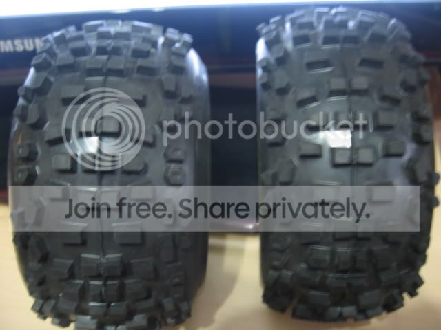

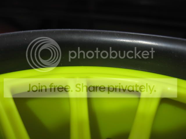

Ok Jeff i found some time to mount 1 tire on the outer ring and 1 on the inside ring.
• One on the left is outer ring one on the right is inner ring
• Inner
• Outer
• Width compassion | inner right | outer left
I personally think they look much better on the inside ring. But its your call. Thats why I suggested to look at it both ways so you can decide for yourself.
IMO i like the inner better.
Gives it more of a LPR tire look.
Ill grab some ritz dye and dye them black, and see what they look like after that.
The inner bead mounts will help in turning and accelarations out of corners. The outer bead will help on straights and normal straight driving.
