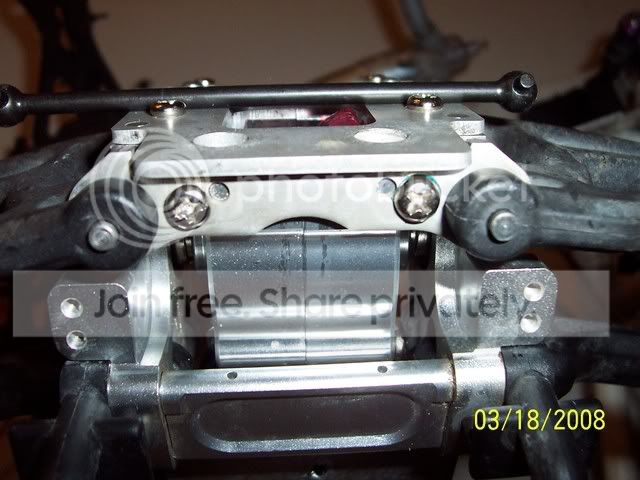

Crash, didn't you do the Cen diff upgrade? If so, you don't need to add "the dent" under the ring gear. I noticed when I did my upgrade that the cen diff ring sits inside the diff housing. Just some info for ya.
Thanks Extreme,
My cen upgrade is only halph done. Its on the shelf rite now on hold.
I got busy with makn skids, porting and rebuilding my nephews Rustler.
Crash, here is a pic from when I had my truck apart so you can see that the Cen ring gear clears the plate. Best pic I could get.
THANKS
