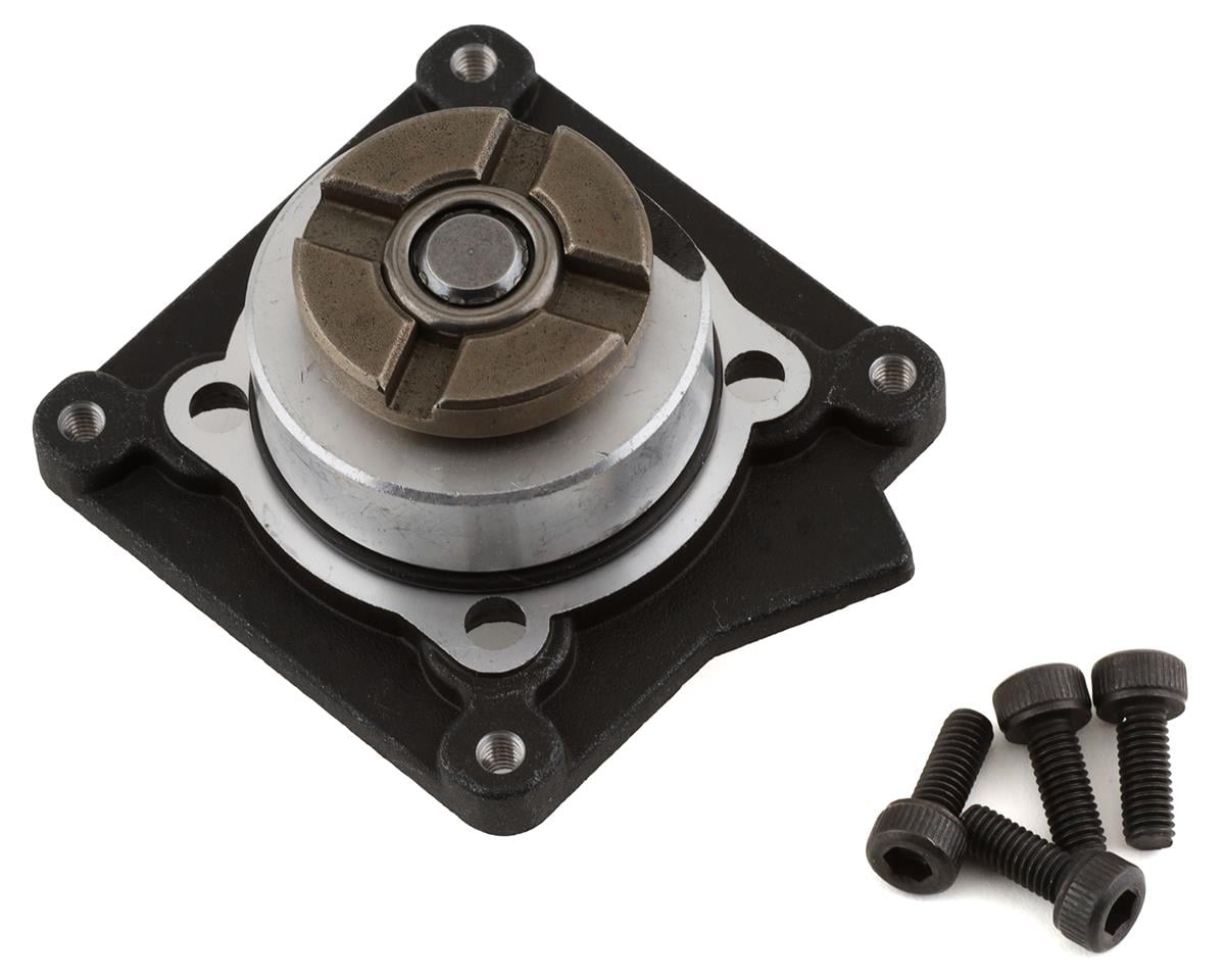

What you have is just the starter housing. You don't have a backplate. The housing has a top half and bottom half. The 4 holes on the starter match to a pull start type backplate, which has 4 holes to bolt it to the crank case and 4 more holes to bolt the starter too.
Like this:
I see now. Nice pic. so if i get a backplate for this particular engine it may fit. Which i need anyway. Thanks for that.
Cant find a backplate available anywere. Need the one-way bearing too, but that one i found on eBay. Anyone know where to find one or a similar backplate that Will fit? ?
That rotostart will fit once you get the sh pull start back plate
The rotostsrt uses outer holes on the backplate and the backplate used the inner holes
