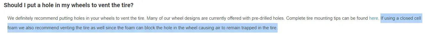

I think the reason to do it is centrifugal force. Naturally, the stuff inside the tire is trying to go to the tread of the tire when spinning. Basically when you vent the tire instead of the rim you are working with the laws of physics instead of against it (as far as getting water, etc, out).
Also, per Proline's website:
7174
7175

well centrifugal force will tend to throw water to the tread side and I know ProLine recommends cutting holes into the tread face, they after all manufacture and sell tires and a torn tire will need replacing and if you have a set of 3 due to one tearing you will of course buy another to complete the set..... I still vent the rim....

Can't force others to take good advice. The person in that video is not the only person doing it. In fact, it's relatively commonplace in high power, big tire setups. Go take a swing by the Arrma Forum if you don't believe me.
Tin Foil hat ????? HUH ???? so now you mocking me???? if you don't think tires tear at holes cut into them then maybe you need to go into the real world and see just what can happen, I saw a guy throw the whole foam insert setup out that small hole he cut into his tire, he was wondering how he was going to get it back inside the tire so I am just stating what I know another occasion a drag guy actually has a tire just explode off the wheel and all we can figure is it split where it was vented and just threw the whole thing off the wheel while the sidewall was still glued on the wheel, but maybe that is not what is wanted here by some guys... Tin foil hat INDEED!!!!!

Oh wow!! So, it seems like a good idea then.
