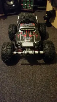

Theres still a few orig parts left...😉
* hardened F&R diff centres
* hardened axles
* 10mm axle extenders w 17mm wheelnuts
* full set of plaig sealed bearings with ptfd lube (inc gearbox and steering)
* 25T pinion gear....testing 17-21
* 45T hardened main gear
* 36T hardened middle gear
* gpm red alloy lower a-frames F&R
* gpm red alloy adjustable top arms
* gpm silver alloy castor/steering knuckles
* high strength steel ball joint ends/ steering turnbuckles
* 20kg waterproof steering servo
* gpm silver alloy steering assembly with 4xbearings
* titanium servo arm
* 6mm dia drive shafts
* gpm silver alloy F&R diff housings
* big bore alloy shocks and springs (1xF, 2xR)
* custom 30mm hardened plastic "wheelie" with 2 x sealed bearings
* stainless steel F&R skid plates
* custom front bullbar
* 4 x headlights w high output cree directional leds
* 2 x driving lights x directional 4xsme leds per light
* 110mm lightbar with 12x sme leds
* 4 x red led tail lights
* fibreglass wrap on main power leads
* standard side rails painted white
* diffs running 10k wt oil + ptfd additive
* LiPo 3S 11.1 1300mah 35C battery for lights
* running 5000mah 2S and 5000 3S
* JBL bluetooth speaker
* Proline 3.4" black wheels and trencher dirt tyres
* custom roof mounted "roll tyre"
* Spektrum dx5pro and 2100 receiver
