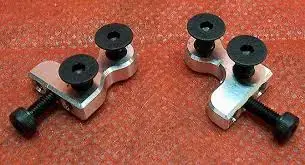

What all did you order? Cause if you wanna relocate your steering servo like I did you'll need flm servo mount brackets.
Ok, I ordered the servo plate, new tvps and the motor mount. Good call on the mount brackets I'll get them coming. Do I just need 2?
