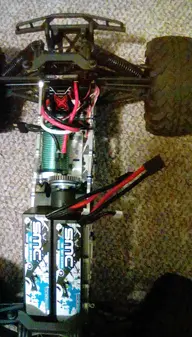

I used the flm ext. HD tvps on my conversion and relocated my steering servo and put my batteries on the servo plate like tweaked did works great!
Hope this helps some they are the lcg ext tvps

I was able to locate most of the parts. I still not sure about the mounting of the steering servo. And the ESC mount that you used. I'm just glad your willing to help.

I made my esc mount and I relocated the steering servo. It's under the servo plate mounted to the inside of the tvp.
What all did you order? Cause if you wanna relocate your steering servo like I did you'll need flm servo mount brackets.
Ok, I ordered the servo plate, new tvps and the motor mount. Good call on the mount brackets I'll get them coming. Do I just need 2?
Yes unless you use the to mount a homemade esc bracket. I used a aluminum cross bar for my esc bracket.
