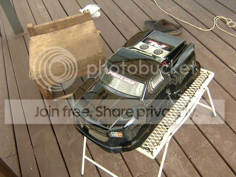

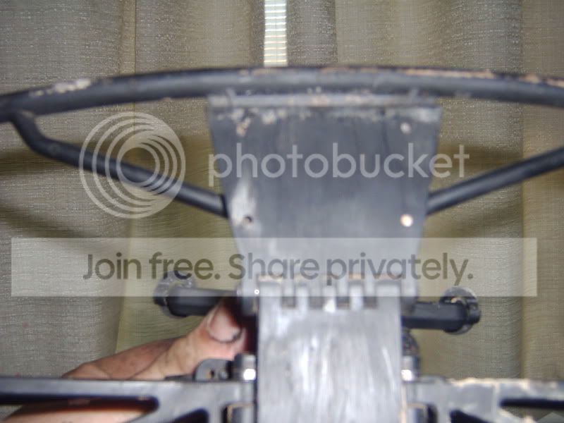

performance isnt to bad got it almost dialed in but bodys getting a little rough lol here are some pics

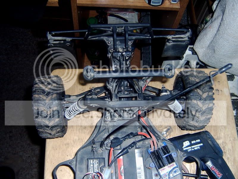

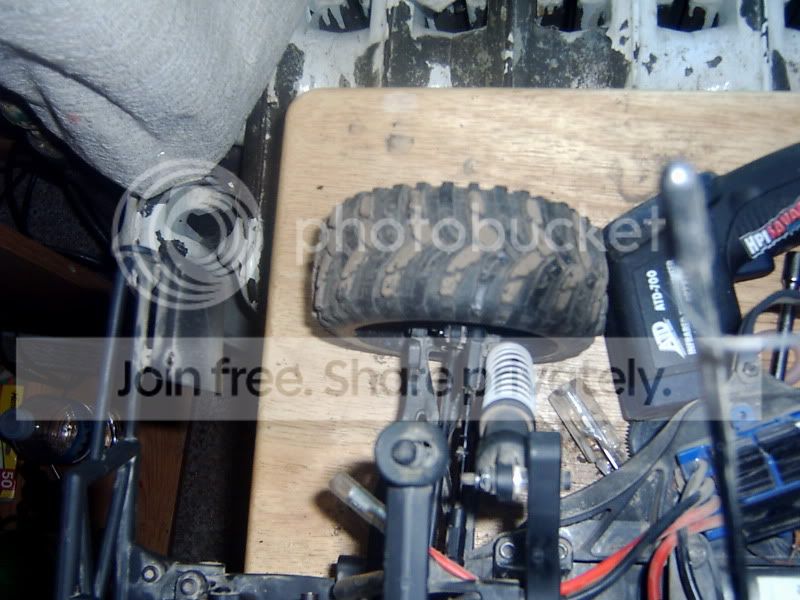

didnt like the stock tires so i took them off and put some proline bow ties on the rear of the truck then did some mods to the stock rear tires sience the pictures i have turned the tires backwards i figure they will be food for wet tracks

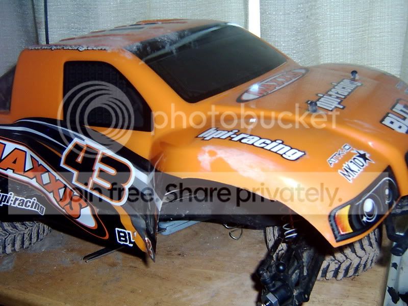

mines pretty much dialed in servo saver tightend down blue springs in front stock white springs in back 40 weight shock oil number a shock pistion on all 4 corners will be posting more things i do to it this coming summer for track running but over winter stuff will be getting slitley changed

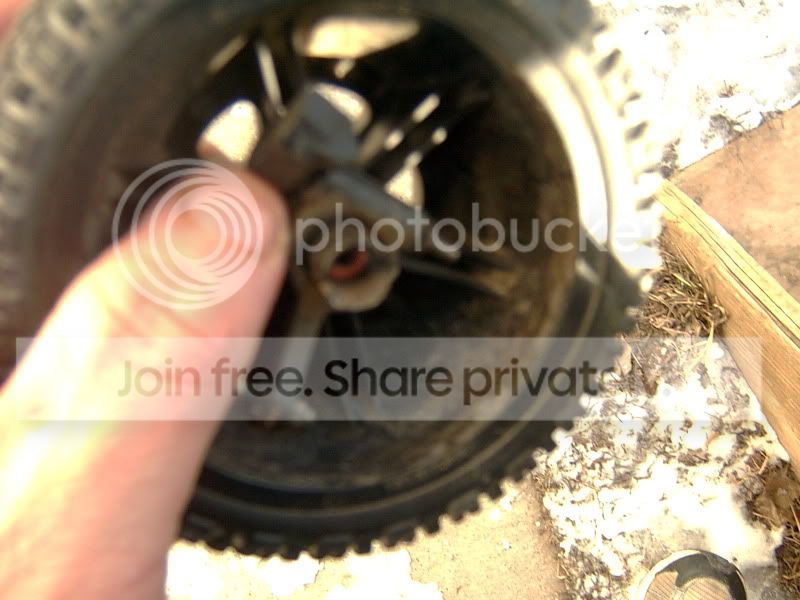

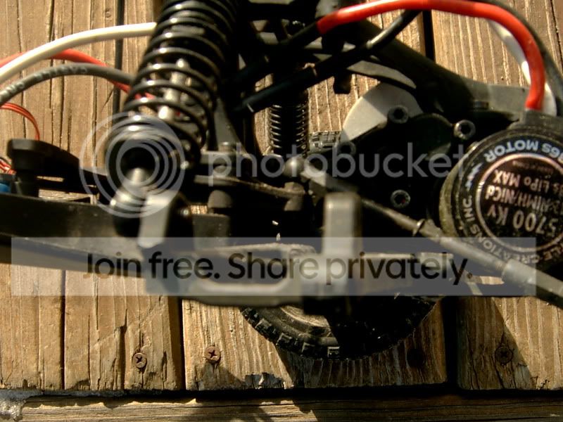

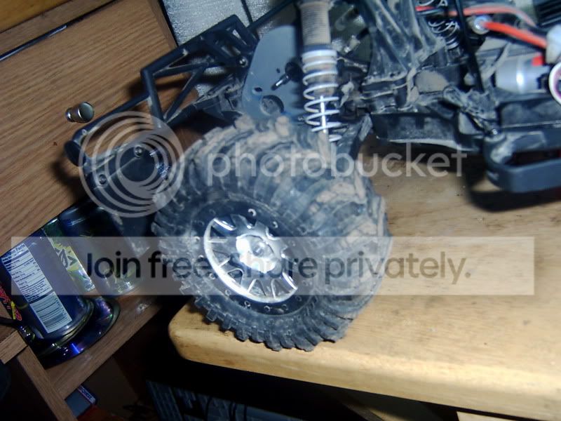

ok people i got the 5700kv system installed did some testing with diff settings in the castle link and got it going ran 1 and a half packs through it before i broke a lower rear a arn here is the carnage

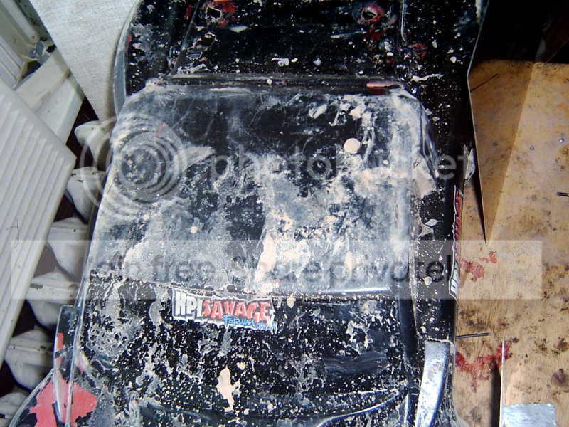

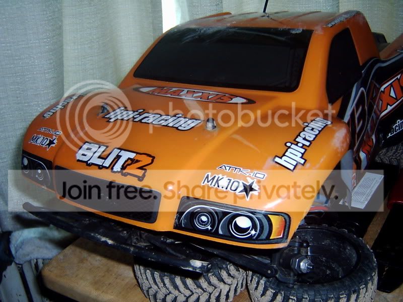

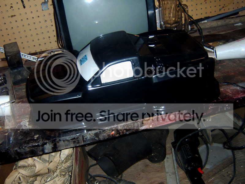

Well The blitz did good yesterday racing except it needs a new body and a little work not much got 2nd in B Main out of 12 and find out what i thought was a blown diff but was only a blown bearing here is 2 pics will get better pics when i get my good camera back if i would of known it was just a bearing i would of rain a main there was only 4 people who ran a main mod S/C
2nd on the right and 4th from before race on the left
good job ! keep it up. Next time you add stickers to take pictures make sure you add a lil dirt to them too. But A- for effort
