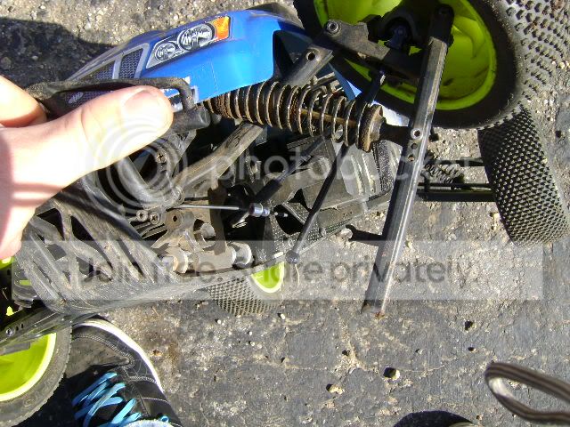

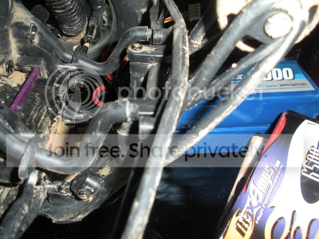

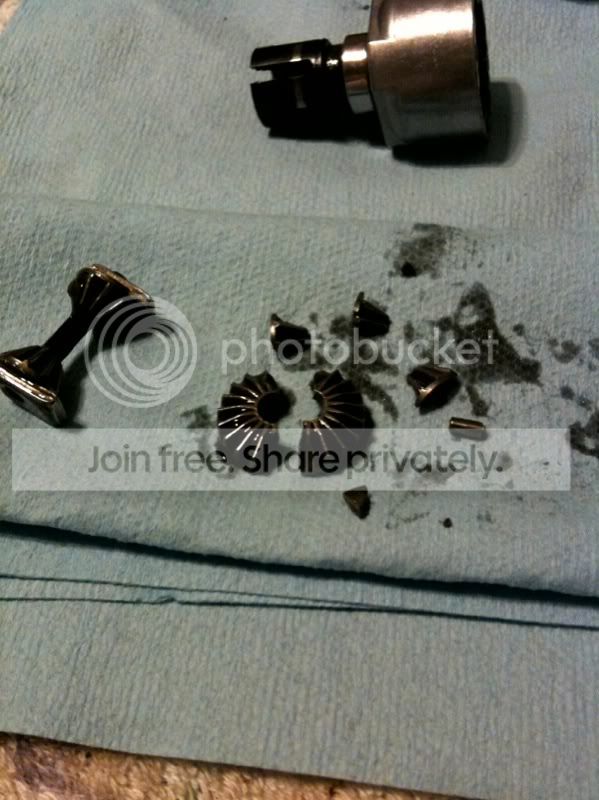

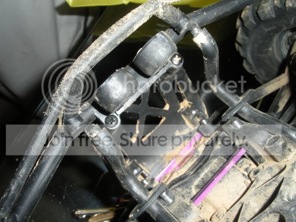

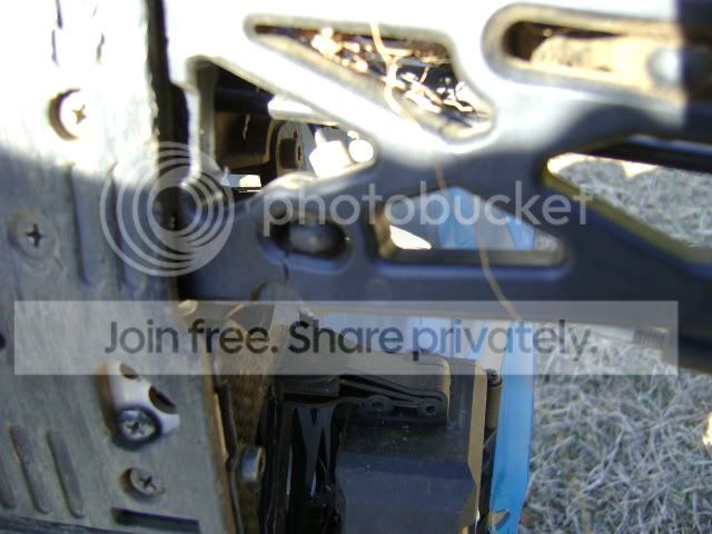

I broke both front and rear bumper mounts. the rear body post. my buddy bent a dogbone and blew up his rear diff. I will post pics of that after he sends (bulletproof diff)
lol, bumper mount screws don't count as damage. They're consumables, like fuel, filters, and glow plugs. I think I break at least one every other day out.
BTW, throw a couple zip-ties around the bumper mounts just in front of the suspension pin retainers. The mounts turn out in a wreck and let the pins slide out, which drops the whole suspension, then you have to spend half an hour looking for the pin and your dogbone. Don't pull the ties all the way tight, though; leave them slightly loose or they just snap.
Nice first break!

Did you actually blow the ring or pinion gear? Those are the only part of the diff that is "bullet-proof".

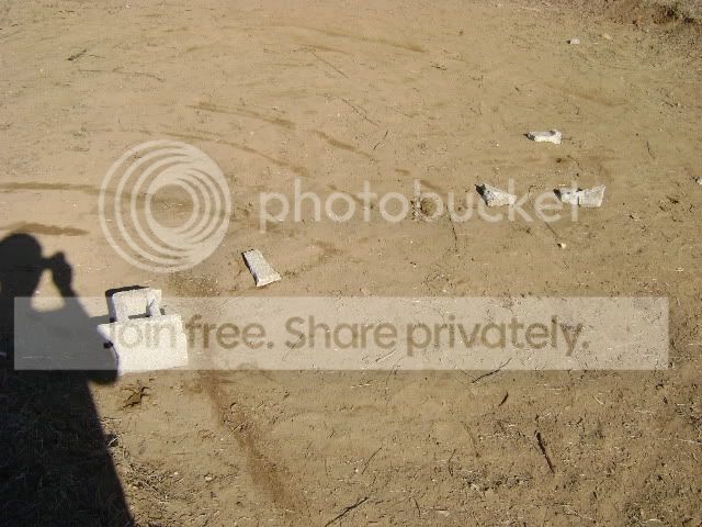

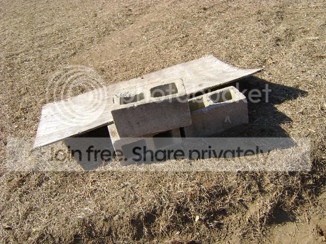

clear things up, mine broke on a bad landing. his broke by hitting the concrete block at full speed lol!

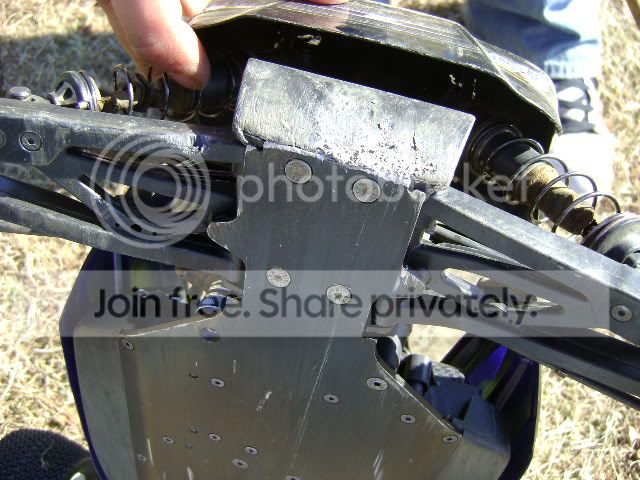

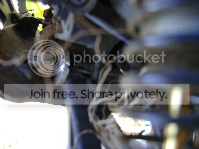

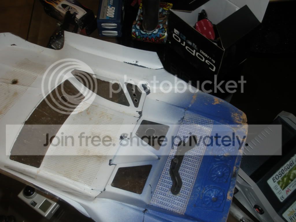

Bashing alittle with tons of room to run.. but i happened to find the only tree out there. Slammed right into it at WOT.
believe it or not.. LHS had all my stuff instock.. picked up hellfire alum shock caps.
Ouch
Been there bud. Trees and light poles seem to have magnets build into them 🙂
Good thing your LHS has you taken care of, it could have been alot worse.
