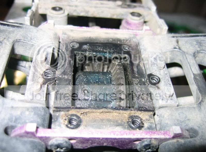

i didnt really even have to take the whole thing apart even
i think i found what was wrong
the little gear in the back which is kind oof out of focus is broken, right?
yep thats called the pinion.. it does look broken..... was the diff making any noise ? anyway thats the problem.. take the diff all apart, and also chack the small bevel gears inside the diff case
both the gears the, ring gear.. and the pinion gear are trashed and need replaced.
LOL that is true. but come on "bro" you have to admit you was having a good run of bad luck with diffs were you not?
I go through diffs like mad as well. Could be the amount of air SJ and I regularly find that has something to do with the diff failures. I have personally seen SJ's truck flying high and landing hard. He's a pro basher.
all Savage diffs will fit any other Savage...only difference between the one linked and yours is the diff case/bulkhead...it will fit, but replaces your existing case and bulkhead with a one-piece unit (and if you're lucky, it'll be the easy access case)

I would second that on getting a hole new diff assembly if you can. If you have access to ebay you can get a new compleat diff cheap just make sure its for a older savy and not a X diff. That would be the best way to go, its better than just fixing the old one, then you no everything is new in there and it insures that you will not have a prob for a while.

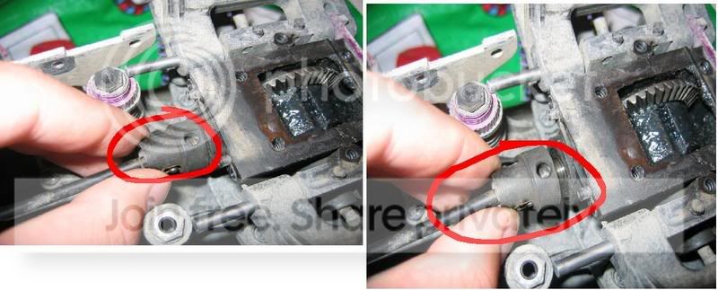

is this thing suppose to be loose like this?
mind you, when i drive, for some reason i don't have front wheel drive, or breaks?
what am i supopse to put in here to attach it to the other thing so that i have front wheel drive?
yeah you can loose those now and then. Chech them from time to time to be sure that they are really tight. A good set of hex driver tools helps.
