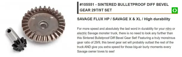

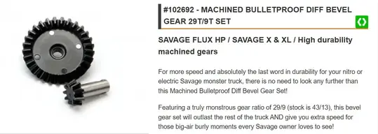

Sorry if I am mistaken but the flux v2 already has bulletproof diffs.1750241414520.webp
Sorry if I am mistaken but the flux v2 already has bulletproof diffs.View attachment 12411
As I said before: Calling all diff's "BULLETPROOF " is just a form of marketing. HPI sells three types of diffs: Sintered, Forged and Machined, Sintered being the worst ones, Machined being the best ones. Although the sintered ones come with the machined input gear... The XL V2 comes with the forged diffs.2.webp
As I said before: Calling all diff's "BULLETPROOF " is just a form of marketing. HPI sells three types of diffs: Sintered, Forged and Machined, Sintered being the worst ones, Machined being the best ones. Although the sintered ones come with the machined input gear... The XL V2 comes with the forged diffs.View attachment 12412

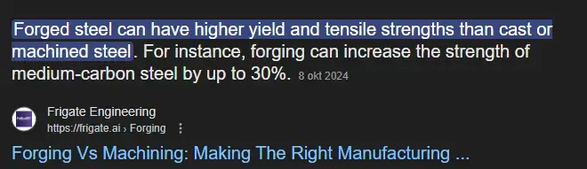

You sure?
I asked chatgpt and got this:
Forged steel is generally stronger than machined steel when we're comparing structural strength and toughness.
Here’s why:
1. Forged Steel:​
  • Process: Forging involves deforming the steel under high pressure, often while hot.
  • Grain Structure: This process aligns and compresses the metal's grain structure, which enhances its strength, fatigue resistance, and impact toughness.
  • Strength: Forged parts are typically stronger and more resistant to shear and tensile forces than machined parts made from the same base material.
  • Applications: Used in high-stress applications like crankshafts, aircraft parts, and heavy machinery.
2. Machined Steel:​
  • Process: Machining involves cutting away material from a steel billet or forged blank.
  • Grain Structure: The original grain structure is retained or possibly interrupted by cutting; there's no improvement in strength from the machining process itself.
  • Strength: The strength depends entirely on the base material. Machining is for precision, not enhancement of strength.
Summary:​
PropertyForged SteelMachined Steel
Grain alignmentYes (improves)No
StrengthHigherLower (generally)
Fatigue resistanceHigherLower
PrecisionLower (as-forged)Higher (CNC, etc.)
Conclusion:​
If maximum strength and durability are your priority (e.g. in load-bearing or impact-prone parts), forged steel is stronger. If you need high precision or intricate shapes, machined steel might be the better option—often machining is done after forging to combine both benefits.
from my own research forged is indeed stronger.

It also would indeed make total sense to have their top product (hpi savage flux xl v2 which is 6s ready) to have their highest quality materials.
LOL.. yeah I went down that rabbit hole too. The machined diffs that are called 'bulletproof' also are stronger than the stock forged ones and are for sure an option for the X and XL... and at $40 a pop for each end they had better be stronger! Which reminds me I need to get working on that drive train!
I got a new typhon 6s and have been nerding out on that thing.. never had a modern buggy.. thing is a rocket!! I am working on steering blocks and carriers for the notorious and typhon as well as finally installing the new servo into the notorious!
What ChatGPT says might be correct, although it doesn't seem to apply in this case. I don't know the manufacturing process behind those forged gears from HPI, but in my experience the forged diffs are far behind in terms of durability when compared to the machined ones.
This is a picture showing two forged input gears, on the left, one with two months of use, on the right a new one, it's easy to see how much wear the teeth have on the used one.
Wish I'd taken photos of one forged input gear I took out of the front diff some years ago; the teeth were all gone...
Just to be clear, this happened while using the original 2200kv motor. Now I'm using the machined diffs with a much stronger 1650 kV motor, and after two years the gears look like new...
Also, the machined gears are way more expensive than the forged ones, so it doesn't make sense to pay more for less durability.
At the scale we run at, sintered or forged gears can't be better than machined gears, which are far more precise and efficient. The more precise the gears mesh, the less likely they are to fail.
For larger parts in automotive and aerospace, forging is used where maximum strength is required, aligning the grain flow of the metal. There is also minimal waste, faster production and lower unit cost (for mass production).
CNC parts take longer to make and have accordingly higher unit cost, along with more material waste. But they have a better surface finish. This matters with small gears. 👍
Edit to add: CNC machined/finished forged gears would probably be the best - if anyone makes them.
