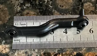

one part I can't find is the longer link for the XL which goes between the servo arm and the bellcrank ... it's longer than the one for the X and has a step down in the middle... I guess I an just measure it and find something that length in alum...

@r3v3nant
What part number do you refer to please?
Hey it's the link by 85058, the little bar.. but that's not the right part.. this looks like the diag for the X or non v2?? the XL has a longer link, please see the photo I attached to my post about this... Thanks!!
edit: it's the arm in
Savage X FLUX V2 STEERING SET (BELL CRANK) XL servo saver & Posts HPI 160101​
https://jennysrc.com/products/savag...et-bell-crank-xl-servo-saver-posts-hpi-160101

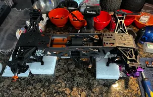

Got some work done.…
EDIT: noticed my upper arms connection at the hub needs to be flipped to stop shock spring rub..
the rears are coming tomorrow... my c-hub orders got split into two... tomorrow for the steering stuff too so should be fun!
some of the e-clips were kind of a pain but got a method down now... I used some blue loctite to get the play out of the steering knuckle ... and I had to shim the 5mm outdrive at the bearing on the outside to get all the play out of that.. it was pretty sloppy until I shimmed it.. luckily I had two shims for those perfect size.. I ordered some more so I can do the rears the same way.
it'll be a while before I get my alum turnbuckles for the front and back.. lucky those are easy to swap out once all the other stuff is done ...

It’s AAAALIVE!
IMG_7766.webpIMG_7771.webpIMG_7774.webpIMG_7776.webpIMG_7779.webpIMG_7781.webpIMG_7783.webpIMG_7767.webp
^^ want a beerier version of this ^^
my 5300mah gens ace batteries fit perfectly.. finally was able to center the servo, install the steering stuff and finish other things up... it's coming along... and WOW this thing wants to go fast... WAY too powerful for my back yard lol... but it drives well. whew. still waiting on GPM turnbuckles and upper A-arm for rear... then the drivetrain stuff... that'll be a whole new project lol!
