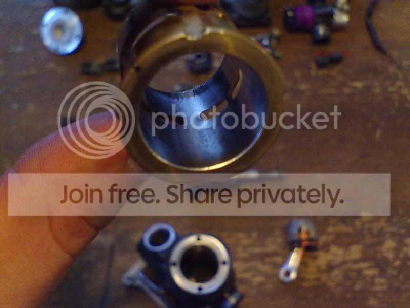

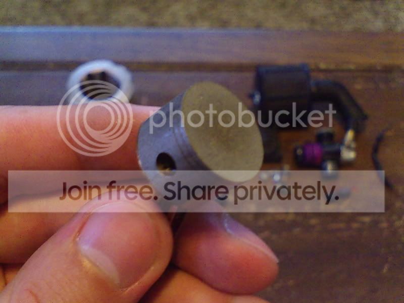

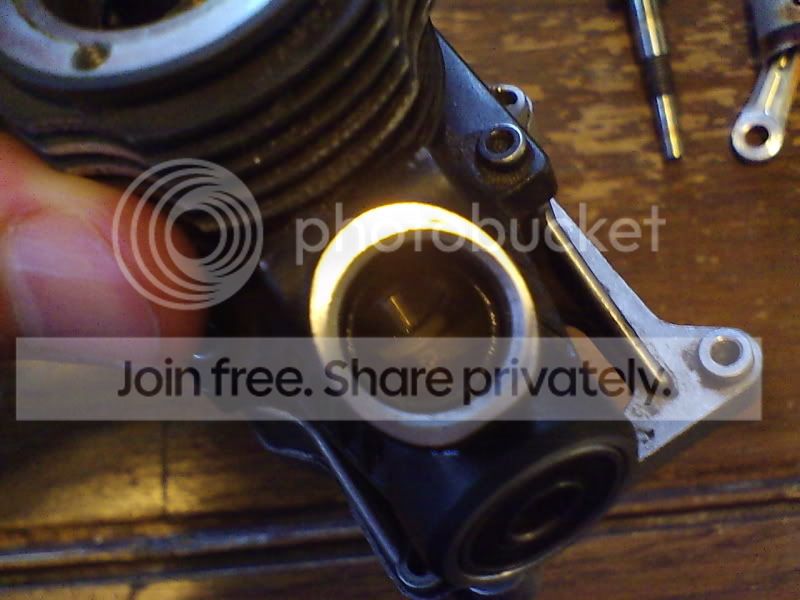

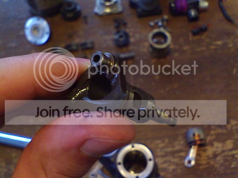

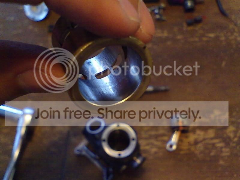

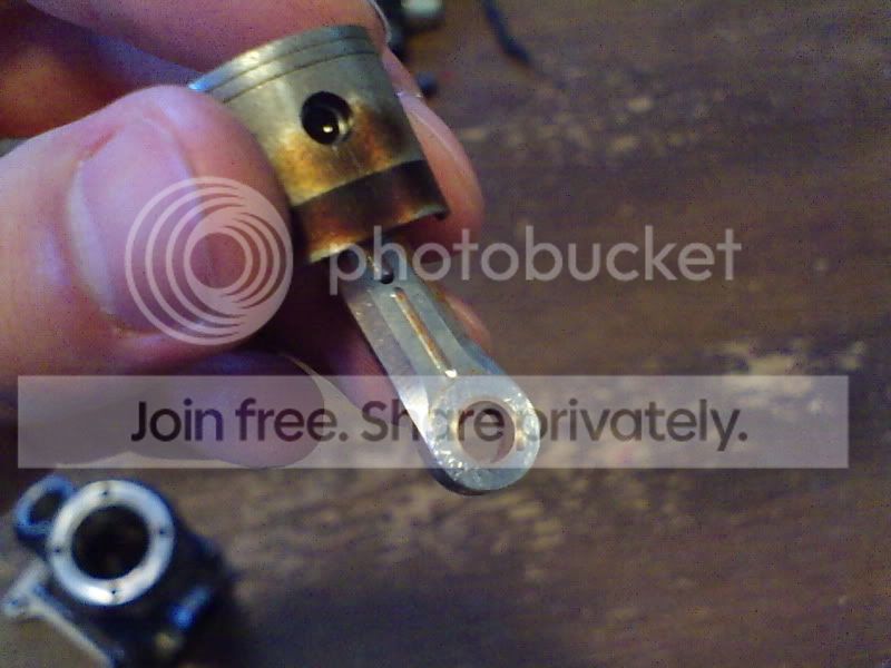

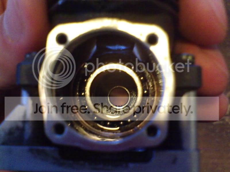

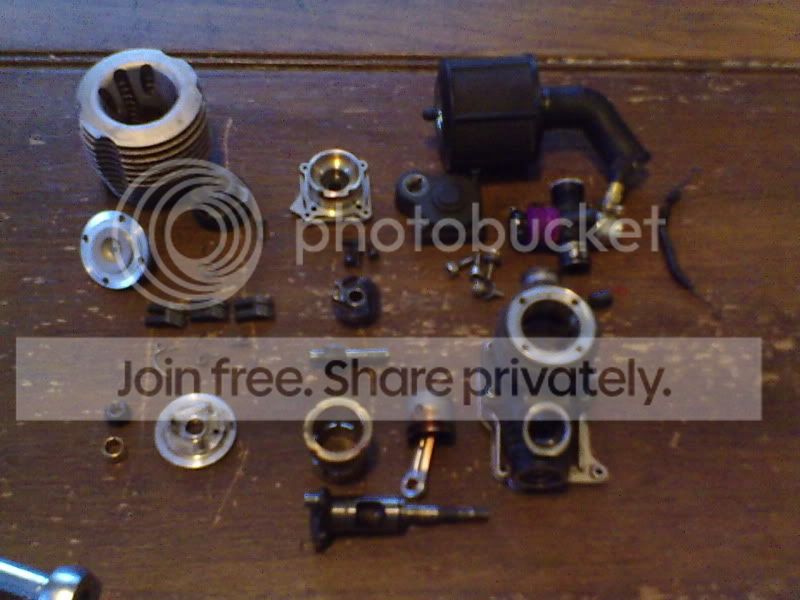

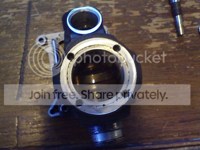

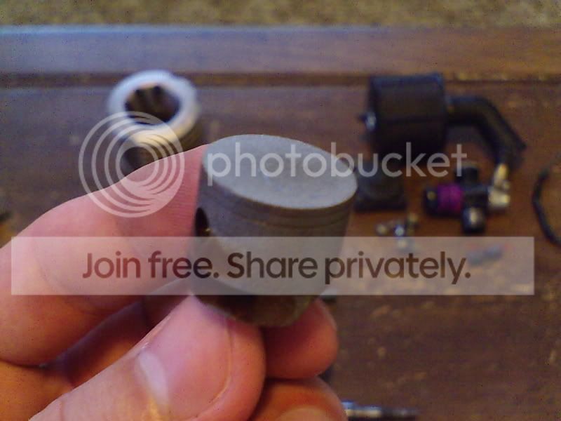

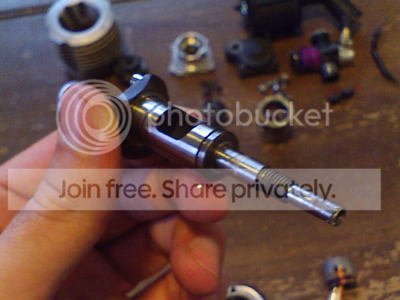

OK guys this is the first time I have completely taken the mill apart. I'm looking at the rear bearing and the balls are exposed and they move around inside the race. Is that normal or is the bearing shot? It still seems to spin smoothly. The front bearing seems like it's in good shape still. To me the piston and sleave still look good and in the one pic you can see where the OWB rubbed on the connecting rod when the pin sheared off. You guys know where I can get just the bearings for this mill? HPI just sells them with the new block it looks like. What do you guys think? Maybe new bearings and seal it up and see if I can't get it going again? The pics are not good but do you guys see anything there that's bad?
Gosh those pics look horrible LOL, not much else I can do though. The motor ran after I fixed the OWB but had a fuel leak around the carb. It wouldn't idle reliably, it would idle high sometimes and low others and it would not spool up quickly either. Tuning the needles didn't seem to get any results. I'm thinking it may have just been an air leak issue but I wanted to reinspect to make sure there were no metal shavings in the bearings and such. What do you guys think?
I see a few issues editing pics to show you. and yes that bearing is junk

I can see possible blow-by on the piston. But sure of 3 bad spots. Never seen a sleeve with carbon build up on it to signs of more blow by to me but IDK this is a first... the cage in the baring let go 4 sure but that is a known. The crank has damage on its end that will prematurely blow bell bearings. Con Rod looks junk too me to but that can be a illusion. I vote don't fix it ... Not worth it ..
I just went through trying to find bearings for a 5.9 before the world finals. A buddy had 2 5.9's have rear bearing failures. The retainer came apart....just like yours. I took the engine and put a new Boca ceramic hybrid bearing in the rear and used it in my dads puller at the WF's. You need a 14x25x6 mm bearing. I fixed this one because everything looked good. In my opinion your engine is questionable. It may be ok, but maybe not.
