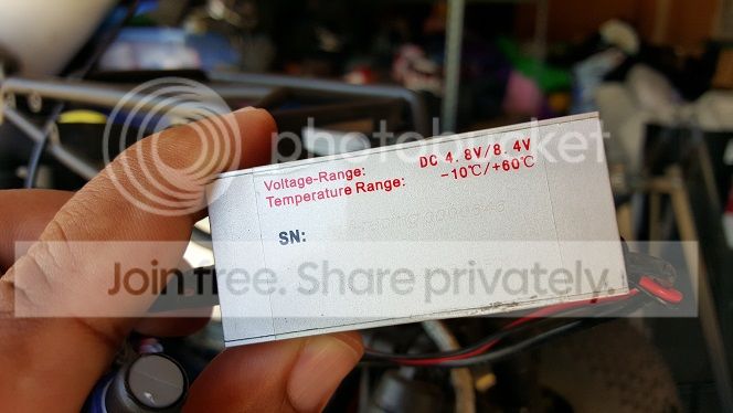

So, having suspected the CDI is not working properly, even though it passes the HPI CDI test with flying colors, I did some measurements with my oscilloscope, and they more or less confirms my suspicions. Below are two photos of it, one when measuring on the octane and one measuring on my lawn mower. The difference is huge and indicates that the octane CDi is very weak not giving much energy in the sparks. I have a new CDI on order, non-HPI, of course, as my local dealer refused to honor any warranty. If the car runs fine with the new CDI, and they still refuse to honor the warranty, then this was the first and last HPI product I will ever buy, that's for sure.
The CDI fixed my stalling issues. I was always confused because the ignition system always generated a spark but process of elimination made me change the CDI. Once I put the new CDI in the truck I noticed that it generated a spark about twice as bright as before. It almost seems like the other CDI was working on about half the voltage as the other one. I sent this in for warranty and they said the truck was working fine. It wasn't. Long story short they didn't honor the defective CDI for me and lied to me about it. I think I'm done with the Octane and most likely HPI. Don't want to be a downer here this whole thing has been a horrible experience.

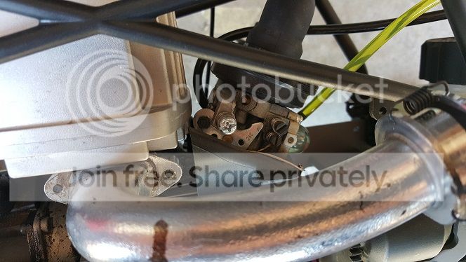

I got a new CDI today that I tested. It sure has a stronger spark, but to my surprise, the car shows exactly the same behaviour. I have double and tripple checked the CDI-sensor, and there doesn't seem to be any problems there. So, at this point, it seems I have to rule out electrical problems.
I guess the next step will be to tear the carburetor into bits and pieces and put it back together again. To make sure there are no issues with or "foreign objects" in it.
If anything, I would say the car is getting too much fuel.
I tried today to turn the low speed needle in half a turn, from stock setting, the engine started and ran at a high rpm, increasing rpm, for a few seconds, before it suddenly stopped.

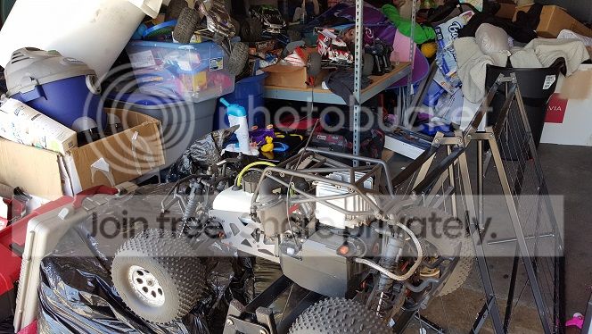

I want to document a bit here, where my truck started from factory settings on first tank till I had ten tanks. Initially, my hsn was at a straight vertical point (actually a full one turn and a "1/4" turn from close). I've read everywhere and seen on youtube its a one turn out, but mine was not like that and it ran rich with smoke but the break in went flawlessly so far as it was. Today, as the picture shows now I've only touched hsn leaning it out and its definitely has more speed/pop than before and after doing my transmission adjustments, still plenty of smoke but not as much as it was before. I've brushed off some sludge on the plug too and its getting reliable 4 pull starts.
I've ran out of time today to keep tuning but I'll post my cdi info., it does not say 2014 like I thought it would but my hobby store guys say, "Its definitely not a 2012 cdi, but an updated to 2014 cdi," no sticker to show for it is all.
My other rc toys crying to be played with.....
Again, everyone's engine is different, but maybe use mines as some reference as it's going strong.
