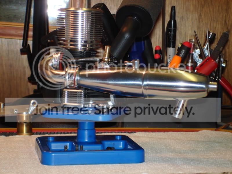

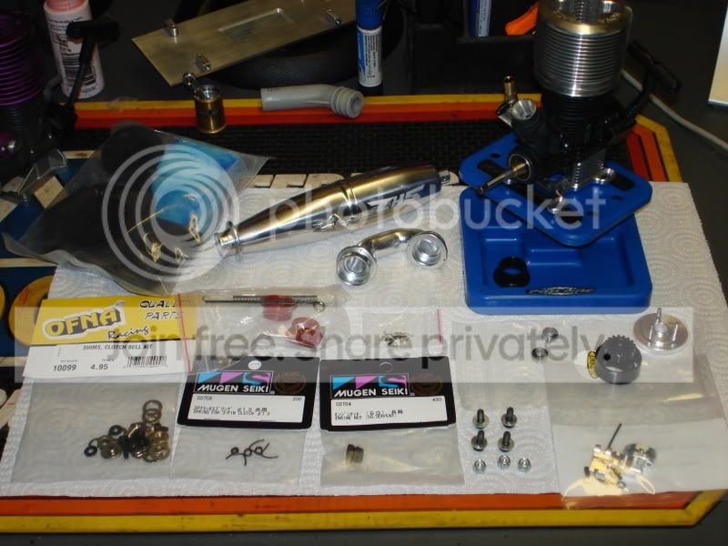

I finally upgraded the motor to an LRP, and also added Nova's cooling head, motor mount and clutch shoes, Mugen 1.0mm springs and nut, as well as a THS #8025 pipe, an HPI 17T CB, and related shims and bearings. Here's the goodies:

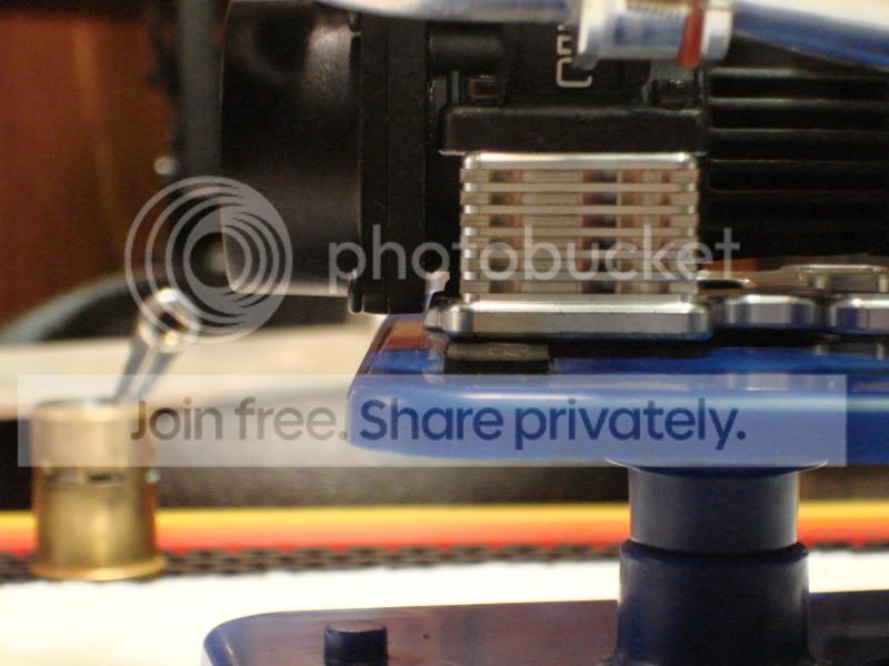

As beautiful and nicely-made as everything was, I still had to mod just a bit...The LRP's backplate is so large, I had to clearance the RR corner of the engine mount.

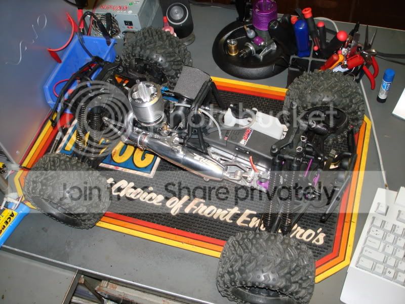

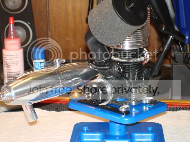

Here's everything ready to go...note the spring-coupler on the THS setup. That alone almost made the pipe worth it to me.

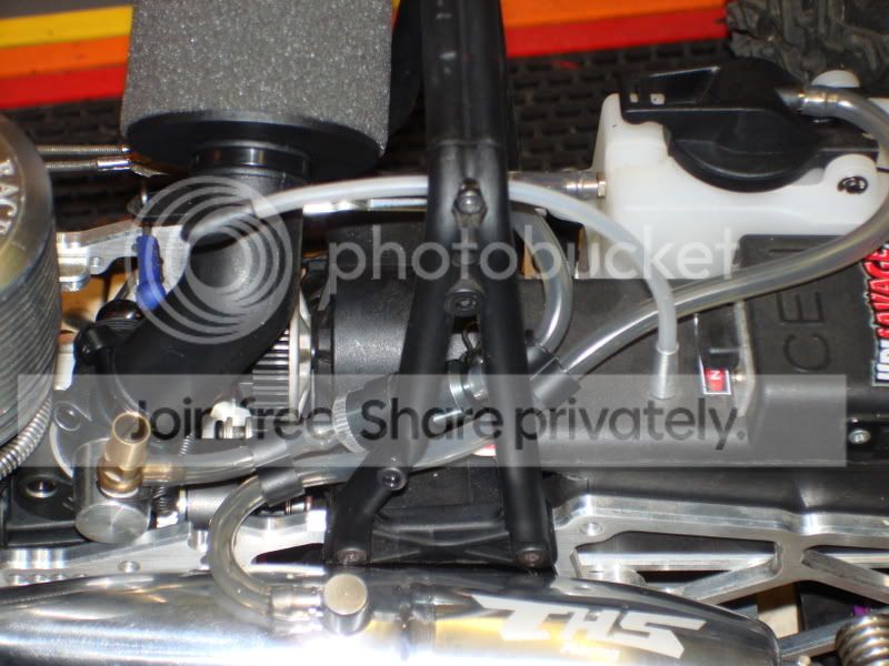

Everything bolted up easily, although the engine mount took a little more time than the stock one, due to the use of nuts and bolts. No biggie though.
While I was at it, I re-configured the fuel lines to shorten them and tidy them up a little more...

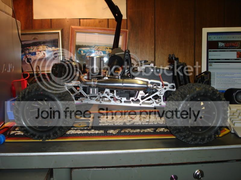

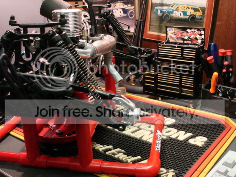

Just a couple of assembled pics to complete this stage...
So far, everything is fully operational, and I just finished breaking-in the motor. I'm ready to tune and have some more fun...There's more coming in the not-too distant future, and I'll update this yet some more!
looking super nice Greg. Liken all those parts. What else do you have in mind for it? You knwo a pic is worth a thous. words, so what's up with the piston and sleeve? Got me scratchin

The piston and sleeve? It's the old one from the F4.6 I just rebuilt for a spare. When I get bored enough, you know I'll have to bust out the Dremel and play!

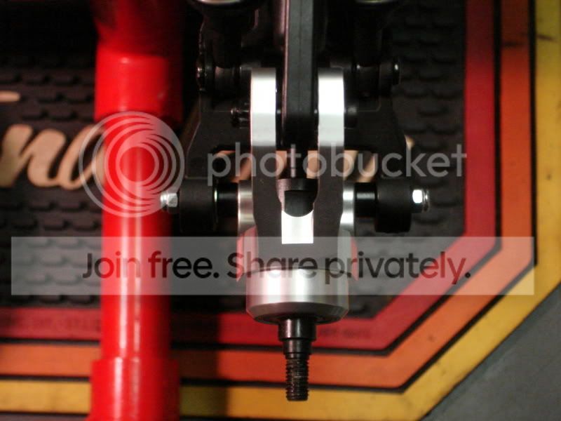

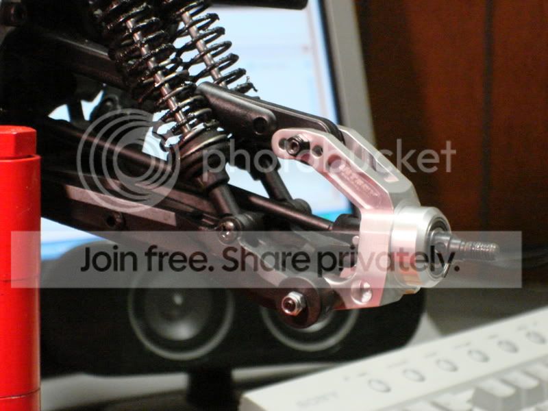

A few days ago, the mailman brought me my Integy rear hub carriers. They came with new lower hinge pins (threaded on both ends), spacers for said pins, and screws & nuts for the upper arms.
They look pretty solidly made (we'll see about that! :devil-smiley-007🙂, and they're light as well: Everything in the Integy parts weighed 2.1 oz., versus 4.8 oz. for the parts they replaced.

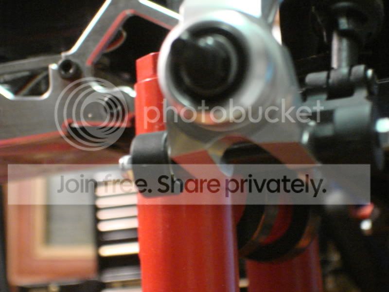

The only thing I didn't like was that there was some front-to-back slop on the lower hinge pins, like the spacers were alomost but not quite long enough. I took care of this with a shim inside each rear arm, towards the front:
Other than that, the carriers gave me no installation problems at all...the hingepin and the bearings fit nicely. I'll report back on how they stand up to bashing, but I have other stuff on the way that I'll put on before I take the truck out. Stay tuned...
