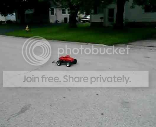

so I'm new to drag racing but it seems the rear tires are pushing around the fronts and spinning out.
Tried rear wheel drive only and got no traction.
Going to try useing the punch control to see if I can get some nice passes with out a wreck at the end.
found the issue, the Drag bar was dragging on the ground after take off.
It was acting like a tail rutter and spinning it out.
I changed the angle slightly to raise the drag bar wheels....
and set the punch control to get more traction less tire spin
testing 2 marrow

one thing I noticed is when you punched it, the front wheels raised up just a little and looked like they started to go "pizza cutter" on ya. Could be another symptom of your problem. But looks good crash, liking the custom wheelie bar setup.
Thanks Allan.
I did get the drag racing pretty well licked now. had to set the brake drag to about 30% AND that keeps it straight when I let off the gas.
