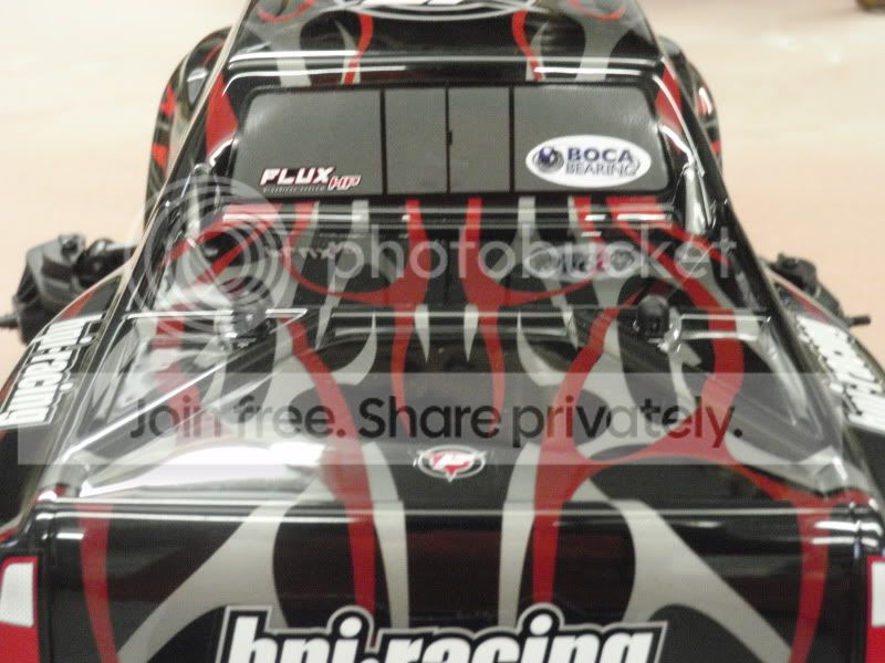

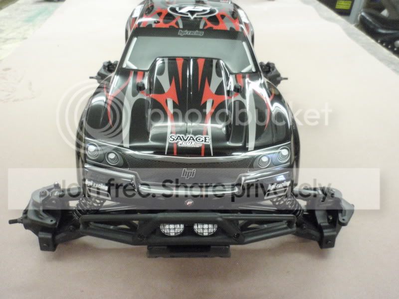

Yes, the rumors are true......
Thats awesome Crash! Hope to see vids and action pics soon.

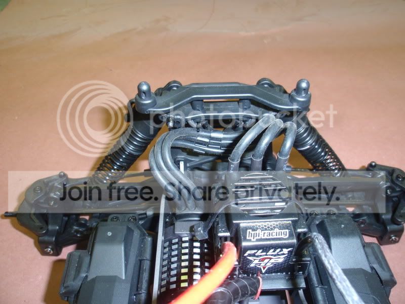

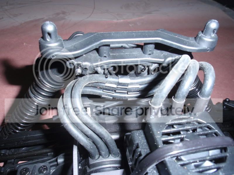

looks great Crash. where did you find those clips for the tork wires?
the dark side is pretty bright!
thanks bud
those are from my lhs
they are fuel tubing retainers....
