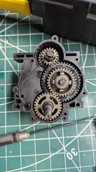

Show us pictures of your transmission. We have no idea at this stage what you're complaining about.
JEEEEEZE !!!! IT WONT SHIFT , I’ve been end to end on screw adjustments , does not shift never has , replaced the clutch, the shifter clutch works just fine but doesn’t shift still , I’ll be calling g hobby rec today , maybe just order another tranny , there cheap,,,,,,,, inside n out 😂😂

Nice though they are, these pictures don't help us any. Perhaps take pictures of the transmission in your actual Savage.
Like this:
Simple pawl system - there aren't many things that can be wrong. Something might be backwards.
Go through the assembly instructions for some clues and compare them with what you actually have before you.
The clutch holder cud b on backwards ? From factory or its new versions wi silent shift ? Take it off n press tension paw n c if it catches second wi the cluster actually in ya hand them clutch holders can b fitted backwards
