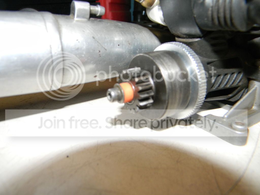

Hey guys sorry for the inactivity, still waiting on the clutch shoes. Since I've never actually had to take apart a clutch in my years of nitro rc experience, I thought would would a good idea to take the clutch shoes off and look around. Shoe and spring removal was extremely easy, just popped right off with a flat head screwdriver. I then looked at my flywheel and noticed it has three pegs and one of them was not staying in (it was popping out) I immideatley knew this was bad, so now begs the question: do I order a new flywheel or is there a way I can glue the peg back in? Here are some pictures
You can see from this one the right pin is out the one above is a picture of the pin from the flywheel
I tried jb welding one back in, but it didn't hold very long. I also tried using a prick punch around the hole to make the hole smaller at the surface at least, then drove the pin in, didn't hold up well either.
ok so back to what this thread was originally meant for. I decided to just skip the start/run video and went ahead and took the clutch bell off to examine the rest of the clutch components, here's what I found:
Looks to me like the top right clutch shoe has become lose or broke and started wearing against the clutch bell. Since it is out of position it was moving the others as well. So I think I just found my problem. I have new clutch shoes and springs on the way, but it looks like I may need a tool for the shoe springs.
