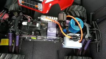

Hey guys, new to this forum and nitro in general. Just picked up my first nitro truck. Bought it off CL for $160. It's a Savage SS with an XTM 24.7 engine, 3spd transmission, HPI tuned pipe (no clue which one) Spektrum DX3-C radio system, and Proline Ford Bronco shell. This thing rips. It's in really nice shape and runs perfect. Having more fun with it than my electrics.
Opinions?

Attached a couple pics of my new to me toy.20140625_100850[1].jpg 20140625_100920[1].jpg
Welcome to the site! Why is the receiver on the outside of the electronics box?
As far as mods, different people like different things. For me though, the ribbed pipe is too loud and you lose performance a little due to no back pressure (the pipe you have). It looks like you have the stock servos and linkage. I'd upgrade to a pair of hitec HS0645MG servos, or something similar. Also look into the ofna linkage mod. We have a good write up here:

Do you still have a stock battery pack (4 AA batteries)? If so, look into a 6.3V hump pack. You will get more power to your servos and better run times. Make sure to tighten down your servo saver all the way, or you may get unresponsive steering (the nut under the spring).
The HPI wheelie bar is a must have for these trucks and is made well. Many more things can be done, but I think that is enough to get you going. Let us know how wild you want to go and we can point you in the right direction.

As far as the receiver box, those pics were taken after only owning the truck for 10 minutes. That's where it was when I bought it. I have since tucked it back into it's home nice and snug.
Special thanks for the steering tip. I have noticed when the truck is sitting still and idling that there is no steering. When you turn the wheel you can hear the steering servo kick and the wheels twitch but don't turn. When the truck is under throttle it will turn pretty snappy, but let off the throttle and it gets sluggish. Being new to nitro I thought it was just par for course...and considering it's using giant stock t-maxx chevrons I figured they are just heavy for the servos to turn. I will check that screw.
Yes, still has the stock 4 AA battery box. I did read about that in the 101 guide at the top of this forum. As far as the pipe goes, I'm good with the noise and it sound pretty sweet to me. Got the old lady next door to come out on her porch and shake her fist at me.

Tighten her down all the way. If you do that and upgrade your servo you should be able to turn bigger wheels/ tires than yours in any terrain while standing still. Mine does :)
