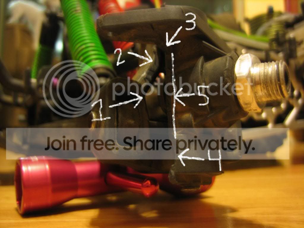

I have linked a picture below with numbers on it this pict shows where you need to trim to allow for more clearance. I have a note below describing what to look for.
1.Trim this edge off so the shaft (round cylinder on Hub) has clearance for maximum turn.
2. There is a little square bump stop here which must be removed so it is flush with the rest of the hub carier.
3. You must take the radius out of this piece(Hub) for clearance. (It doesn't need to be compleatly removed but the majority does)
4 & 5. You need to remove this edge some to allow clearance expecial where the #4 is.
Next step do this in all 4 locations on both sides of the Hub and to both sides of the truck.
You can see where you are if you turn the Hub pieces back and forth and make sure you have enought clearance every where.

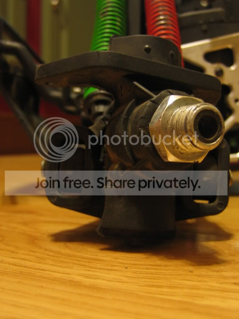

Just another pict of it.
Threw this process you could add a longer servo horn to your servo and adjust the end points on your steering servo if you have digital remote which will alow you to go to 125% of the servo stroke.
You may also need to do some trimming on the Steering bell crank for maximum turn radious. There are 2 spots on it which need to be trimmed. This is the part that link the tires togather.
Hope this information helps.
great info there!! especially if someone was building a racer and really would benefit from a tighter turning radius!! heres some reps for your effort!!!!
Thanks man. I did if for my basher as I put an extended chassis on it and wanted a tight turn radious back. Now i am building a racer which is the one pictured and though id do a write up since there was nothing on the forum on it.
ya i guess the ext chassis would cut down on your steering a bit wouldnt it? but i love the way the ext chassis looks!!
its not just for racers in did it last year on both my bashers. One is extended and the other is stock lenght. their is a huge difference even when on the throttle while turning. helps to line up them last min. jumps if you know what i mean. also helps to dodge the trees that before i hit and thought if i could have just turned alittle bit tighter. LOL Just my two cents
