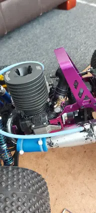

I've now got my beast out after fittingnew engine I'm bit scared to try it, lol, the arm is set when it's just sat with controller on ready to start, is this correct please?

no still too high of an idle. it should look more like this about a 1mm gap
also read up on how to break a new engine in. it's not hard just takes time.

there's multiple things you could change. could you send a pic of the whole linkage?
usually, I would start by taking off the servo horn, setting the servo to center, then putting the horn on so the carb is properly set.
also, make sure that it is the linkage and not your idle screw. to do that disconnect the linkage from the carb, then use the screw to set the carb at the proper gap like the pic I posted. then put the linkage back on and if it's off still mess with the linkage as I said.
oh, also I see your missing the throttle spring. it goes from the rod end ( black part attached to the carb) to the brass hi speed needle. that's very important as well to keep the carb closed

It's a brand new engine, instructions say to not touch needles at all, the carb moves if I adjust arm on it to throttle

the spring makes sure the carb closes when you go to idle. otherwise, the carb could get stuck open. very important.
correct, don't just the needles. the idle screw isn't the needle, it sets the gap on the carb when closed. that you might have to adjust
here's the checklist just to restate from first to last:
first, get a spring and install it
second, take linkage off from the carb and set the gap at 1mm using the idle screw (side of carb)
third, put linkage on and if the gap is still too big remove servo horn, set the servo to center, and put the horn back on so that it allows the carb to close

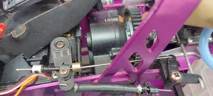

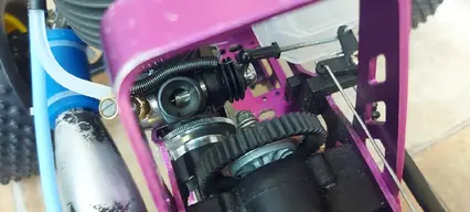

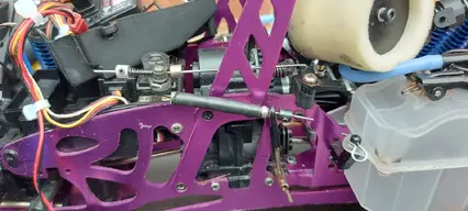

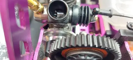

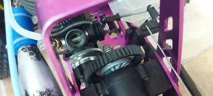

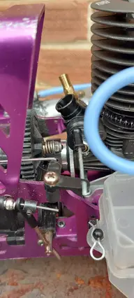

Sorry about loads of photos but I wanted you to see whole linkage, carb with throttle arm attached and not attached if that make any difference? I just want it going but obviously correctly how much the engine cost me lol.
