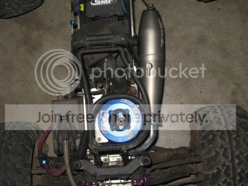

now that I'm looking at it the whole tranny case looks to be tilted. could i have received a bad set ot flm tvp's? or is the tranny supposed to sit like that. look at the top of spur sitting above the tvp's
OK its confirmed the motor plate is fubar. i still don't get how since i have hardly used the truck and its only been used on parking lots. most of it was tuning the ported motor.
ok part solved. i still may switch pipes since i don't like the fitment of the ths
still doesnt explain why the cap head screws on the motor mount don't clear since they didnt from the begining
Your tranny looks fine to me. I'm glad you found the plate to be bent. My guess is that the plate was bent before installation. I think I have heard of this before from there motor plate.
The THS should fit much better now. It is a great pipe actually probably one of the better pipes.
With the plate fixed and upon assembly you will see that everything should fit better. Keep us informed.

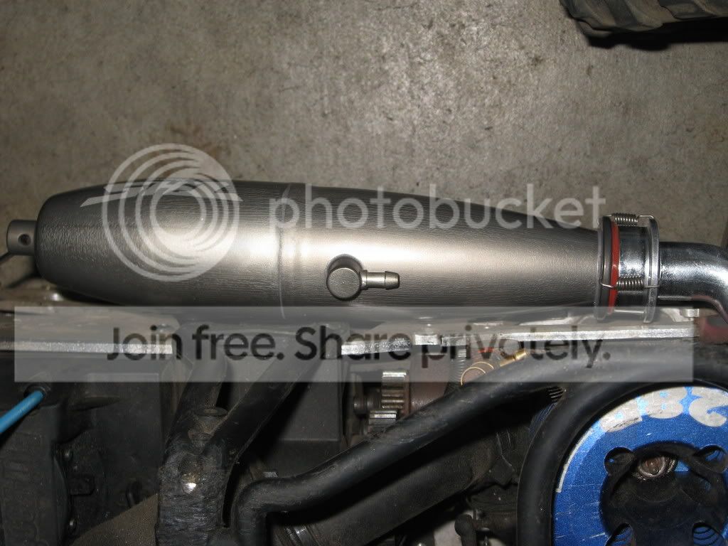

I just didnt realize that the header would cause a slight fitment issue even with it straight. i like the jammin header. ill figure it out once everything is straight. i already emailed flm
Stock motor plate on motor sits better. screews clear but cap screws with flm def wont clear i don't think.
Exhaust is better but not perfect.
:cornfused: Can you post a picture of your setup from the side? Just curious how it looks compared to mine, since we're using all the same parts.
Greg, I have the FLMs from your thread that SDMORRIS was running. They did not need to be shimmed.

It's kinda hard to tell but.. the pipe looks like it hits the roll bar .. IT DON"T it sits below it so it looks like it does .. I have like a 1/8 inch clearance
Throttle return spring was a little stretched out so i moved it to the tvp. so then i went to do this with the lrp and pipe and it wasnt staying but i fixed that.
I actually gave up on the ths pipe and started running it with the hpi polished to get some break in tanks through it. motor starts right up. sounds nasty. I'm still undecided on whether to use the ths pipe or get the jammin. unless i switch to 18/49 gearing to get the motor out a little more
Yeah i think I'm giving up on the ths pipe. I'm ready to throw this thing out the window. this is after the engine plate swap reset my mesh. everything straight
If you look closely at this pic it looks like the header points inward towards the tvp
Well it's the tvp's not the pipe
really it's the header
Run a jammin header your problems will be gone

Well I'm thinking with stock tvp's it might work ok but since the flm's are thicker its more of an issue.
Ill try them but it seems that there arre other users who had the same issue with the flm tvp's and this gearing/pipe setup.
You can probably find someone willing to swap headers with you. Theres a few guys running JP pipes and cant use their header with reg length tvps. It hits the back shock tower. With ext tvps, its no problem.
Pipe is going back. I'm not limiting my gearing options all for a pipe. ill most likely order the jammin jp4 instead
Thanks for everyones help. motor mount was bent in a couple spots! i have to contact flm and get a new one sent to me.
Once i started looking into it more i realized the gears would mesh but were angled. so my spur would have ended up wearing funny. i seem to always strip spur gears anyway! might have been my problem all along.
