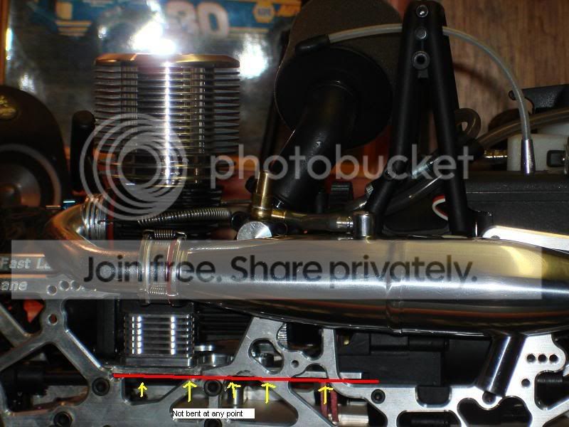

now that I'm looking at it the whole tranny case looks to be tilted. could i have received a bad set ot flm tvp's? or is the tranny supposed to sit like that. look at the top of spur sitting above the tvp's

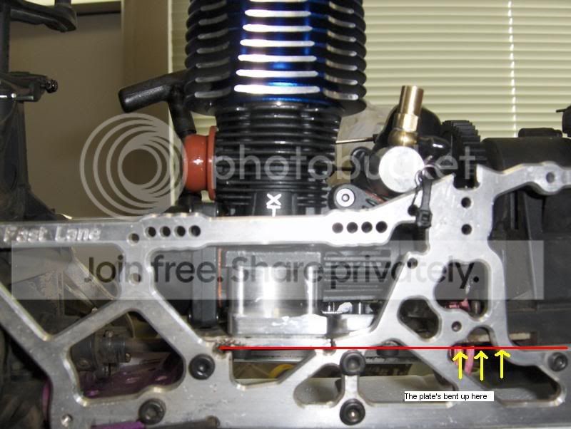

OK its confirmed the motor plate is fubar. i still don't get how since i have hardly used the truck and its only been used on parking lots. most of it was tuning the ported motor.

Your tranny looks fine to me. I'm glad you found the plate to be bent. My guess is that the plate was bent before installation. I think I have heard of this before from there motor plate.
The THS should fit much better now. It is a great pipe actually probably one of the better pipes.
With the plate fixed and upon assembly you will see that everything should fit better. Keep us informed.

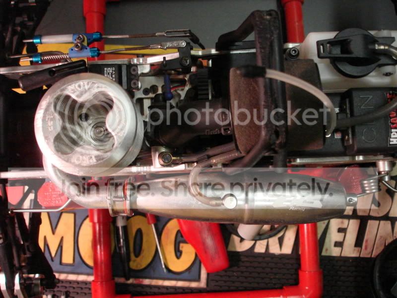

:cornfused: Can you post a picture of your setup from the side? Just curious how it looks compared to mine, since we're using all the same parts.
Greg, I have the FLMs from your thread that SDMORRIS was running. They did not need to be shimmed.

It's kinda hard to tell but.. the pipe looks like it hits the roll bar .. IT DON"T it sits below it so it looks like it does .. I have like a 1/8 inch clearance

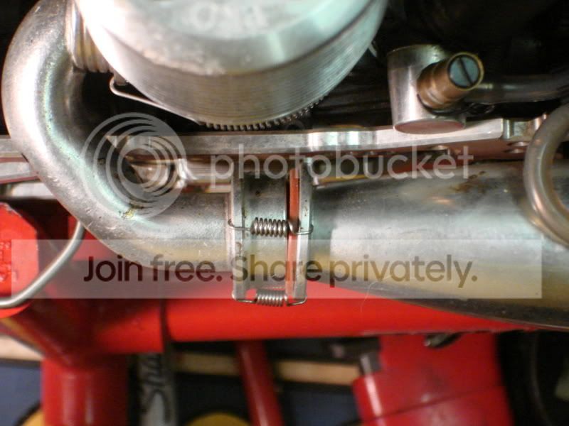

Whats up with the throttle return spring ? (sorry if you said in a different post )
Throttle return spring was a little stretched out so i moved it to the tvp. so then i went to do this with the lrp and pipe and it wasnt staying but i fixed that.

If you look closely at this pic it looks like the header points inward towards the tvp
Well it's the tvp's not the pipe
really it's the header

Thanks for everyones help. motor mount was bent in a couple spots! i have to contact flm and get a new one sent to me.
Once i started looking into it more i realized the gears would mesh but were angled. so my spur would have ended up wearing funny. i seem to always strip spur gears anyway! might have been my problem all along.
