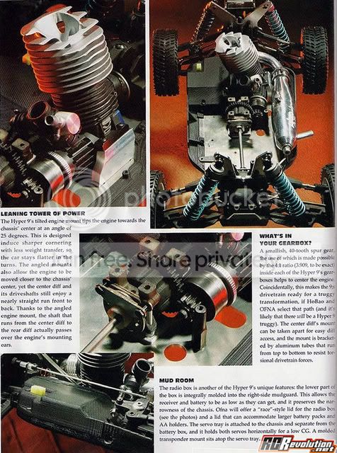

just a thought...I can think of a major RC manufacturer that runs their motors oriented in a manner other than perpendicular...
Think of the truck whose name should not be mentioned in here...their motors sit at an angle (not perpendicular, but not vertical)...I'm guessing that although it's not as extreme as the one we're discussing here, surely any ill-effects would have been considered before they began producing theirs...
I thought it looked a little slow. 2nd and even 3rd gear would have helped a lot with that I'm sure. I don't think the Hellfire is a 2 speed is it? Hmmmmm.
The Hellfire uses a center diff just like his build. You can control your power bias by changing your diff fluid visc. I like that he uses it because of the weight lose.
