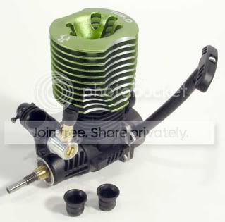

Hey guys,
I'm recently running the k4.6 HO & right from day one i didn't like the performance of the engine in my Savage X.
So i spent 2 hours roaming around Google & YouTube reading up on the Axial .28 spec 1s, if broken in properly that engine will be beast.
So i was wondering if i got this engine what would be the best break in method?
Axial .28 Spec 1s Specifications
• Size: .28cubic inch/4.6cc
• Maximum RPM: 36,000
• Bore: 18.6mm
• Stroke: 16.9mm
• Construction: ABC
• Heat-sink Head: Green Anodized Aluminum
• Carburetor: 8.5mm Composite Slide Carb
• Carburetor Adjustments: 3 Needle, Flush Settings
• Case: Black Aluminum, Rear Exhaust
• Connecting Rod: Dual Bushing
• Sleeve: 8 port
• Starting system: Pullstarter
• Recommended Glow Plug: Cold-5 Power Plug
So please leave some positive feed back please..

usually at the 1 gallon mark the front bearing starts to leak and here lately ive been hearing of the axial mills coming apart for odd reasons. if you want a mill that will be a beast get a picco or lrp imo and the k mill is the same as the axial just a little different timing on the crank.
The Axial .28 is a fine engine in opinon
I have had little to no issues with mine and they get a beating
I own 3 .28`s and 1 .32
The OWB's do seem to wear quickly
a remedy for this is preheating the mill before starting and a slipping OWB will grab.
IMO great mill for the money

Dan, question regarding the OWB. DO you use pullstarts or rotostarts?
pull...........
Hmm..just wondering because I have heard the rotos are harder on OWB but since you use pullstarts that wouldn't be the case. Maybe I have just been lucky with my Axials.
Yah i use the roto start for the break in and then the pull start.
I went through 4 pull starts breaking in the k4.6 HO !
