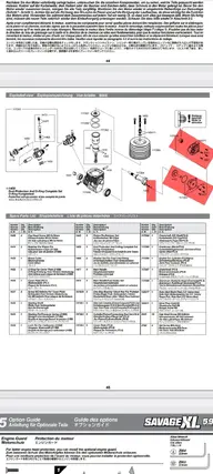

Having a hell of a time finding starter shaft #15234 for my older 5.9, discontinued part on hpi website and after reading form on this site found out its been a problem for a long time. I dug around on the new F5.9 engine and it shows a similar set up to an old 4.6 I used to run. My question is has anyone tried the conversion yet? It seems very possible to me it would work would if the sizing is the same, just have to buy all the parts I'm guessing. Got a pictures of the of owners manual, part numbers; #1433, #1432, #117263, #1072829 and might not need but also #120277.
Figured I'd see if anyone has successfully done it yet before I spend the money. Thanks in advance.1000003445.webp

Is starter shaft #15234 still avaliable in Europe? As I said before it's discontinued or at least, is in Canada. Did you make it by chance? I brought myn over to my local mechine shop, hoping they could make one for me. They said it's a hardened shaft that was ground and polished, wouldn't be able to make one properly, and didn't really want to take it on. Fair enough.
My thoughts on doing the F5.9 starter shaft swap were that there will be more part availability. Any HPI distributor should be able to get the parts no problem. I just don't know if it will work, but I also don't see why it wouldn't. They would be genuine HPI parts, completely bolt on, no mods one would think.
Swapping out or cleaning the one way bearing on that style is so much easier as well, almost worth it just for that reason, in my opinion.
